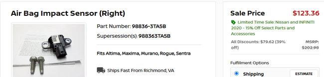

I took my car to the dealership to figure out what the issue was. They told me i needed to replace the passenger seat back airbag sensor. This part number 87600-3TA0H is what i was told needs replaced. That part number is the entire back of the seat that the dealer wants over $1,000.00 for.
Is there a different part number for just the sensor or not?

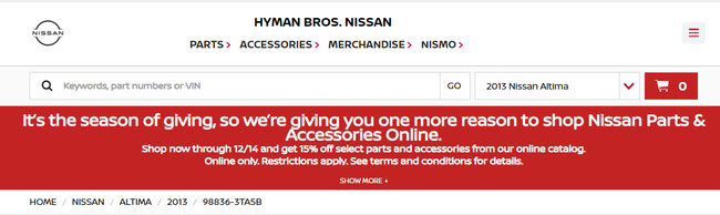

Yes, that is ridiculous to try to sell you the whole seat back and not just the sensor. The sensor itself runs about $124.00. I've attached a picture below for you. Hope this helps and thanks for using 2CarPros.
