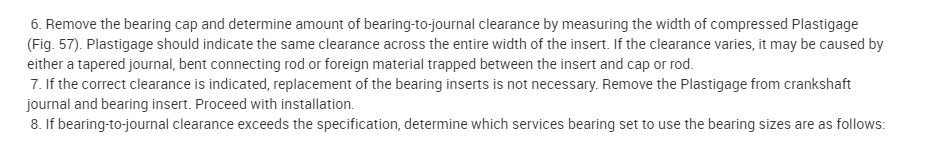

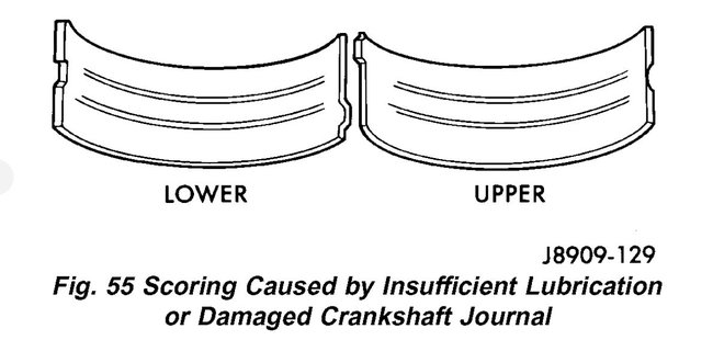

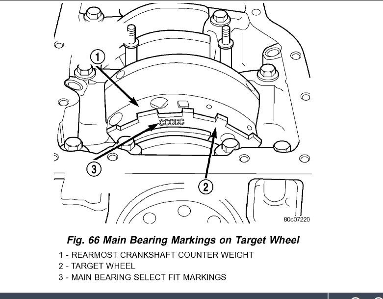

I have been losing of my oil pressure whenever I come to a complete stop. So I changed my oil pressure switch and that didn't help. Then I dropped my oil pan to clear my pick up tube which had old existing parts from me bad timing chain guide. So I cleared that out of the way put it back together, still had no pressure. When I drained my oil I had a copper sheen in my oil,I'm guessing from my bearings. But nothing magnetic in my oil at all. I do have a very slight new knocking sound on the bottom that I really haven't noticed before but it's not too bad at the moment. I want to change out my connecting rod bearings and my main crank bearings. What is the best way to decide on the size of bearings to go back with?
Mar 19, 2020 at 8:45 AM

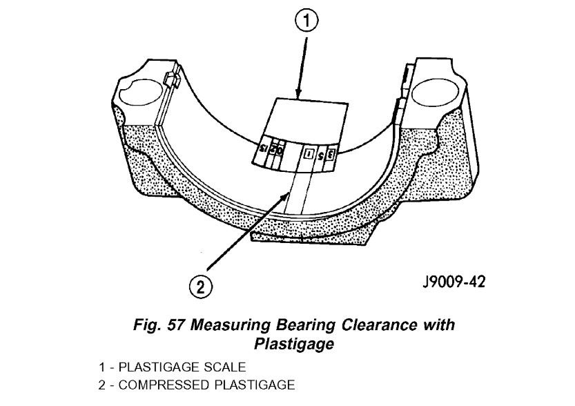

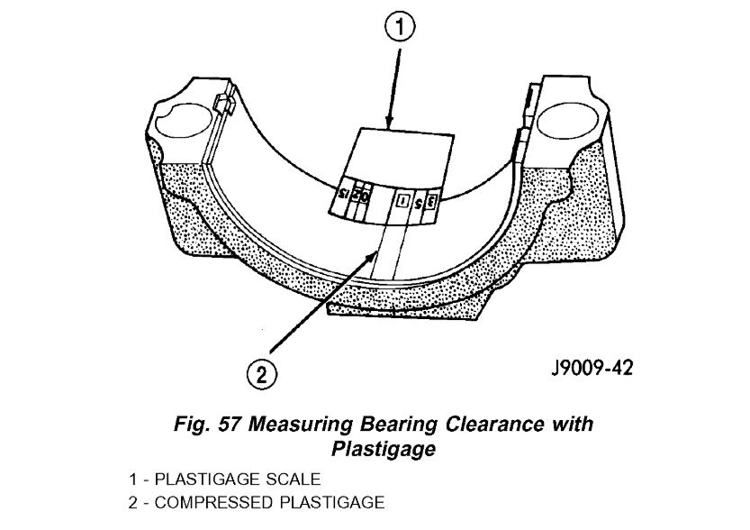

Good afternoon,
You will need the numbers off the back of the bearings for the correct ones.
Then when you are installing, you will need to plastic gauge each bearing for the proper clearance. You should have about .0015 clearance.
If there is any damage to the crank, the crankshaft will have to be replaced.

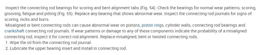

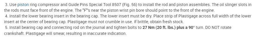

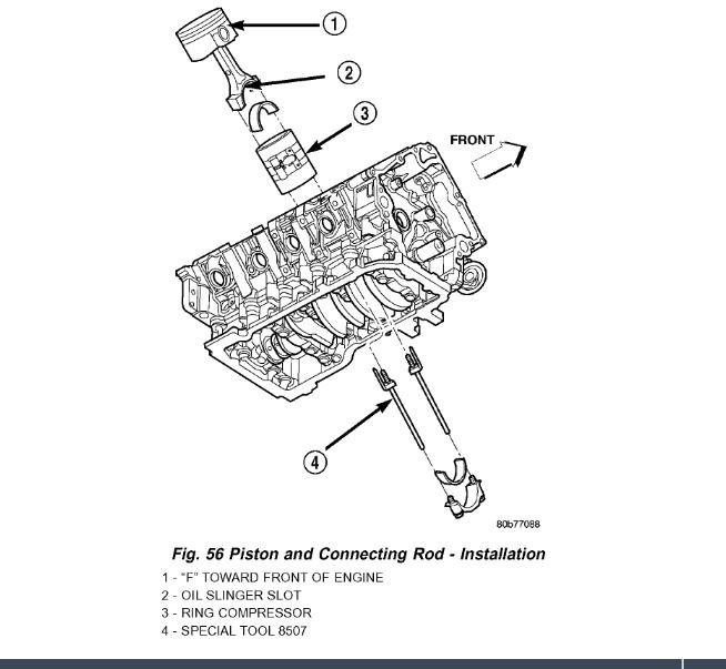

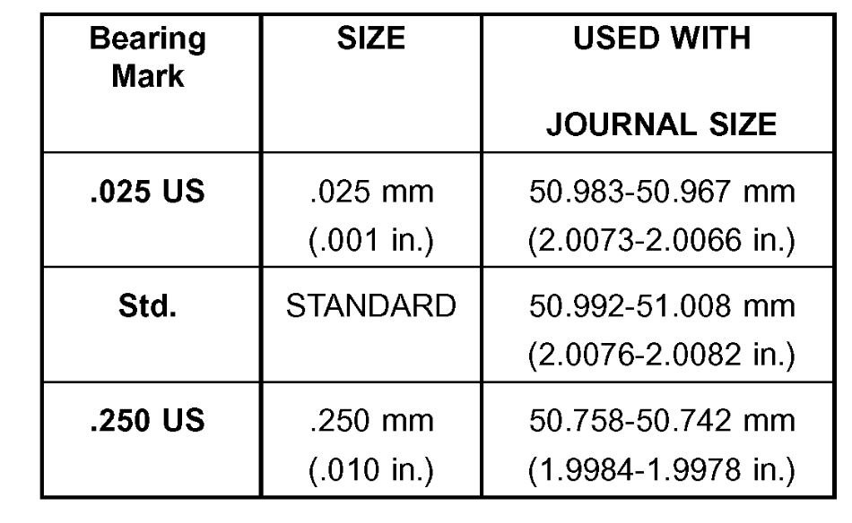

Okay, so I pulled it all apart and replaced the connecting rod bearings which were stamped std; so that's what I went back with. No damage to the crank. How do I find out what size these main bearings are?
Mar 30, 2020 at 1:37 PM

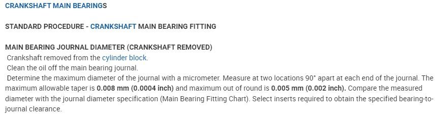

The same way bu looking on the back of the shells. They should be stamped std, -.010 and so on.
Did you plastic gauge the rod bearings to be sure of the clearance?
Mar 30, 2020 at 1:42 PM
JMANN979
  • 5 POSTS

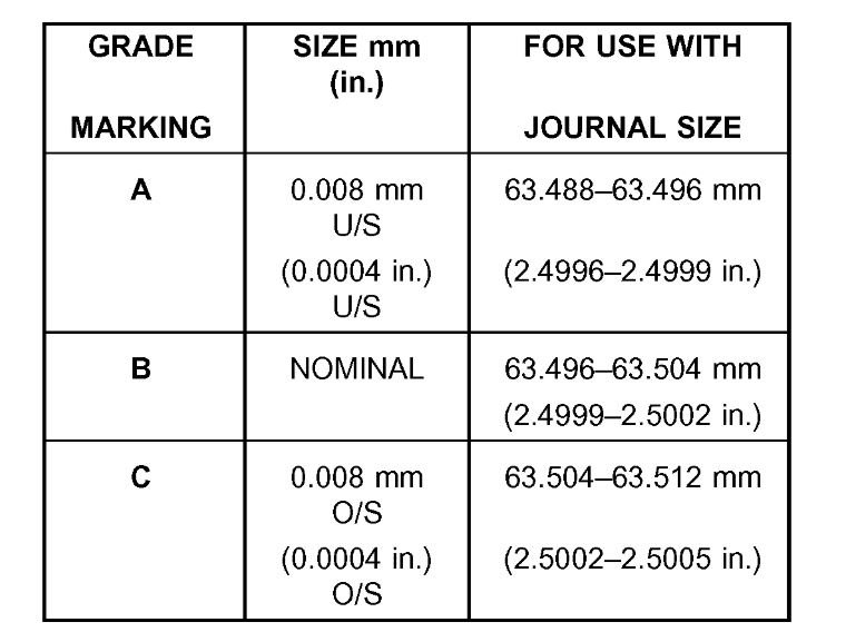

Yes the clearance was between. 025 and .038mm on the plastic gauge package . On the back of the old main bearing is stamped, A-500, 2 03 on one side of all the bearings and then on the other side of the bottom it's B596on all of them and the on the upper its C434. It would send an image but it wont let me.
Mar 30, 2020 at 1:51 PM
Okay, you will need to contact a parts store or even the dealer and have them decode those numbers.
Since there was nothing showing under or over, I would assume they are standard as well.
