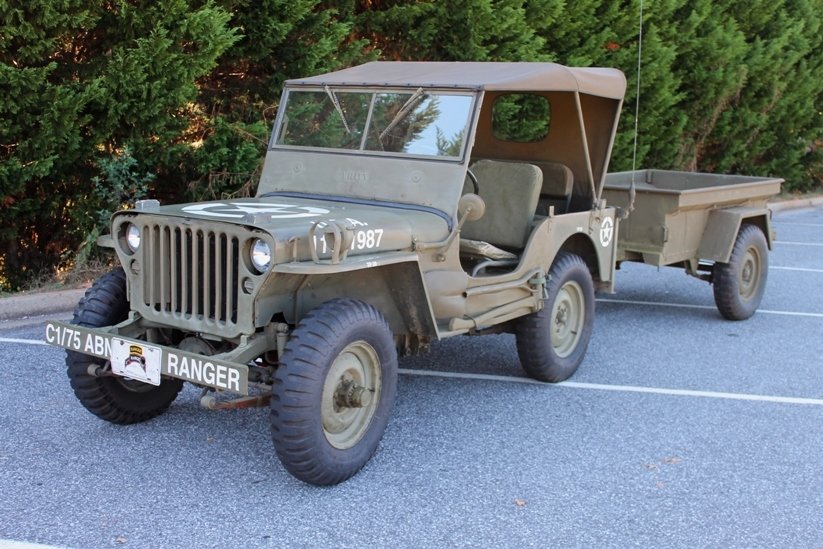

Nice Jeep you got there. Where did you dig that up? Looks pretty antique! Update: it is the ignition coil, I replaced the fuse and it starts right up. I swear I checked every fuse but I guess I am a bad looker. The clock and stereo still do not work and the interior lights will not turn on. The fuses for those are fine however so I do not know what the problem is there. I intend on getting a new bluetooth stereo anyways.

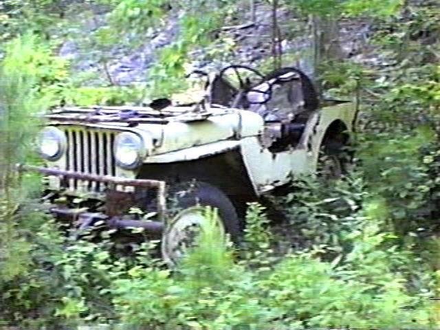

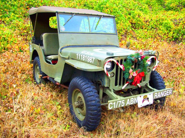

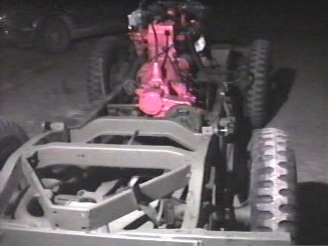

I have two Jeeps, the 1977 CJ-5 (Mr. Jeep) is my primary transportation. (had five others prior, never anything else since I was allowed on the asphalt).
The 1946 Willys (Willy) is my baby, I drive him every chance I get.
I made one car payment for each one back in 1991. Mr. Jeep was $2,200.00 and I gave $100.00 for Willy's heart and soul, Two years and many side jobs later (play money) he was on the road too!
Posting a picture of the day he was rescued. The first picture actually looks decent (In reality this was the bait that lured me in). The body was held together with splatter welds and a fifty five gallon drum of bondo. It had to go, I pretty much started from scratch to revive him.
