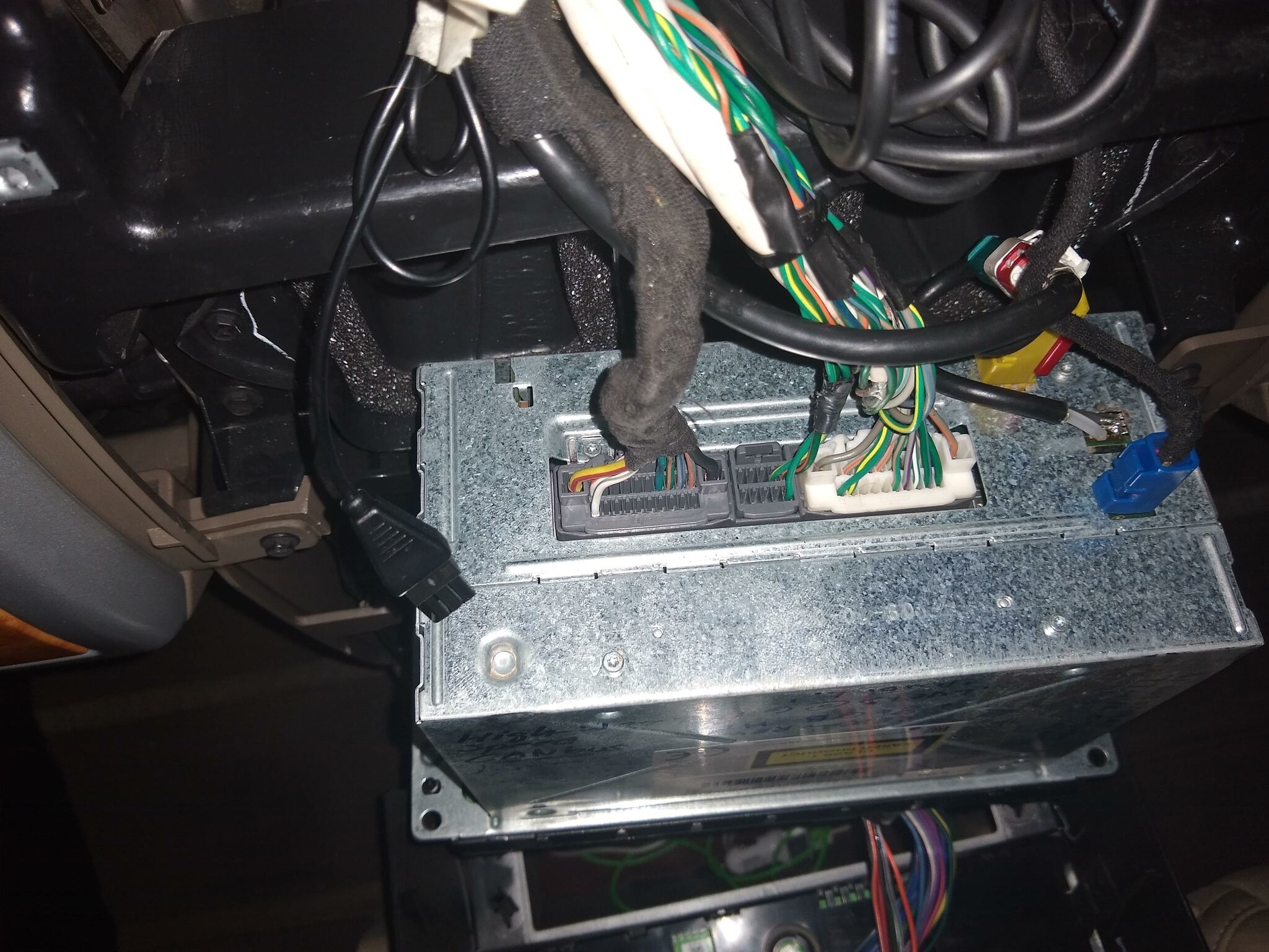

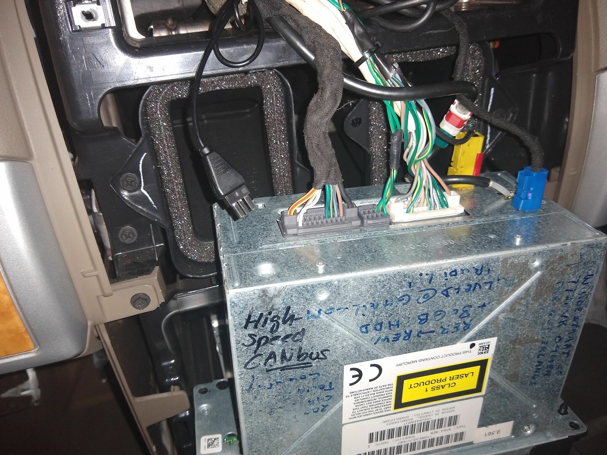

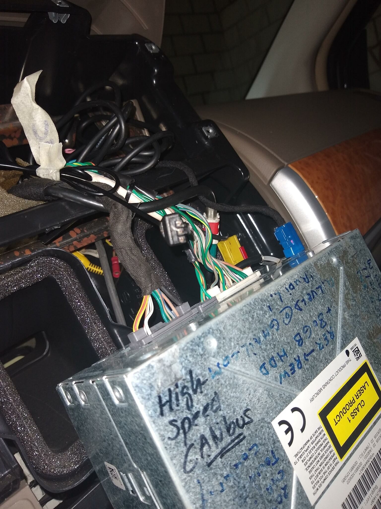

I have a MyGig NAV system with Bluetooth phone connection. This was retrofitted since the car originally came without this unit. The car does not have an original microphone. Hence I cannot use the phone. I can hear the caller perfectly. But they cannot hear me.
I bought part Microphone #68002646AA. However, the plug does not fit in the MyGig.
Would you suggest an adapter or other way to connect the microphone to the MyGig. Pictures of the MyGig and the mic are attached.

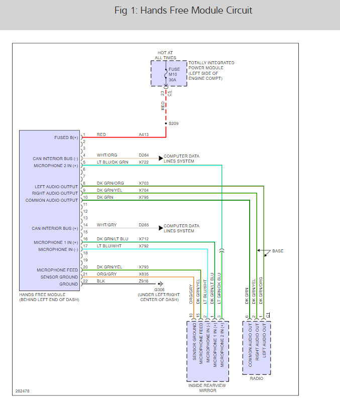

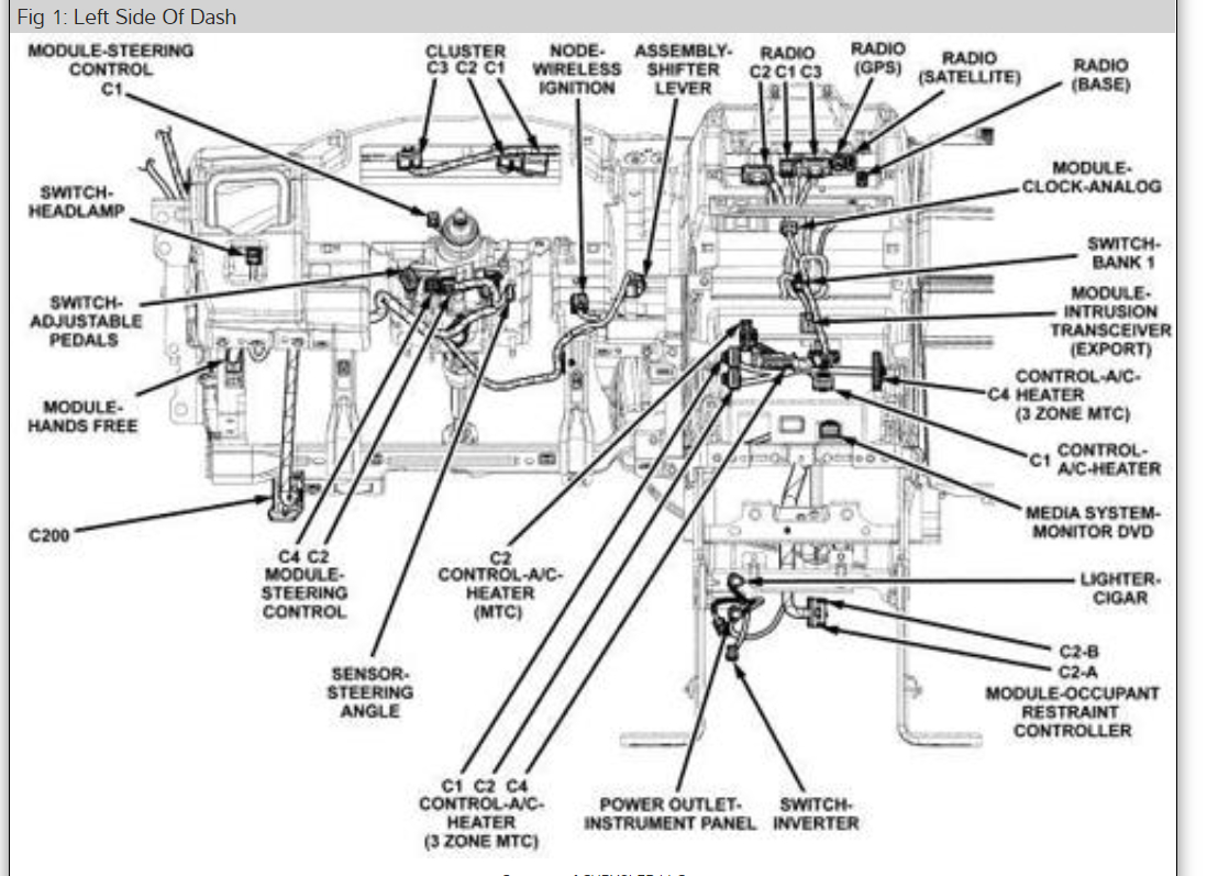

I did some research and it looks like you have to have the hands free module with the microphone in the rear view mirror. Could not find anything on an adapter. Here is the microphone wiring diagrams and the module location. Check out the diagrams (below). Please let us know what happens.
