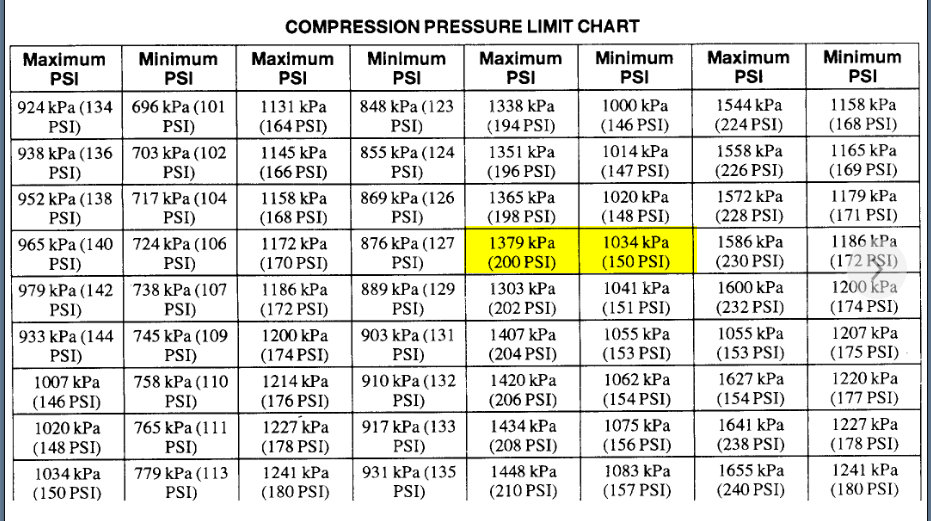

These are my numbers from a compression test. Full battery, throttle body wide open, 10 second cranks.
Dry
1 200 5 195
2 180. 6 200
3 195. 7 200
4 195. 8 200
Wet
1 220. 5 220
2 220. 6 230
3 220. 7 220
4 225. 8 225
What do these numbers say about this engine? Thanks
Saturday, February 22nd, 2020 AT 1:49 PM
18 Replies
Tells me there is nothing wrong with the ability to seal and create compression. Basically Ford says you need your lowest compression reading to be within 75% of the highest cylinder. You are well within that.

So if the rings were worn or damaged the reading would have been significantly lower, say 80 or below? Thanks
Saturday, February 22nd, 2020 AT 5:03 PM
Correct. If the compression ring were worn which is the top ring on the piston. This is the ring that contains the compression in the chamber. So if this were an issue the compression would be lower.

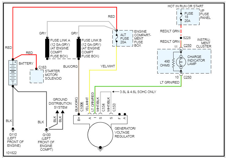

Do you have access to a wiring diagram for the charging system? My alt fuse keeps blowing under the hood, I have a new battery and alternator. What wires would have to short in order for this fuse to blow? Thanks again
Monday, March 2nd, 2020 AT 11:46 AM
We need to start a new thread for this topic because others will not find it under this header.
However, I supplied the diagram below.
Let's get a new post started with this one and we will get it figured out. Thanks
