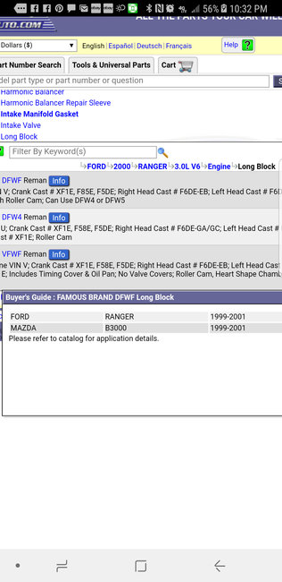

My truck has a seized engine after blowing a head gasket, so I am looking to do an engine swap. My problem is figuring out what I can swap in without needing modifications. I know that it is a Vulcan V6 3.0 Flex Fuel which was used in a lot of vehicles ranging from a 1986 Ford Aerostar to the 2008 Ford Ranger.
List here: https://en.wikipedia.org/wiki/Ford_Vulcan_engine
My thought is that any of these engines should be a compatible swap, but I am worried there might be differences in mounting, belt routing, hose configuration etc. because the engine went through a fair number of minor upgrades within the same model. Any insight you can offer would be greatly appreciated.

What is the eighth digit of your VIN number?

Eighth digit is a V.

This is what I see for vehicles that work.

As Saturntech9 shows, it is not just that the engine is the same family that was used in other vehicles. As you surmised there are multiple differences in the engines. Some are minor, maybe a dipstick was moved from side to side, others can be an instant problem. Like they changed the control system used and the replacement engine cannot talk to the rest of the truck.
Looking at Hollander it looks like Late production (after 9/99) 1999 and 2000 Vin V engines from Rangers and B3000s are drop in units.

I am going by Rock autos catalog they have a awesome fitment catalog. That is what issues to help answer questions on this site.

I have Hollander interchange data as well. It shows a long block as the same from 1999-2001, but the complete engine uses different numbers due to the flex fuel option.

Yeah, it is a long block listing from rock auto all the bolt on stuff is easily swap able from the old engine.

Any idea if a non Flex-fuel engine would work for a swap? I ask because I've found one at about 30-40% under what seems to be the going rate, but it seems that it's the "Standard model" instead of the flex fuel.

The flex fuel system is totally different including the fuel pump, computer, wiring harness warning lights etc.
