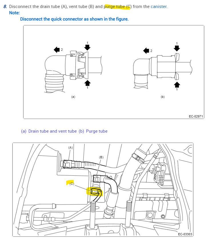

I'm guesing this is next: https://parts.subaru.com/p/Subaru_2016_Forester-25L-CVT-Touring/Emission-Check-Valve-Evaporative-Emissions-System-Leak-Detection/49250227/42084FJ000.html
I think its in the back behind the wheel.

I want you to take off the hose from the Purge valve that is coming from under the vehicle, not the one to the intake manifold, but the other hose and if you can get the hose low enough to see if any liquid gas comes out of it. Just to see if the Canister is full of gasoline. The canister is difficult to get to, so if you can see if the Purge valve is pulling liquid gas instead of just vapor, then we'll know the canister has failed. But we don't want to have you replace parts that we're not sure are bad, the canister unit alone is very expensive.
If you can even get to the Canister, it is above the rear differential, you can see that the tube marked C goes to the Purge valve in the engine compartment, If you reach it and check for any gasoline coming out of the Canister from that point, then we know what is happening. Depending also if you're getting a lean code (P0171) or rich code (P2097).

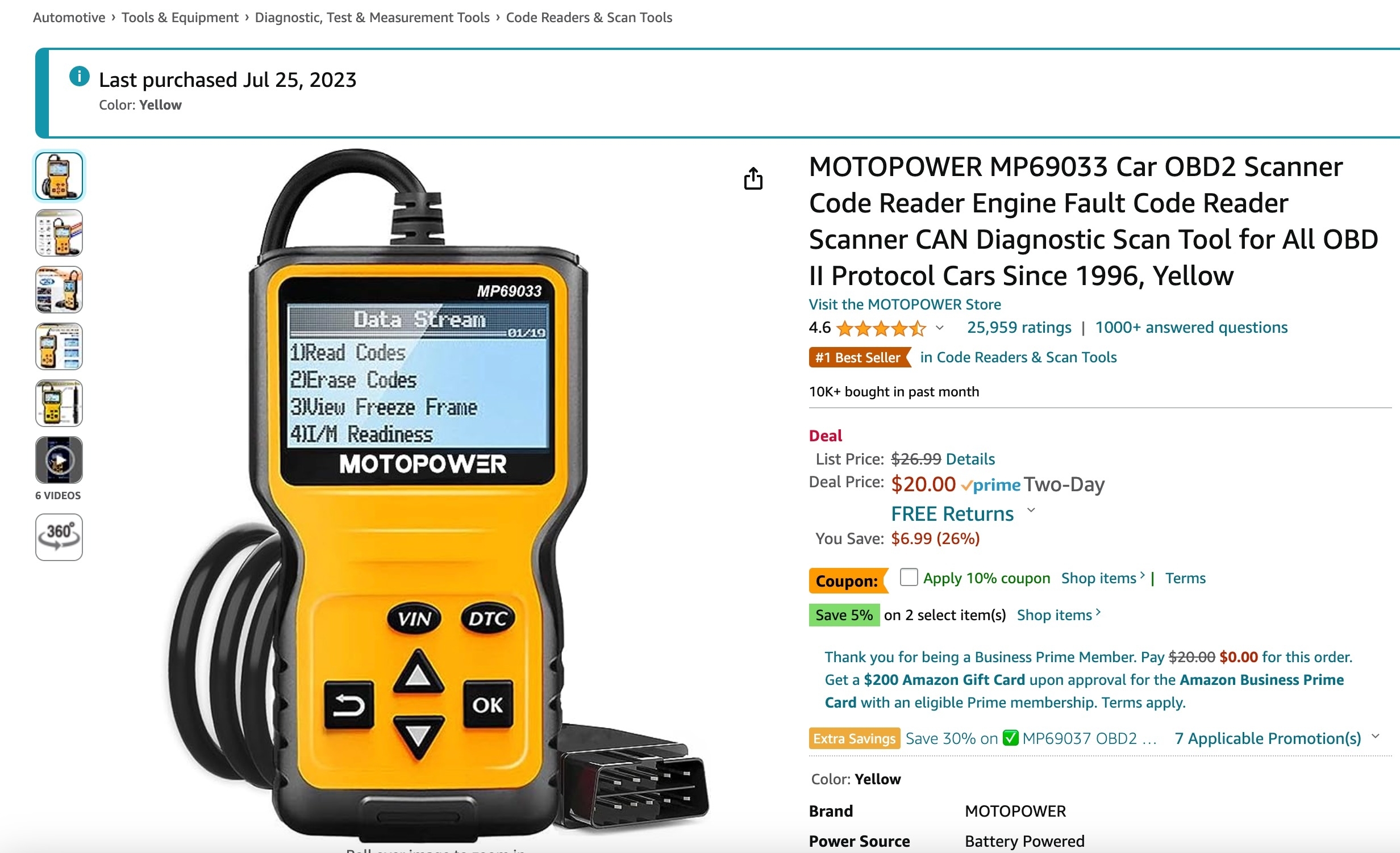

Below is a screenshot of the scanner that I'm using. I am just getting that one code. When all this first happened, I got the rich code, but I have not received it since I reset it the first time. I do not have the old part, but if I need to go buy a new one to try it, I can. I'm heading to a wedding tomorrow, but when I get back, I will see if I can get any gas out of the line.
Since I reset it yesterday, it'll probably be a couple of days before I get the code again. The next time the code comes up, I can go to AutoZone and see if they get the same code to check and see if perhaps it is the scanner.

Oh, okay. So, you're only getting the P0171 lean exhaust code now? Yeah, see if you get any gas out of the hose, it looked like you had bought an OEM Subaru part, I don't think it was an aftermarket part. If there were more issues back at the evap canister I'd expect more codes that would be stored in the engine computer so you should be able to see them with a basic OBD2 scanner like that, but if you have time later tomorrow, run to AutoZone and see if they can do a full vehicle scan of all modules and see what codes might be stored in other modules. Write everything down, and we'll go from there.
