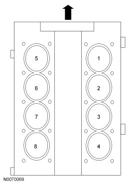

Thanks for your answer. How can locate coil 8 for v8 ford 4.6L?
Sunday, July 3rd, 2016 AT 3:46 PM
SATURNTECH9
  • 30,869 POSTS
The arrow means the front of the engine.
