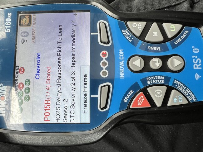

KEVIN CONSTAANTINE
Drive Cycle-3 image from scan tool. ECM deleted code P2270.

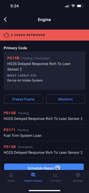

KEVIN CONSTAANTINE
Image from drive cycle-3.

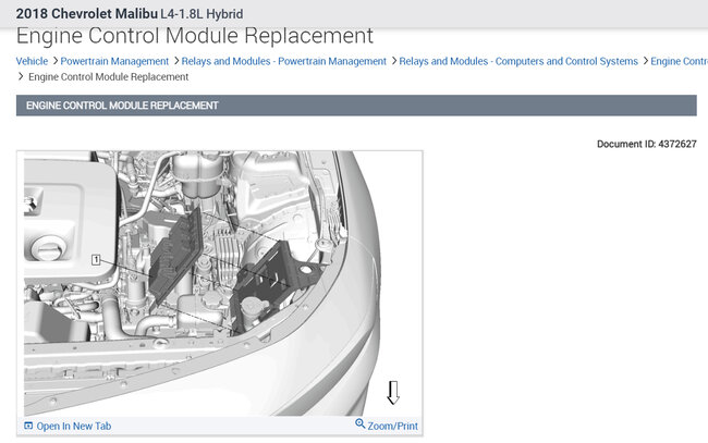

The P015B code oxygen sensor circuit for bank 1 sensor 1
P0171 code lean air-fuel mixture on bank 1
P2270 code indicates an issue with the oxygen sensor circuit for bank 1 sensor 2.

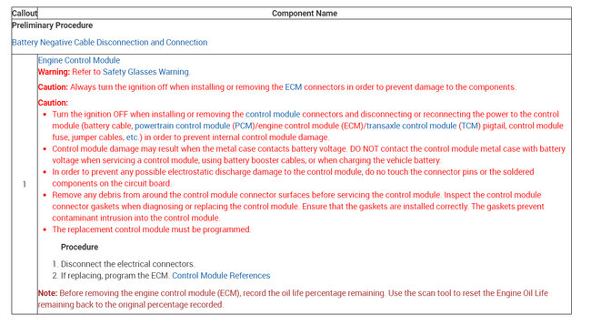

The first thing I would do is inspect the car for rodent damage of the wiring to the PCM. If the wiring is intact, I would say the PCM has gone bad. Here is the location of the PCM and you can get a preprogrammed unit by searching Google or Ebay. Check out the images (below). Please let us know what you find.
Mar 29, 2023 at 11:20 AM
