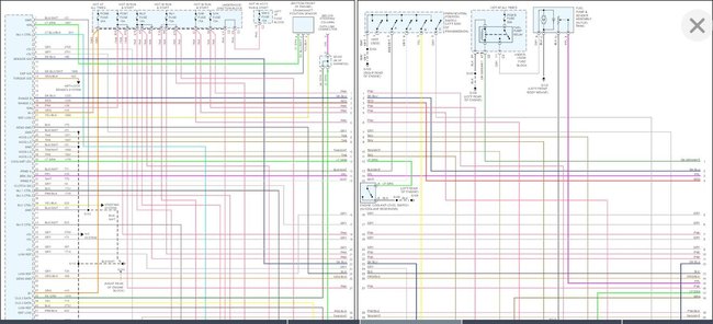

5 volt reference #2 circuit short to ground. 5 volt reference circuit FTP shorted to voltage. Symptoms, not getting fire to plugs, intermittently, A/C compressor not getting power. I need a pin out of PCM, a wiring diagram of ignition system, fuel system and A/C system. Fuel pump has been replaced, injectors have been replaced, timing chain replaced. Also new distributor and module. Any suggestions on where to start first? I don’t have a bidirectional scanner or a decent manual.
And when I do find a diagram the font is so small it is hard to read (hard getting old).

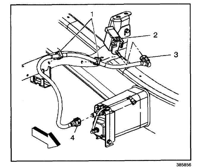

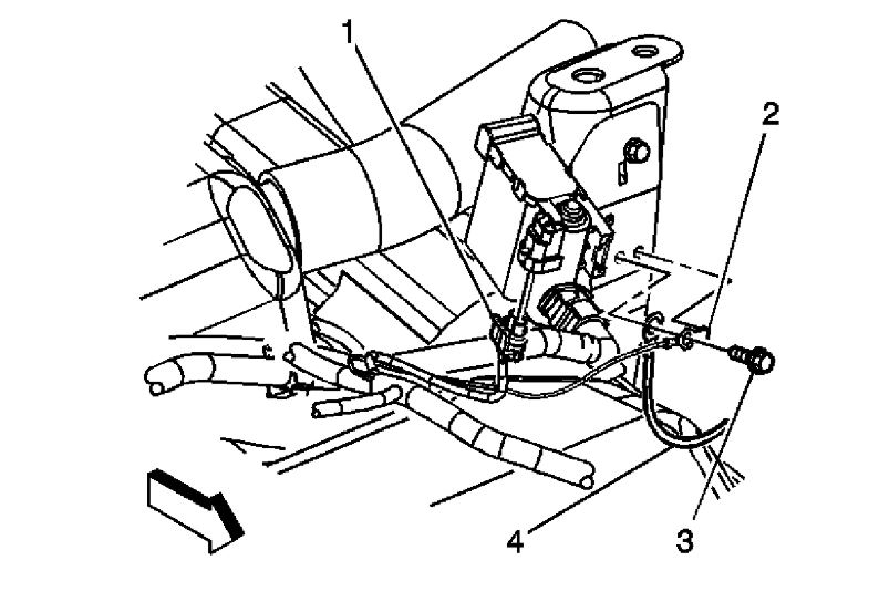

The 449 is a vent valve in the back of the truck. I posted pictures and a procedure.
P0651
Descriptor
Probable Causes
Air Conditioning (A/C) Pressure Sensor
Fuel Tank Pressure (FTP) Sensor
Powertrain Control Module (PCM)
P0449
Descriptor
Probable Causes
Evaporative Canister Vent Solenoid
REMOVAL PROCEDURE
1. Raise and suitably support the vehicle. Refer to Vehicle Lifting.
2. Disconnect the evaporative emission (EVAP) canister vent valve electrical connector (1).
ImageOpen In New TabZoom/Print
3. Remove the EVAP canister vent valve bracket bolt.
4. Remove the EVAP pipe from the clips (1).
5. Disconnect the EVAP vent pipe (4) from the EVAP canister.
6. Remove the EVAP canister vent valve and pipe from the vehicle.
7. If necessary, disconnect the EVAP vent pipe (3) from the EVAP canister vent valve (2).
8. If necessary, detach the EVAP canister vent valve (2) from the bracket.

At this point I have found the throttle position sensor wiring. Signal wire is shorted to 12 volts. What I need is pin out of PCM. This is my second attempt to reply not sure if it went through the first time.

Roy, my reading is correct this is problem: Circuit two is shorted out to positive 12 volts this is my problem., If you could please send me a pin out of the PCM I could ring out the wires and bypass where it is shorting out at. I know what to do I just need the pin out.

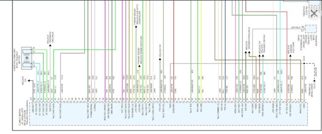

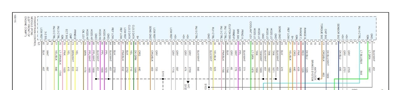

Here are the pin outs for the PCM.
Thursday, October 10th, 2019 AT 9:07 AM

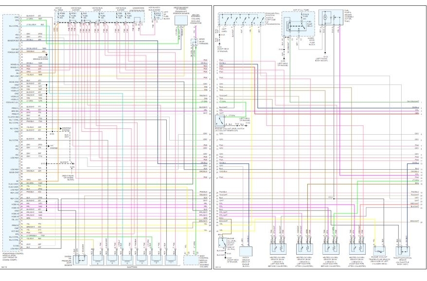

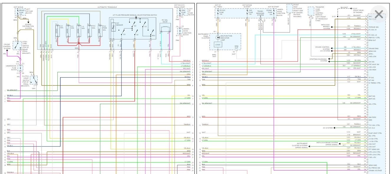

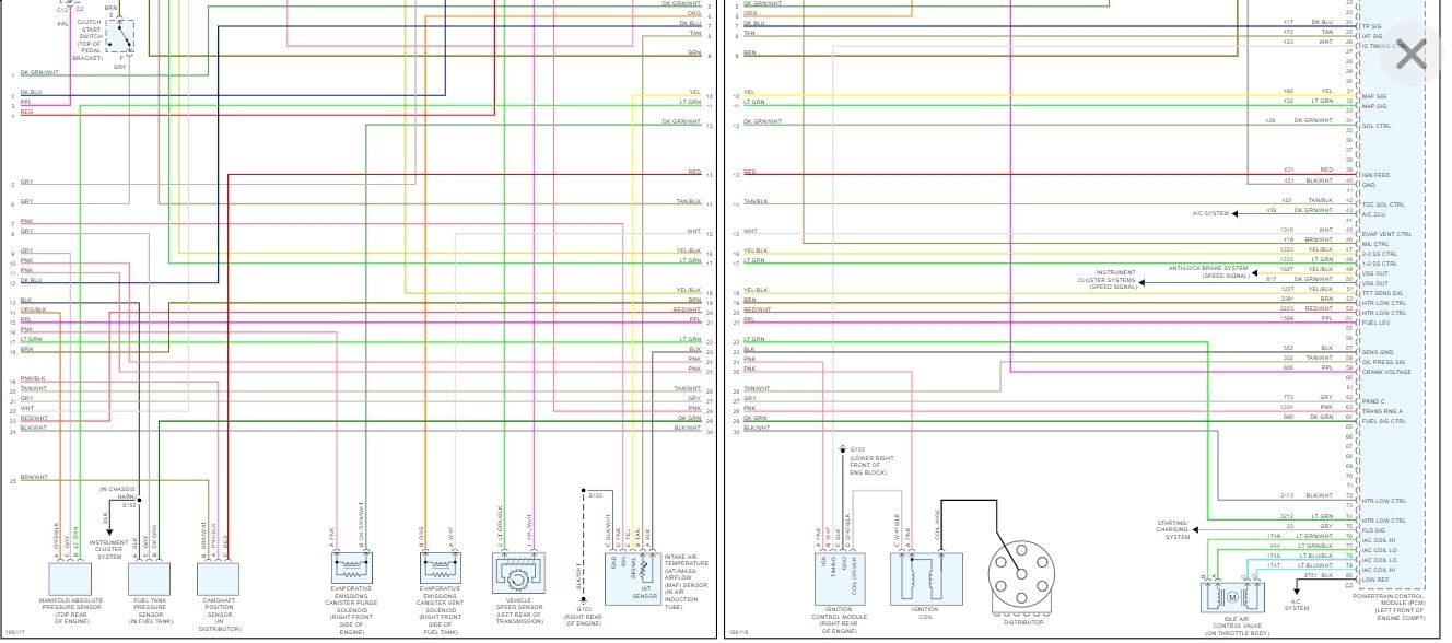

Thanks, now if you could send me the wiring diagram of the engine management system hopefully I’ll have enough to go on to bypass the wires to the necessary sensors according to info I pulled up trouble codes. Net circuit 2 is serving the following sensors, accelerator petal sensor #1, throttle position sensor #1 and 2 and crank sensor. Could you please take a look at the engine diagram to see if this would give me the diagrams I need to follow through from these sensors to
PCM. Thanks for all your help.
Thursday, October 10th, 2019 AT 11:04 AM
Wiring diagram attached.
+2
Saturday, October 12th, 2019 AT 12:29 AM

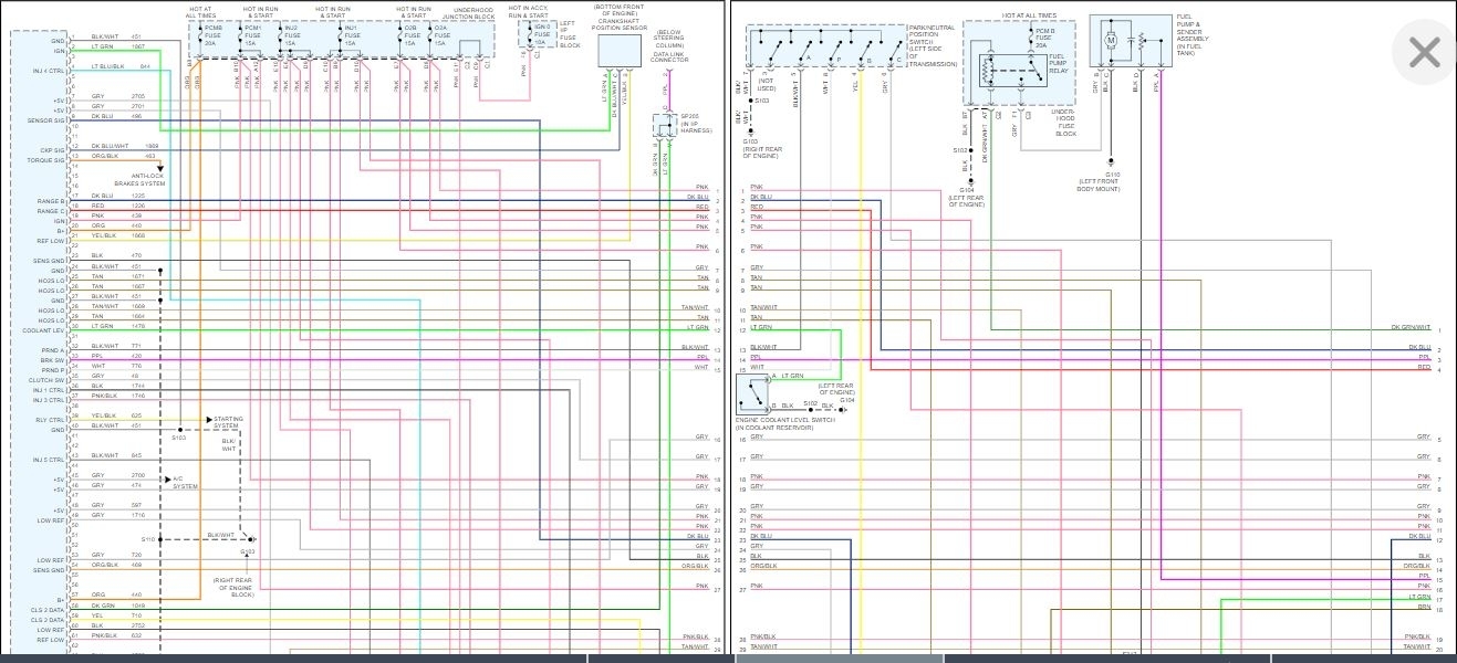

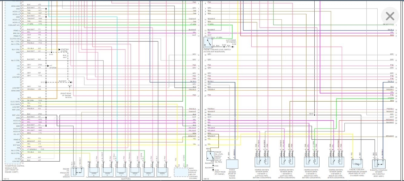

Could you send as separate pages as pdf I could print? Thanks
Sunday, October 13th, 2019 AT 11:38 AM
I sent you the pin out of the PCM that had pin numbers and wire colors.
They are ready to print.
What exactly do you need for the rest?
Sunday, October 13th, 2019 AT 2:14 PM
LOUIS W NAGY
  • 55 POSTS

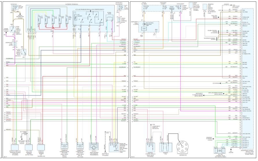

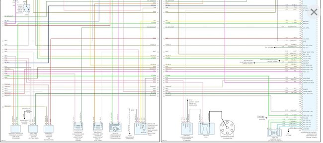

The last diagrams you sent where what I needed, but I could not make the font large enough when I printed it out. Could you maybe brake it down into 2 pages as pdf and let’s see if that works? My wife struggled with it and had no luck. Thanks
Monday, October 14th, 2019 AT 3:57 AM
Okay, I enlarged the diagrams and attached them.
+3
