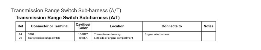

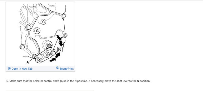

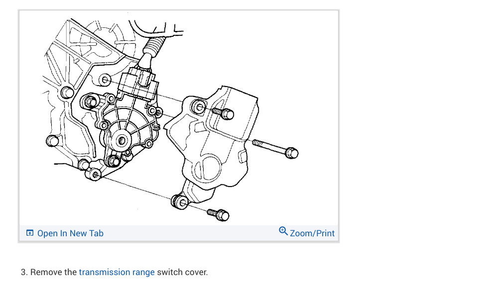

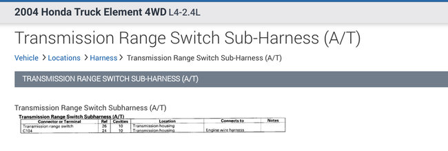

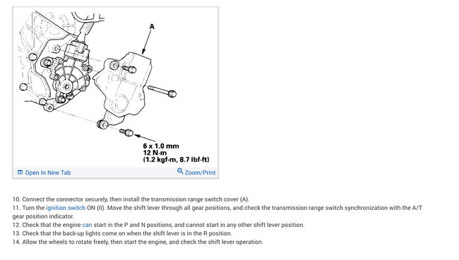

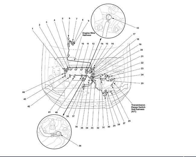

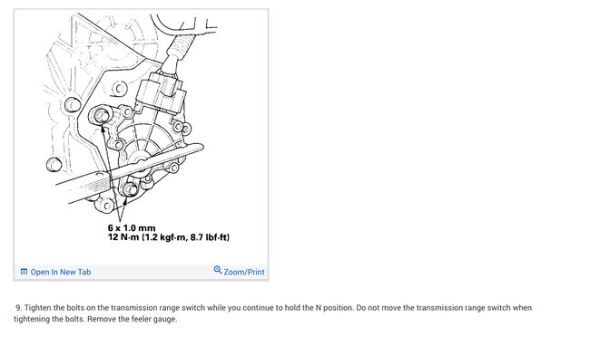

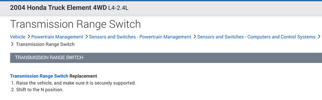

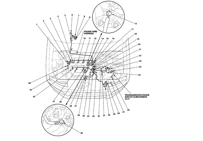

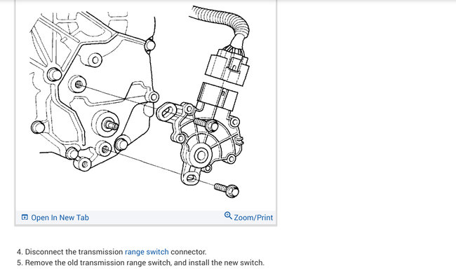

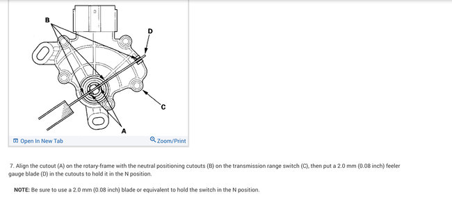

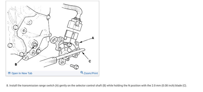

I need to replace the transmission range sensor and I don't know the location of it .
Can you tell me where to find it on the vehicle?
Thank you
Feb 10, 2020 at 10:42 PM
SCGRANTURISMO
  • 4,897 POSTS
I have included the information that you have requested along with the instructions from the vehicle manufacturer for the removal and installation of the Transmission Range Switch for your vehicle. Please go through these guides and get back to us with how everything turns out.
