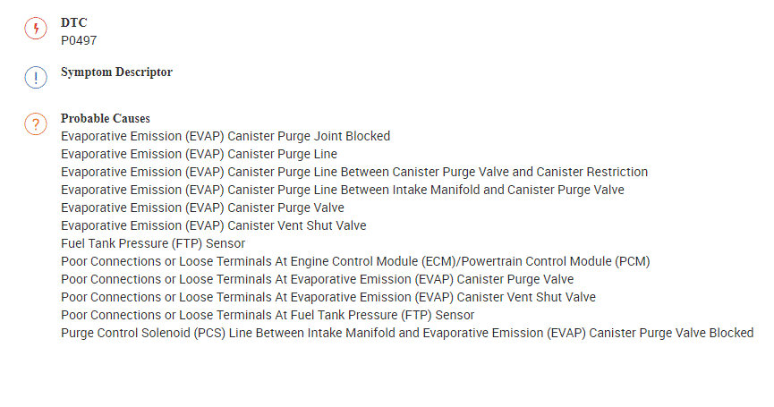

DTC P0497: EVAP System Low Purge Flow

YES - Intermittent failure, system is OK at this time, Check for poor connections or loose terminals at the FTP sensor, the EVAP canister purge valve, or the EVAP canister vent shut valve and the ECM/PCM.
NO - Go to step 5.

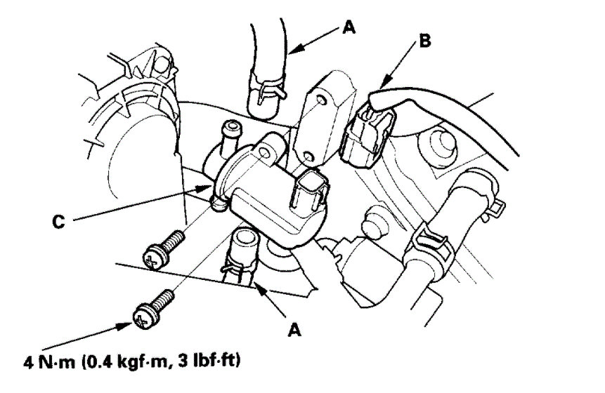

6. Disconnect the vacuum hose (A) from the EVAP canister purge valve joint (B) in the engine compartment, and connect a T-fitting (C) from the vacuum gauge and the vacuum pump/gauge, 0 - 30 in.Hg, to the vacuum hose (A) as shown.
7. Do the EVAP PCS on in the inspection menu with the HDS.
8. Slowly apply about 0.6 in.Hg (15 mmHg) of vacuum to the hose.
Does it hold vacuum?
YES - Check for blockage in the PCS line between the intake manifold and the EVAP canister purge valve, and the line between the EVAP canister purge valve and the EVAP canister purge joint. If the vacuum hoses are OK, replace the EVAP canister purge valve, then go to step 22.
NO - Go to step 9.

19. Disconnect the vacuum hose (purge line) (A) from the EVAP canister purge valve (B), and connect a T-fitting (C) from the vacuum gauge and the vacuum pump/gauge, 0 - 30 in.Hg, to the hose as shown.
20. Do the EVAP CVS ON in the INSPECTION MENU with the HDS.
21. Slowly apply about 2 kPa (0.6 in.Hg, 15 mmHg) of vacuum to the hose.
Does the hose hold vacuum?
YES - Check for blockage on the EVAP canister purge joint, then go to step 22.
NO - Replace the EVAP canister vent shut valve, then go to step 22.

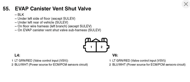

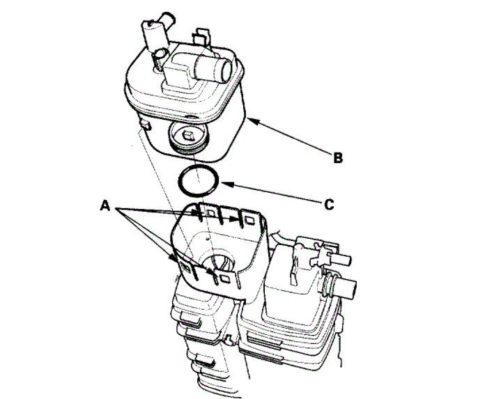

Okay, then I would suspect the vent solenoid as the issue.
+3
Monday, September 14th, 2020 AT 10:25 AM
ED27278
  • 8 POSTS
Is that located underneath car near gas tank? This is different from purge solenoid, right?
+1
Monday, September 14th, 2020 AT 10:31 AM
ED27278
  • 8 POSTS
I’m not sure if you are talking about the evap purge valve under the hood or the canister shut valve located under the car.
+1
Monday, September 14th, 2020 AT 1:06 PM
The purge valve under the hood is what you checked.
The vent solenoid is the canister vent solenoid. It is a normally open valve so you can add fuel. It closes when the ECM does its test of the evap system.
When it does not close and seal, it causes a leak and sets the code.
