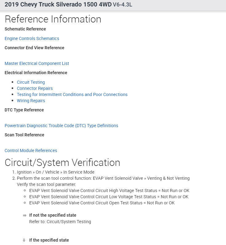

Codes P0449 and P0455
2019 CHEVROLET SILVERADO
35,500 MILES • 4.3L • 6 CYL • 4WD • AUTOMATIC
WILLIAM8588

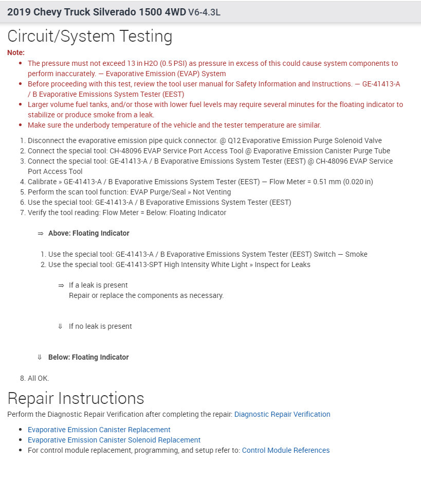

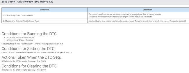

I changed out the Vapor Control Valve Canister and I still have the error code.
Any advice?

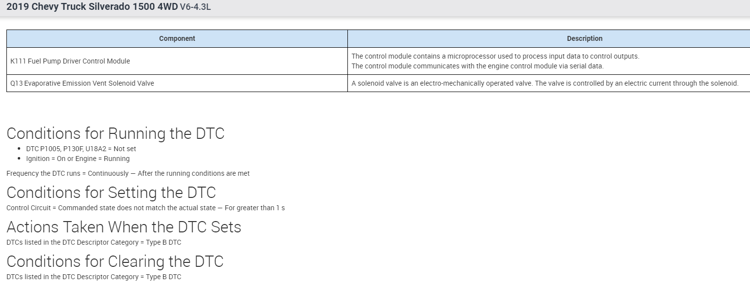

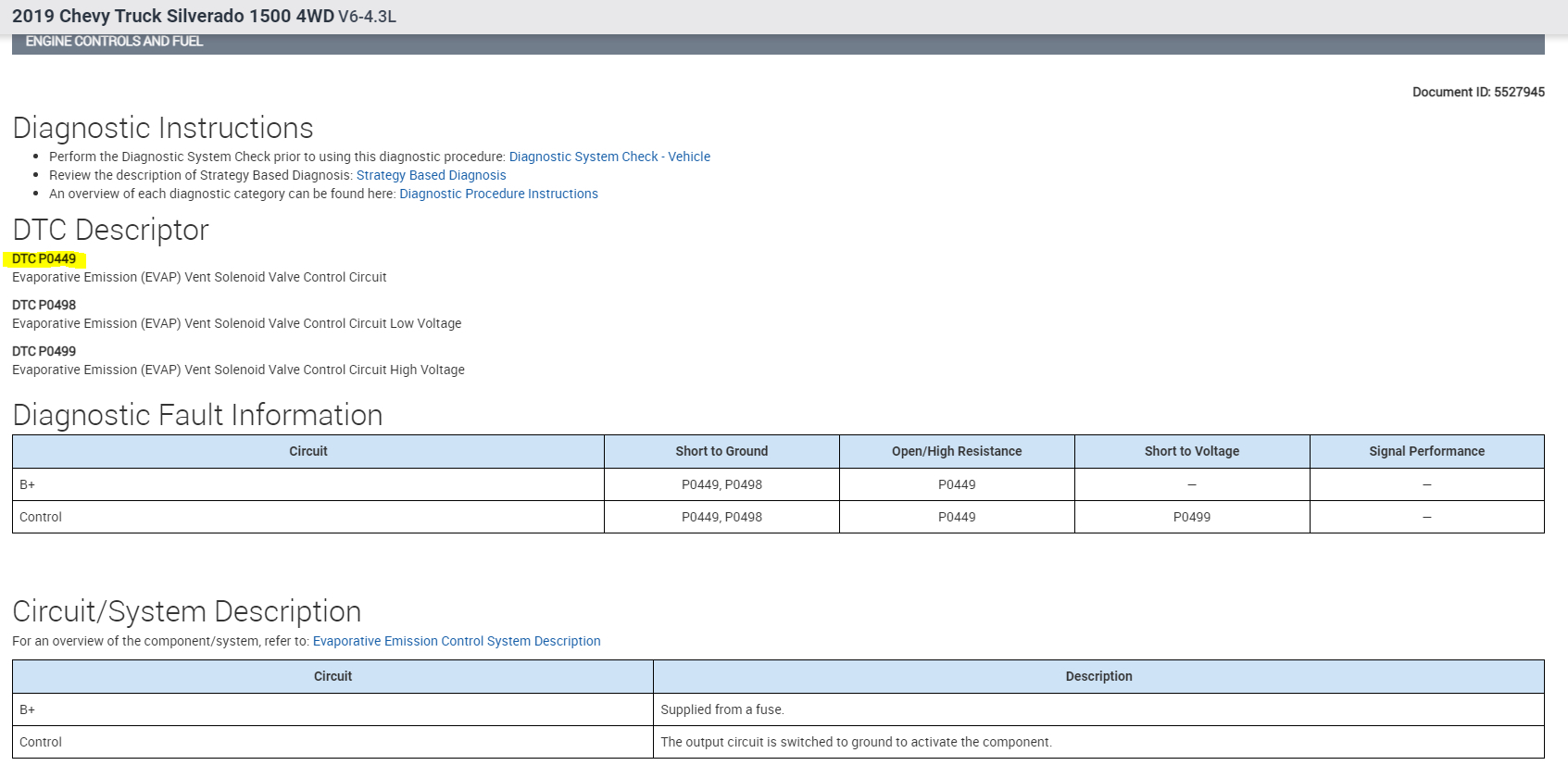

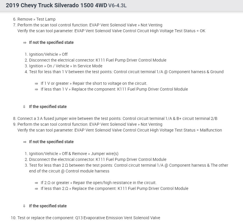

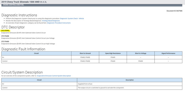

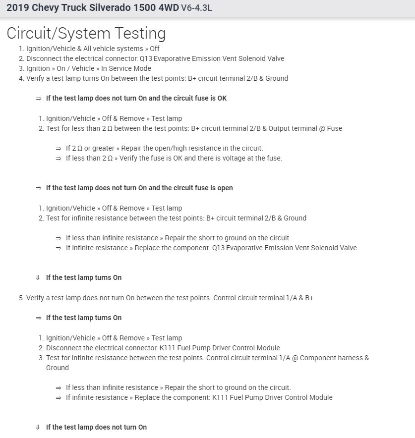

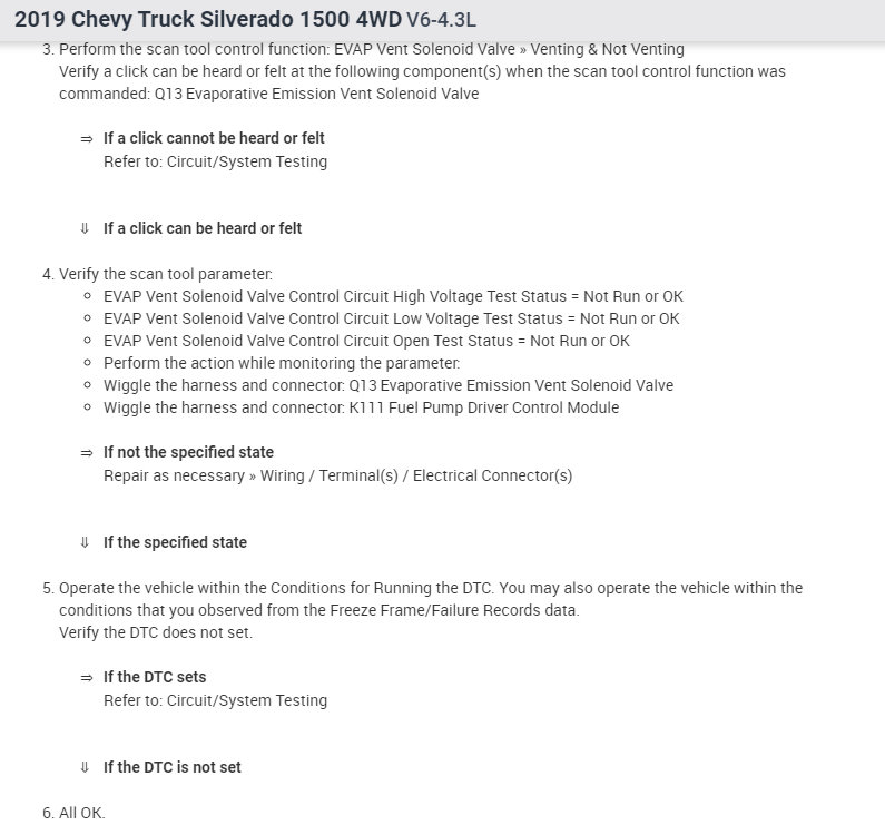

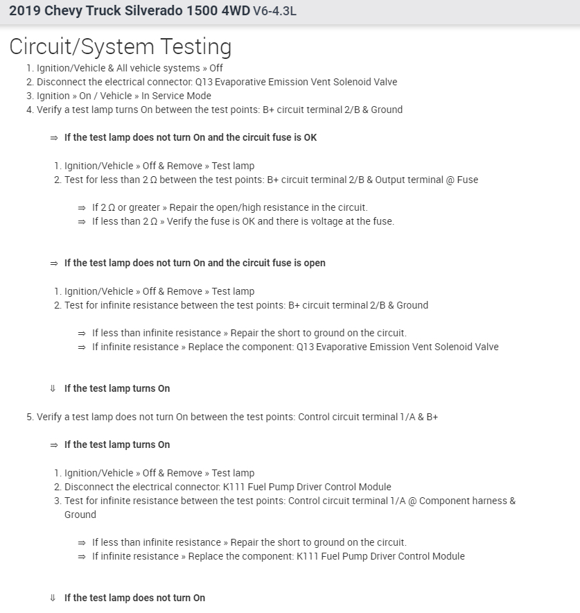

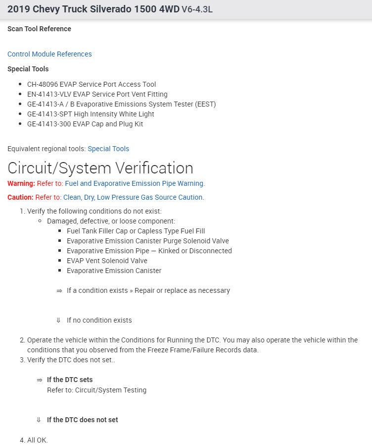

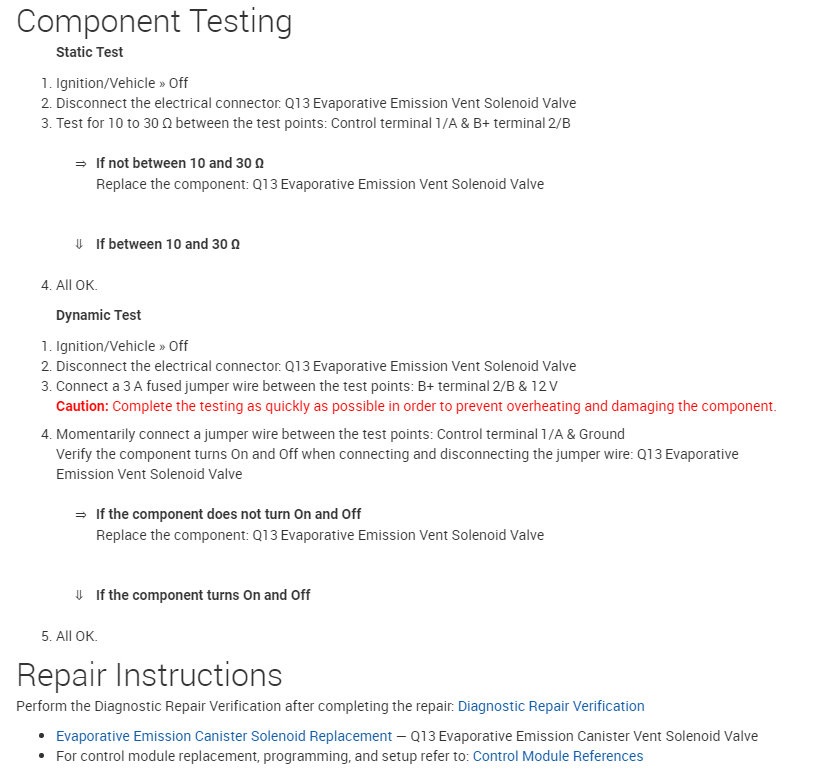

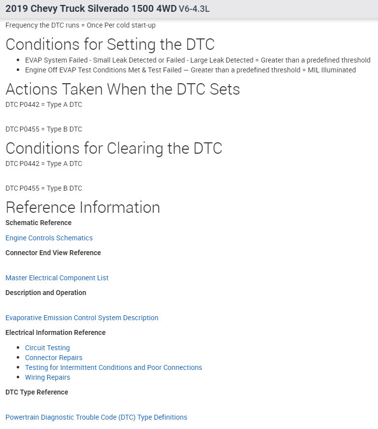

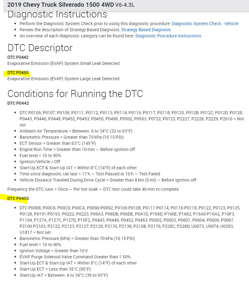

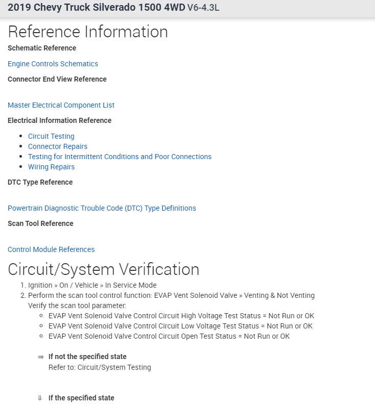

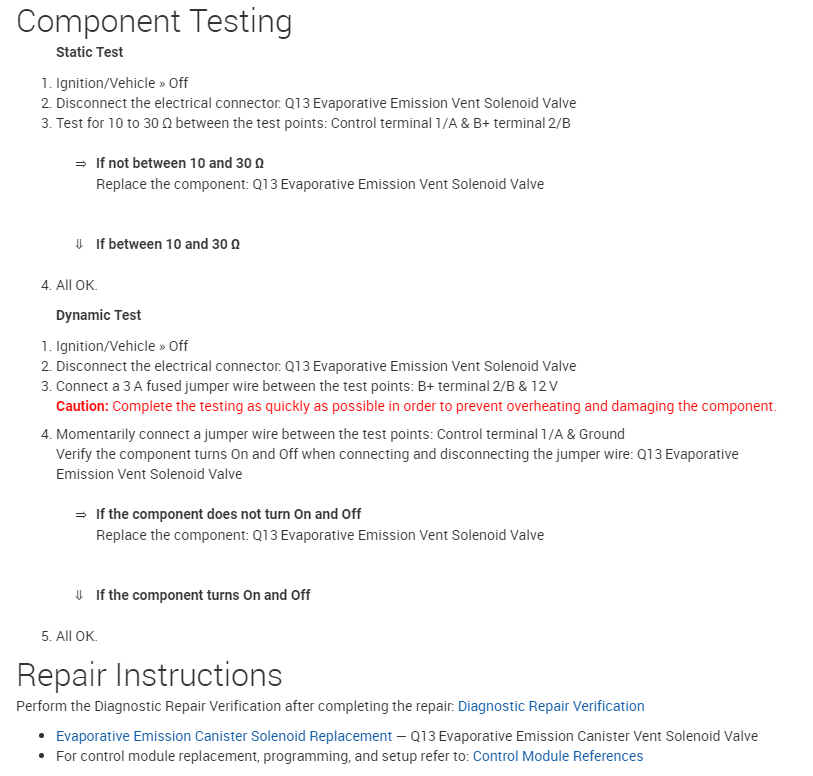

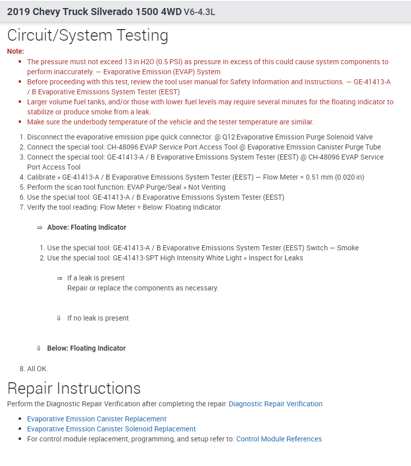

The code
P0449 Evaporative Emission (EVAP) Vent Solenoid Valve Control Circuit
P0455 Evaporative Emission (EVAP) System Large Leak Detected
These can get triggered due to faulty components, any leak within the EVAP system or wiring issues.
https://www.2carpros.com/articles/evap-system-code-repair
I have attached the troubleshooting steps for these codes below. Follow those steps as that can help you determine the issue.
Let me know of any questions.
