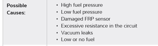

see pic for most common causes , but this may be more in the fuel pressure range being low so check pressure with a gauge auto parts rent it see link. or have your mechanic do it. but its pretty easy.
https://www.2carpros.com/articles/how-to-check-fuel-system-pressure-and-regulator see pic on causes as well pic will be in another answer

here is pic

Hello, We have checked with my mechanic as i didnt have a gauge to test the pump pressure but he said it was my pump that need to be changed and fuel filter. Another person said its the accelerator pedal and throttle unit which is ridiculously expensive. We haven't open the fuel pump unit yet.

it comes down to whom are you going to believe your mechanic or another person. low fuel pressure will cause your problem.if yo have ever run the car out of fuel then i'd go with the pump because the pump gets it lube from the fuel.
