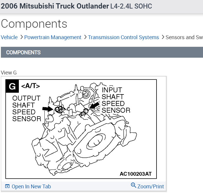

Hi. My transmission stopped working so I purchased a second hand one. My neighbor installed it and is coming up with faults drive slow and service engine. It drives super slow in forward and reverse, almost no revs.

What codes are they? It sounds like the fluid is low or you have an input shaft speed sensor that is not working.
here are two guides that can help with the location of the sensor in the images below:

Hi. I believe the speed sensors have been checked and Transmission fluid level is good.
I have a Bluetooth obi II scan which connects to my phone and the fault codes are...
P1603 - powertrain
U0101 - network

Here is information on the codes:
P1603 code is a generic powertrain code that indicates a malfunction in the internal control module memory.
The U0101 code refers to a communication problem within the network of the vehicle.
So it seems like one of the main grounds was left off when the transmission works was done please double check the grounds around the transmission.
