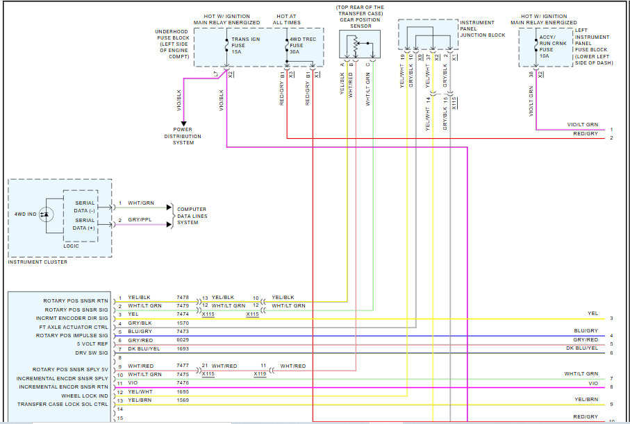

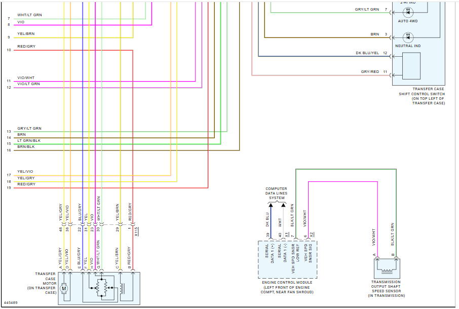

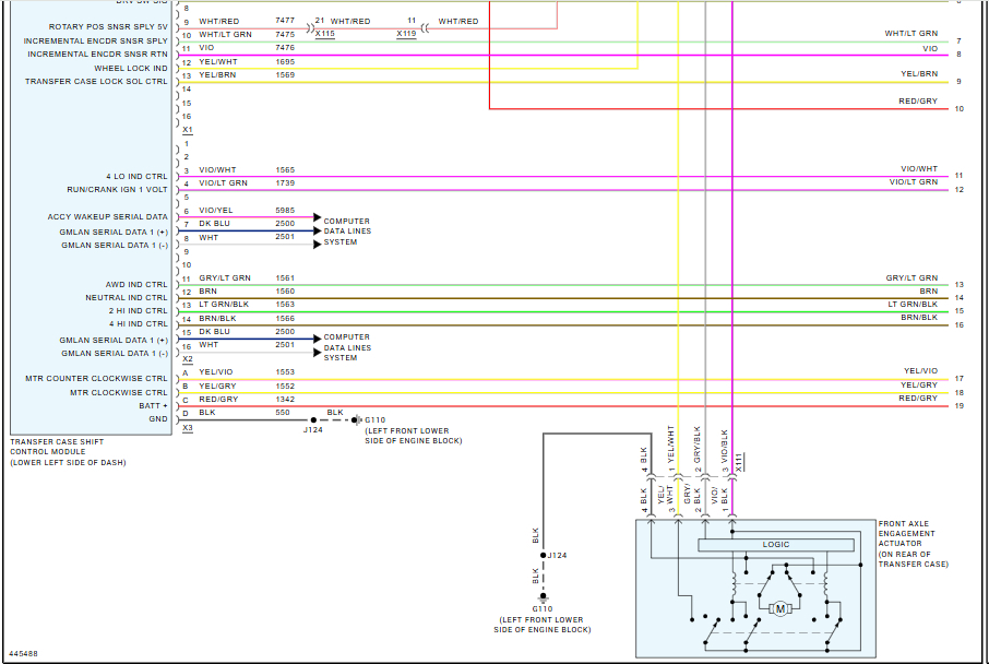

Need wire diagram to the vehicle listed above 4wd actuator.
Jan 10, 2025 at 12:33 PM
  • 110,193 POSTS

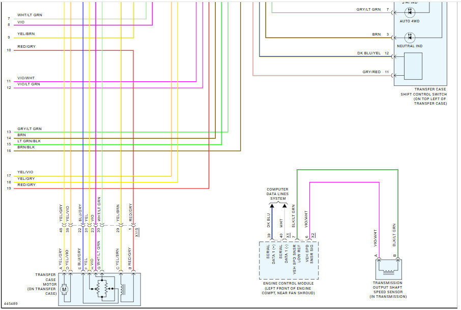

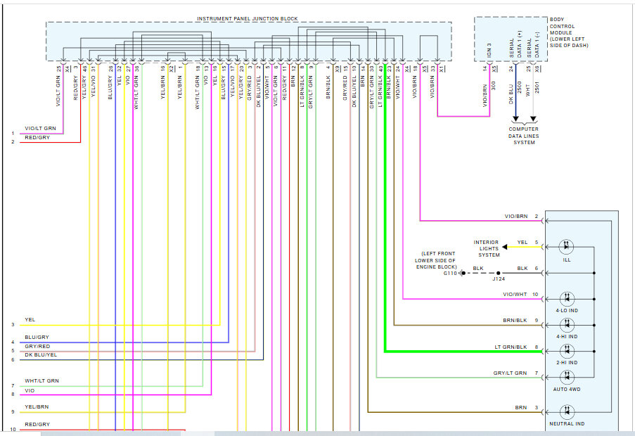

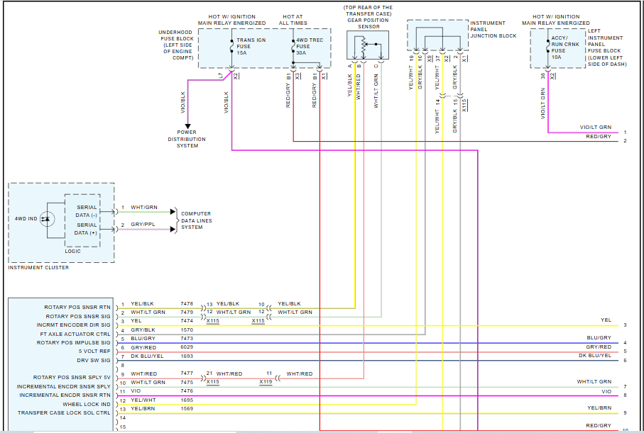

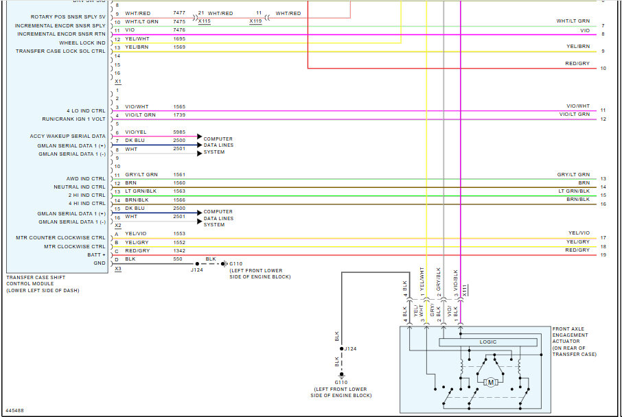

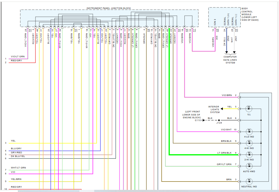

As far as the wiring schematic is concerned, I attached the entire circuit below. Note that it is two pages long in the manual. However, I had to cut each page in half to make it readable for you. I did overlap them so you can follow from one to the next.
As far as the code, it indicates an issue at the front axle. If the code was C0364-01 or 04, the front axle stays disengaged all the time. If it is a C0364-02, that would cause the axle to be engaged at all times.
Let me know what you are experiencing.
