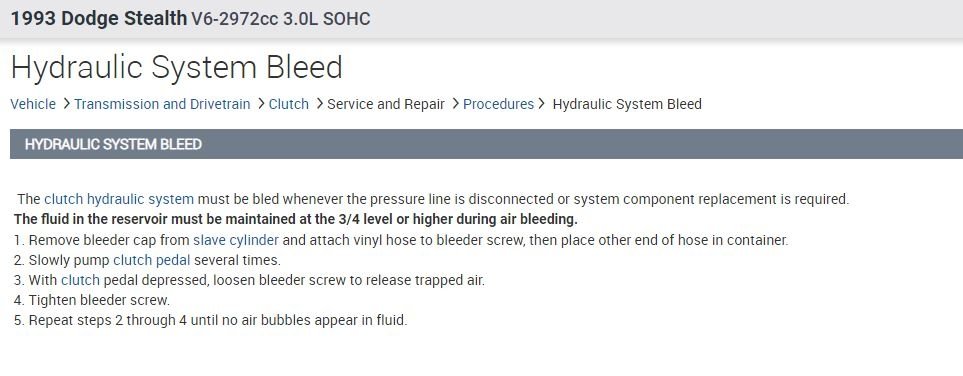

So the other day I was driving and came to a yield, I pushed my clutch in to prevent stalling. It had gotten stuck to the floor, instantly reacting I took my foot and pryed it back into normal position. That's when I heard 2 loud knocks under the car, and now my car will start, I can move throughout all gears without pushing the clutch in, and when in gear,if I let go of the clutch it will not die. I had replaced a leaking slave cylinder a couple months back, and the clutch is still just as tight. So now my car is a big paperweight, I was told it could possibly be the throw out bearing? But if it was that, how could my clutch be so springy. any info would be appreciated!

Hi, I'm Dan.
There is a chance that there was air in the clutch hydraulic system. Try bleeding the system to see if that helps. I've attached the procedure for that.
