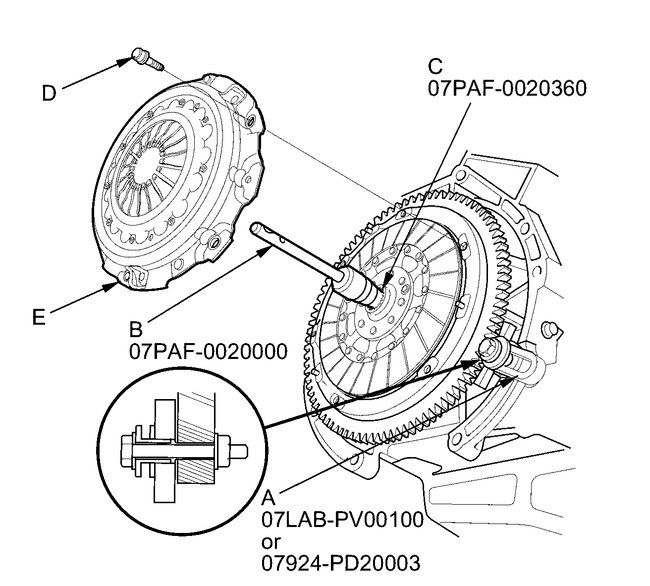

Recently I noticed that my clutch will slip but then will grab and work fine. It is happening more frequently. I gave it full power in 2 gear after it grabbed and it didn't slip so i don't think the clutch is worn out. I got over 250,000 with my clutch. Not sure if it is an adjustment or hydraulic issue. No oil leaks.
Jan 28, 2021 at 3:18 PM
  • 110,193 POSTS
A failing clutch is more likely to slip in higher gears. In first or second gear, there is less of a load on it because of the gear ratio. If you were to place it in 4th or 5th and accelerate hard, does it slip? If it does, the clutch needs replaced. this video will walk you throught he job on a similar car the process is this same.
https://youtu.be/6N6b5F2ChyE
___________________________________

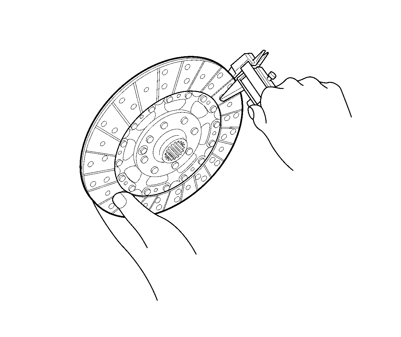

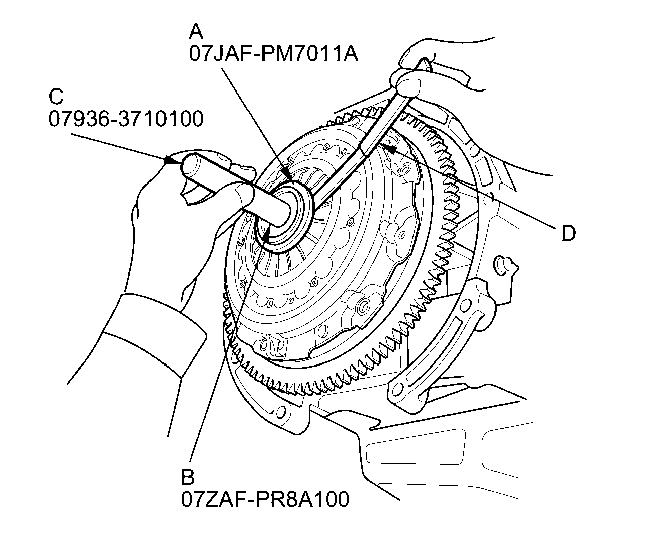

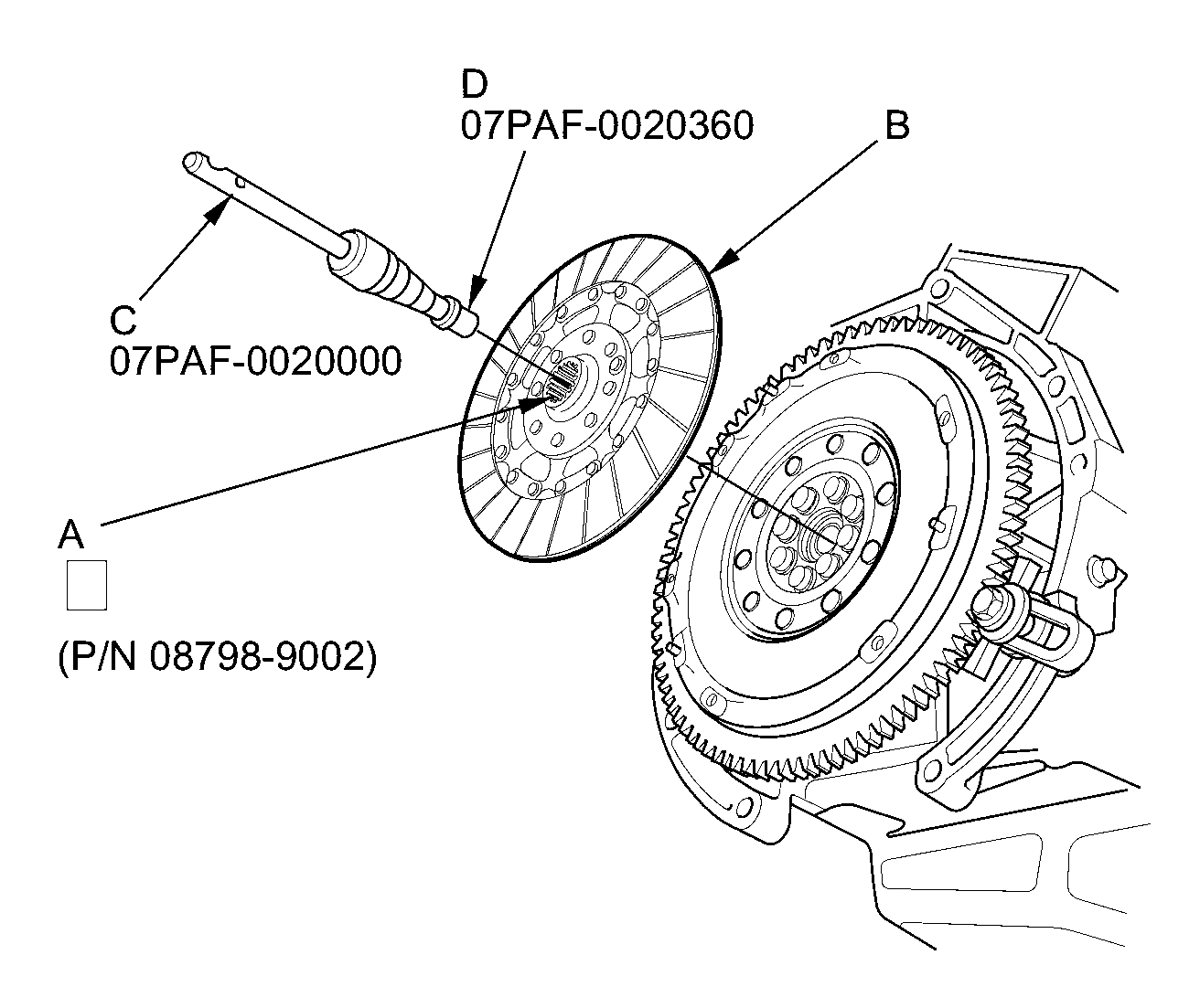

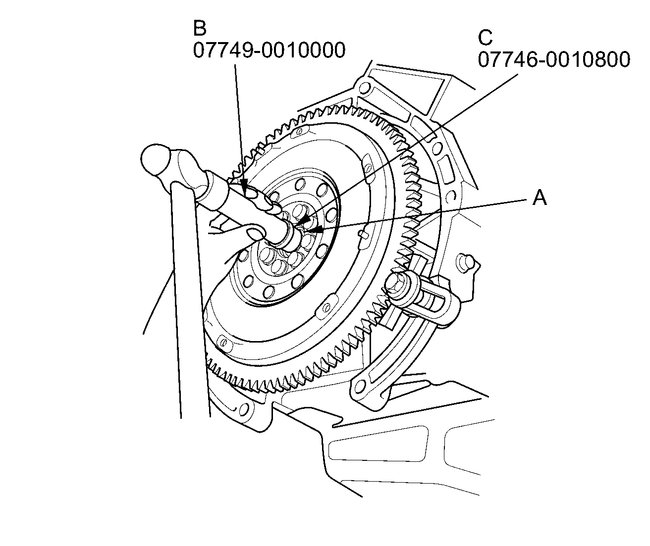

Let me know if that is what happens. Also, if you want to replace the clutch, here are the directions. Note the pics correlate with the directions.

1. Remove the transmission See: Manual Transmission/Transaxle > Removal and Replacement > Manual Transmission Removal.

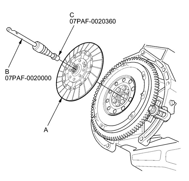

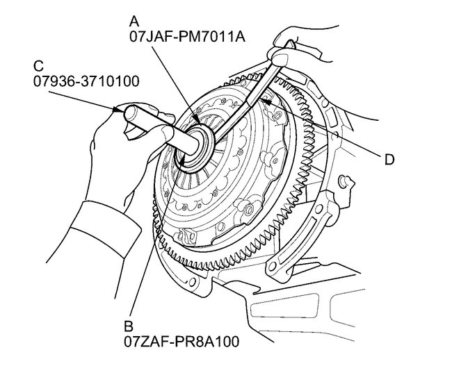

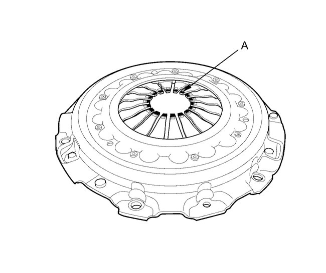

2. Check the evenness of the height of the diaphragm spring fingers using the clutch alignment disc (A), the clutch alignment shaft (B), the remover handle (C), and a feeler gauge (D). If the height difference is more than the service limit, replace the pressure plate.
pic 1
pic 2

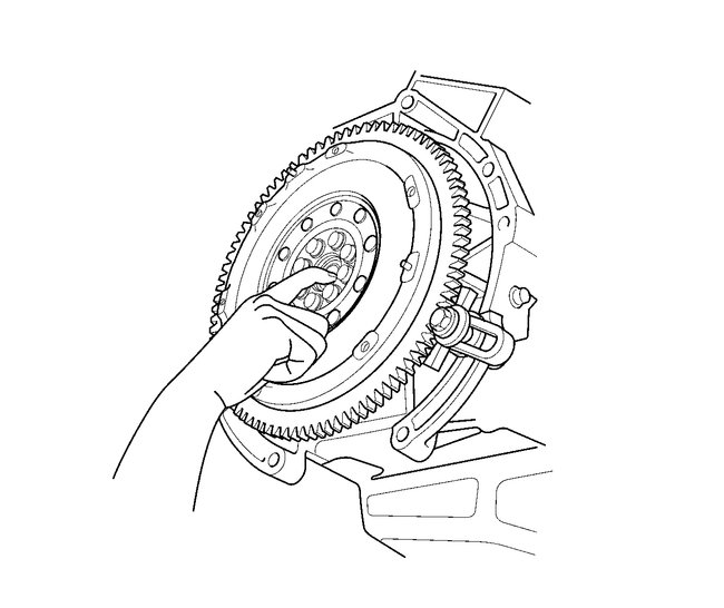

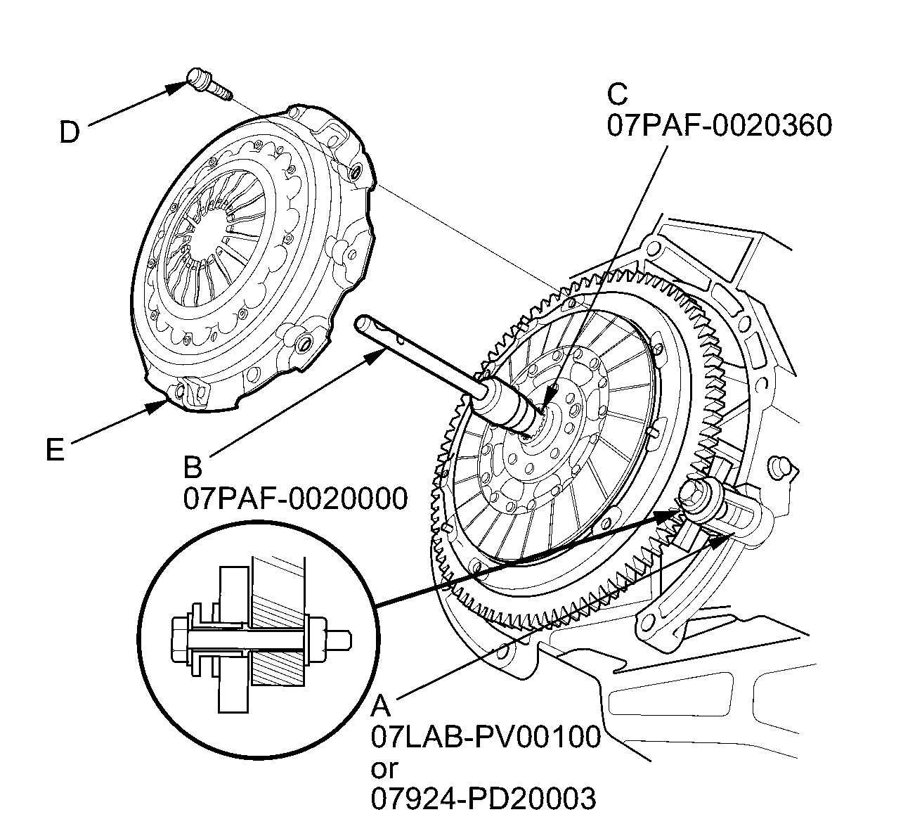

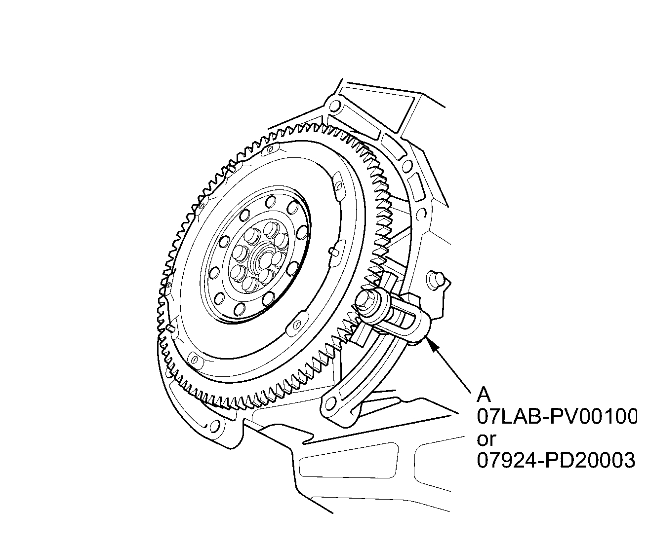

3. Install the ring gear holder (A), the clutch alignment tool set (B), and the 20 mm clutch alignment pilot (C).
pic 3
4. To prevent warping, loosen the pressure plate mounting bolts (D) in a crisscross pattern in several steps, then remove the pressure plate (E).

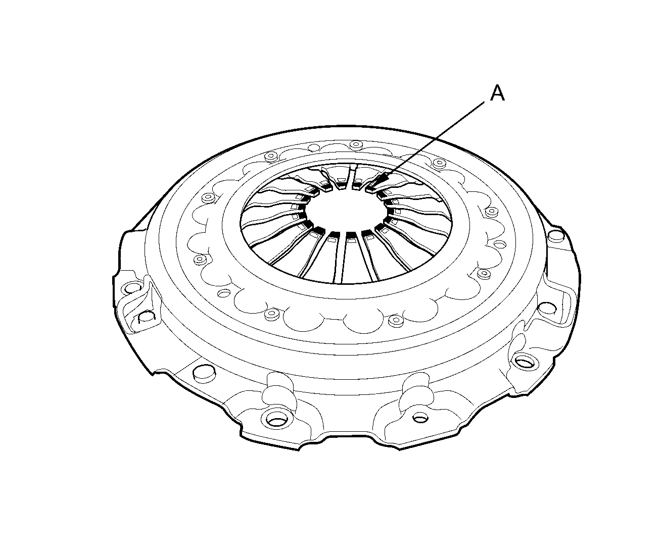

5. Inspect the fingers of the diaphragm spring (A) for wear at the release bearing contact area.
pic 4

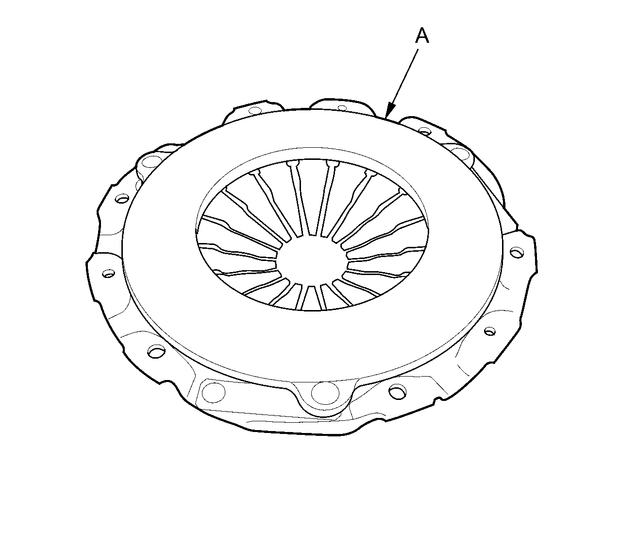

6. Inspect the pressure plate surface (A) for wear, cracks, and burning.
pic 5

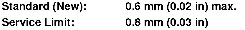

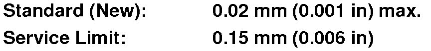

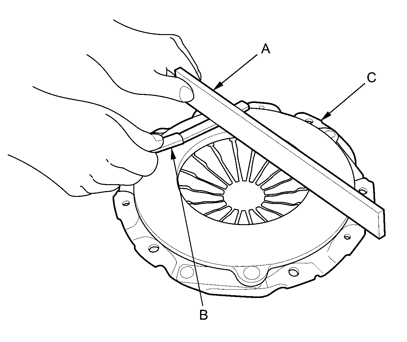

7. Inspect for warpage using a straight edge (A) and a feeler gauge (B). Measure across the pressure plate (C). If the most measurement difference is more than the service limit, replace the pressure plate.
pic 6
pic 7

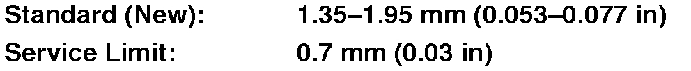

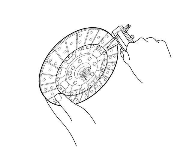

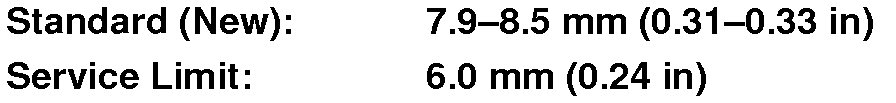

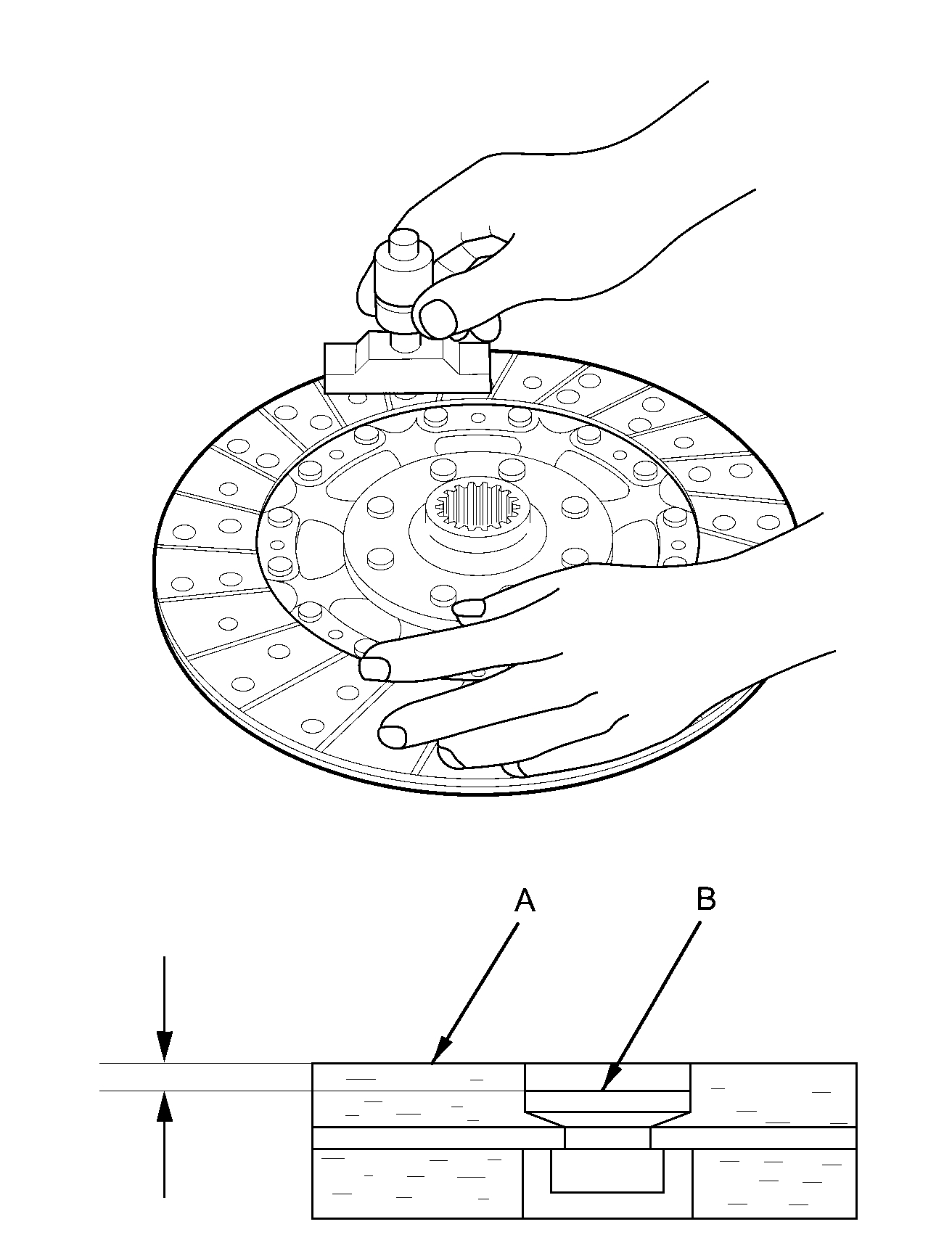

10. Measure the clutch disc thickness. If the measurement is less than the service limit, replace the clutch disc.
pic 9
pic 10

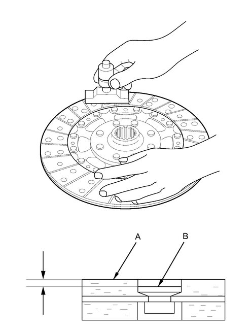

11. Measure the depths of the rivets from the clutch disc lining surface (A) to the rivets (B) on both sides. If the measurement is less than the service limit, replace the clutch disc.
pic 11
pic 12

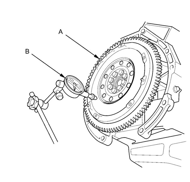

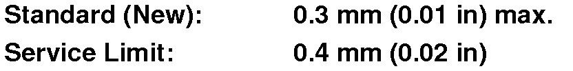

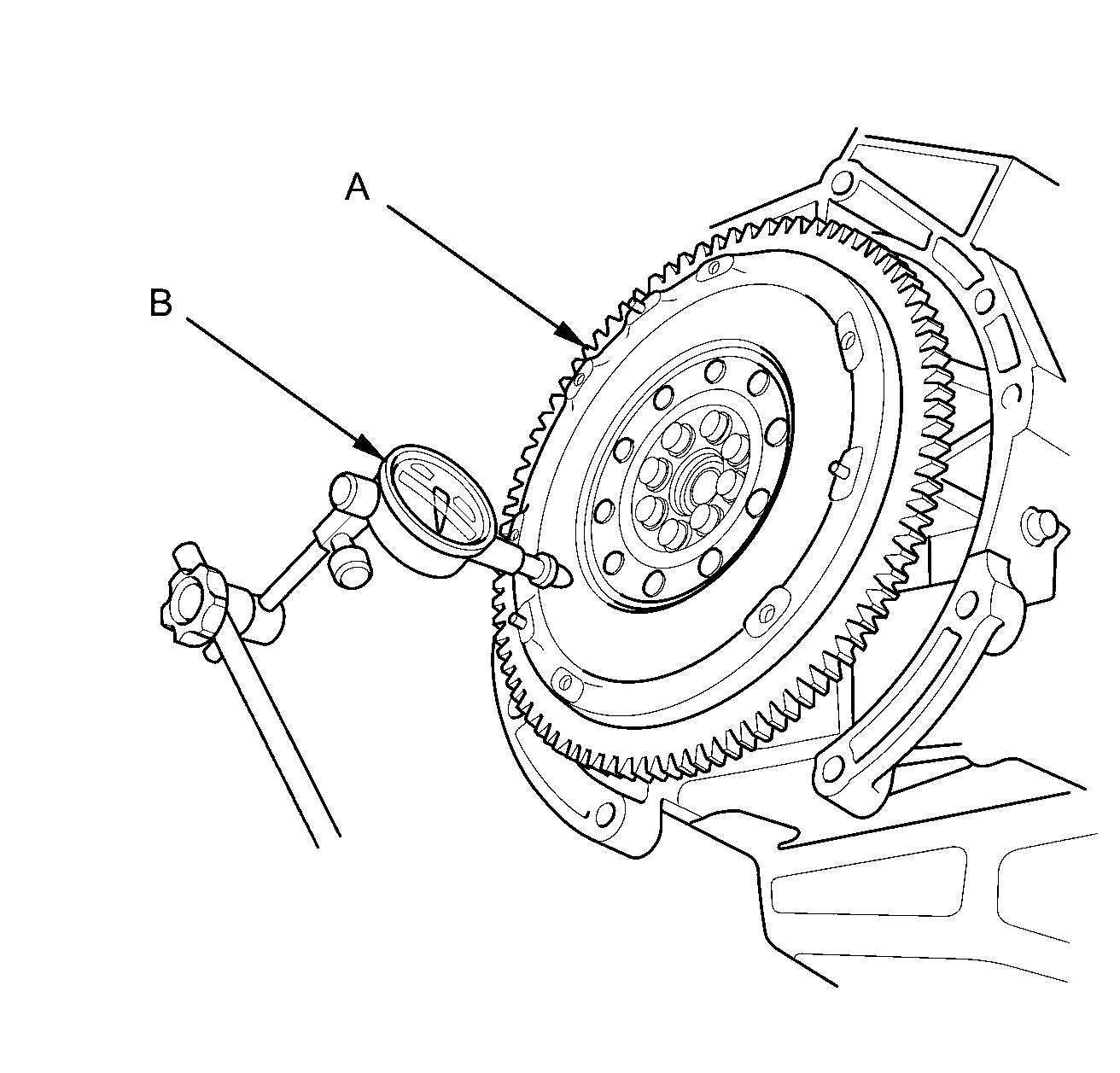

15. Measure the flywheel (A) runout using a dial indicator (B). Through at least two full turns with pushing against the flywheel each time you turn it to take up the crankshaft thrust washer clearance. If the measurement is not within the standard, replace the flywheel, and recheck the runout; go to step 16.
pic 13
pic 14

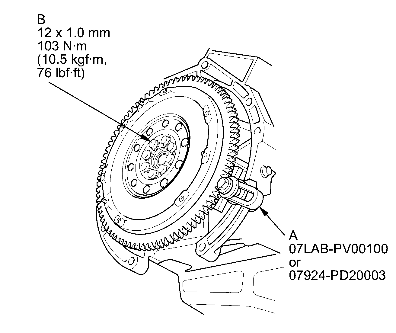

16. Install the ring gear holder (A).
pic 15
17. Loosen the flywheel mounting bolts in a crisscross pattern in several steps. Remove the bolts, then remove the flywheel and the ring gear holder.
18. Install the flywheel on the crankshaft, and install the mounting bolts finger-tight.
19. Install the ring gear holder (A), then torque the flywheel mounting bolts (B) in a crisscross pattern in several steps.

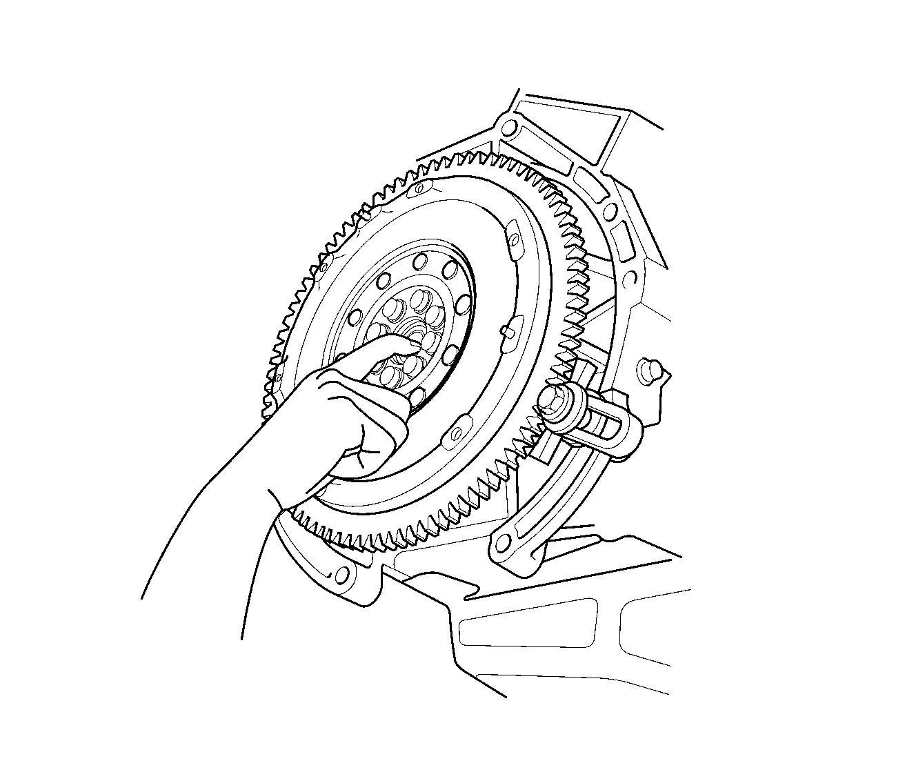

20. Turn the inner race of the pilot bearing with your finger. The pilot bearing should turn smoothly and quietly. Check that the pilot bearing outer race fits tightly in the flywheel. If the race does not turn smoothly, quietly, or fit tight in the flywheel, replace the pilot bearing; go to step 21.
pic 17

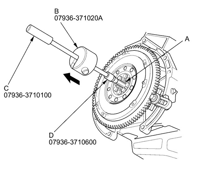

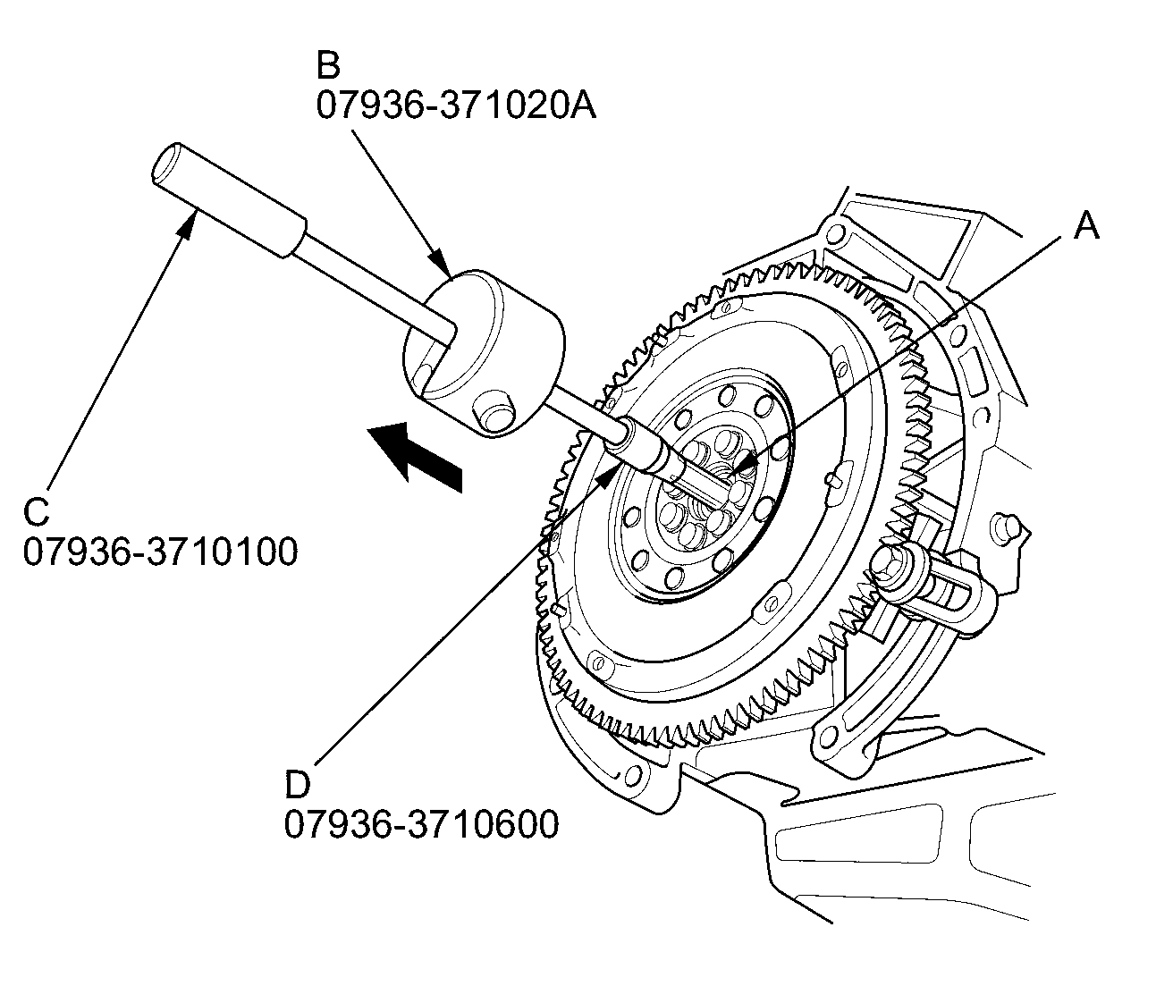

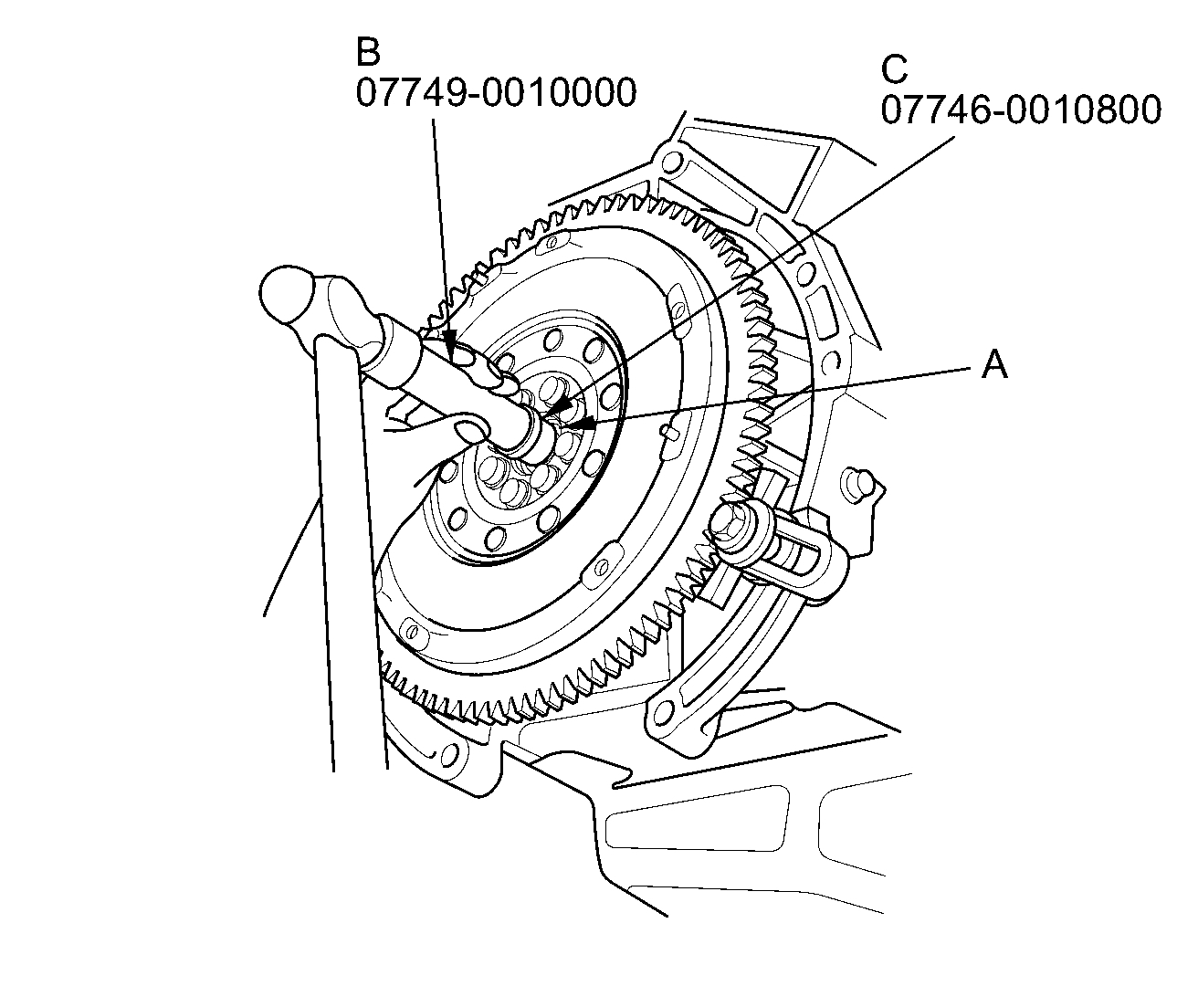

21. Remove the pilot bearing (A) using the slide hammer (B), the remover handle (C), and the 20 mm bearing remover shaft set (D).
pic 18
22. Install a new pilot bearing (A) into the crankshaft using the 15 x 135L driver handle (B) and the 22 x 24 mm attachment (C).
pic 19

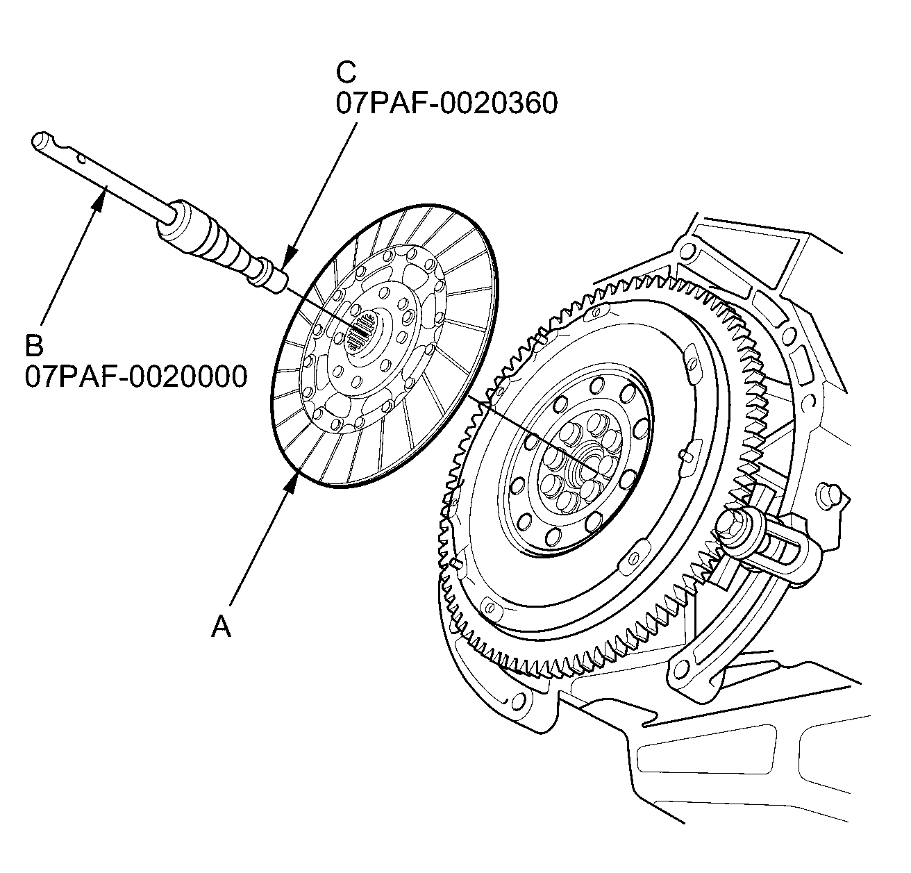

Clutch Disc and Pressure Plate Installation
23. Temporarily install the clutch disc onto the splines of the transmission mainshaft. Make sure the clutch disc slides freely on the mainshaft.
24. Apply super high temp urea grease (P/N 08798- 9002) to the splines (A) of the clutch disc (B), then install the clutch disc using the clutch alignment tool set (C) and the 20 mm clutch alignment pilot (D).

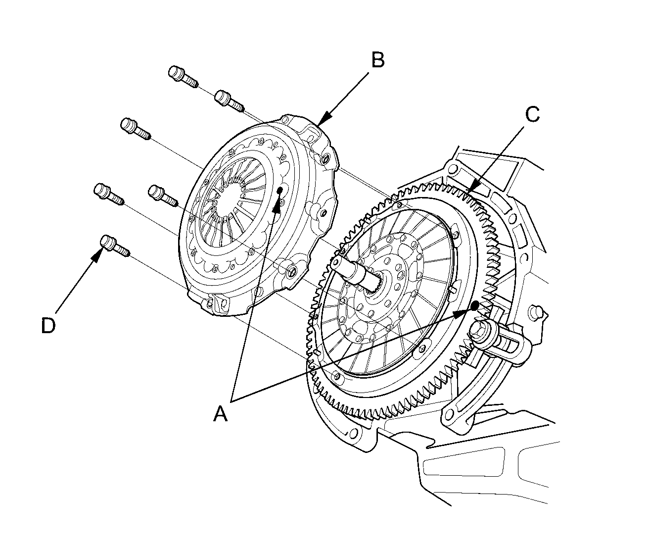

25. Align (±60 degrees) the point marks (A) across the pressure plate (B) and the flywheel (C).
pic 21

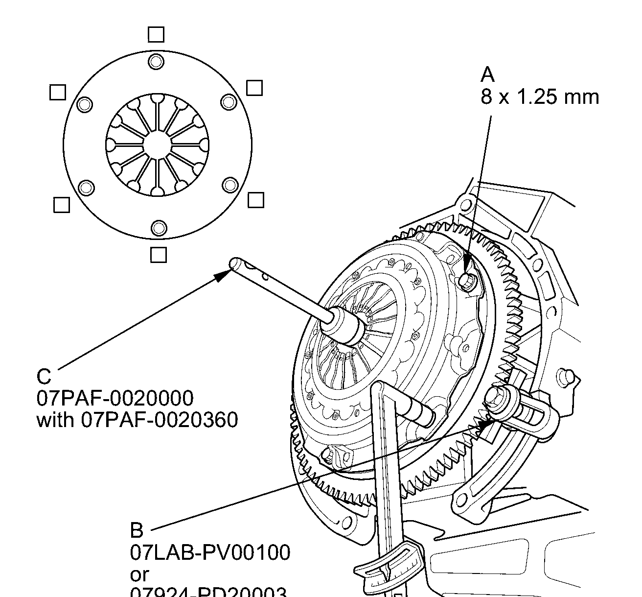

26. Install the pressure plate and the mounting bolts (D), finger-tight.
27. Torque the mounting bolts (A) in a crisscross pattern. Tighten the bolts in several steps to prevent warping the diaphragm spring. Make sure that there is not clearance between the pressure plate and the flywheel.
pic 22
pic 23

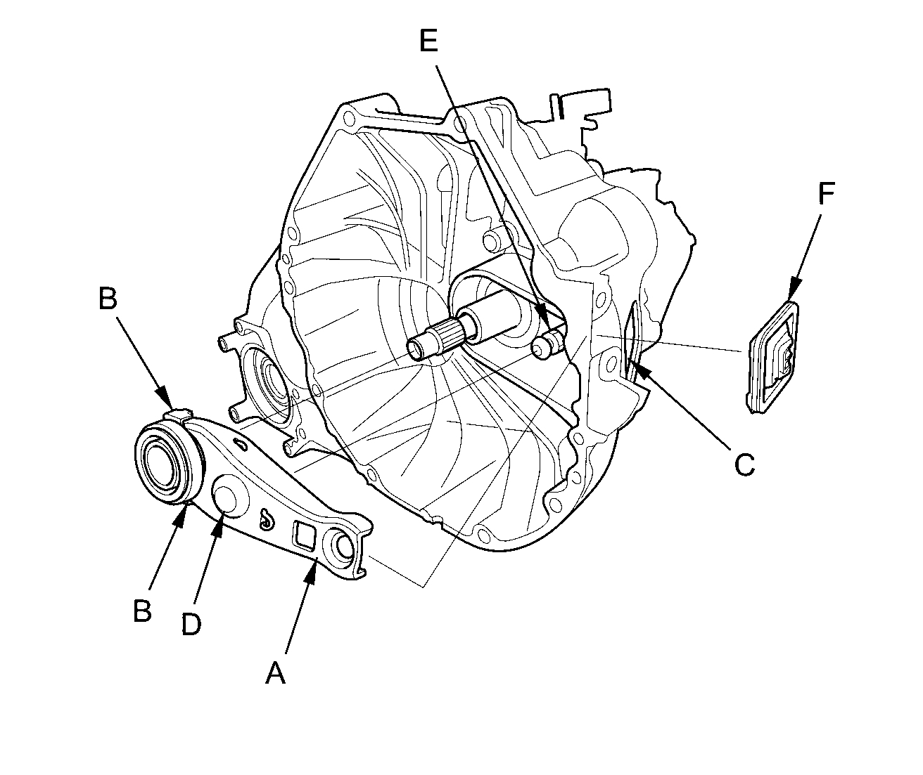

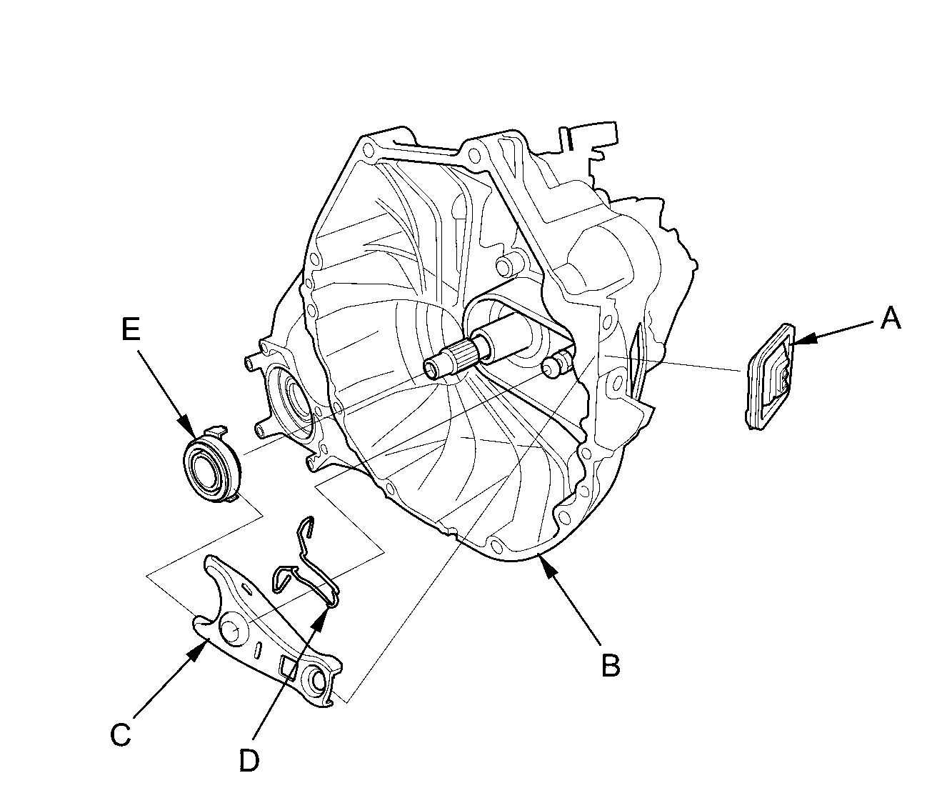

Release Bearing Removal
2. Remove the release fork boot (A) from the clutch housing (B).
pic 24
3. Remove the release fork (C) from the clutch housing by squeezing the release fork set spring (D). Remove the release bearing (E).

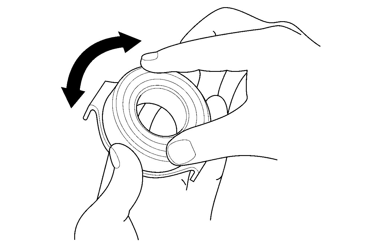

4. Check the play of the release bearing by spinning it by hand. If there is excessive play or noise, replace the release bearing.
NOTE: The release bearing is packed with grease. Do not wash it in solvent.
pic 25

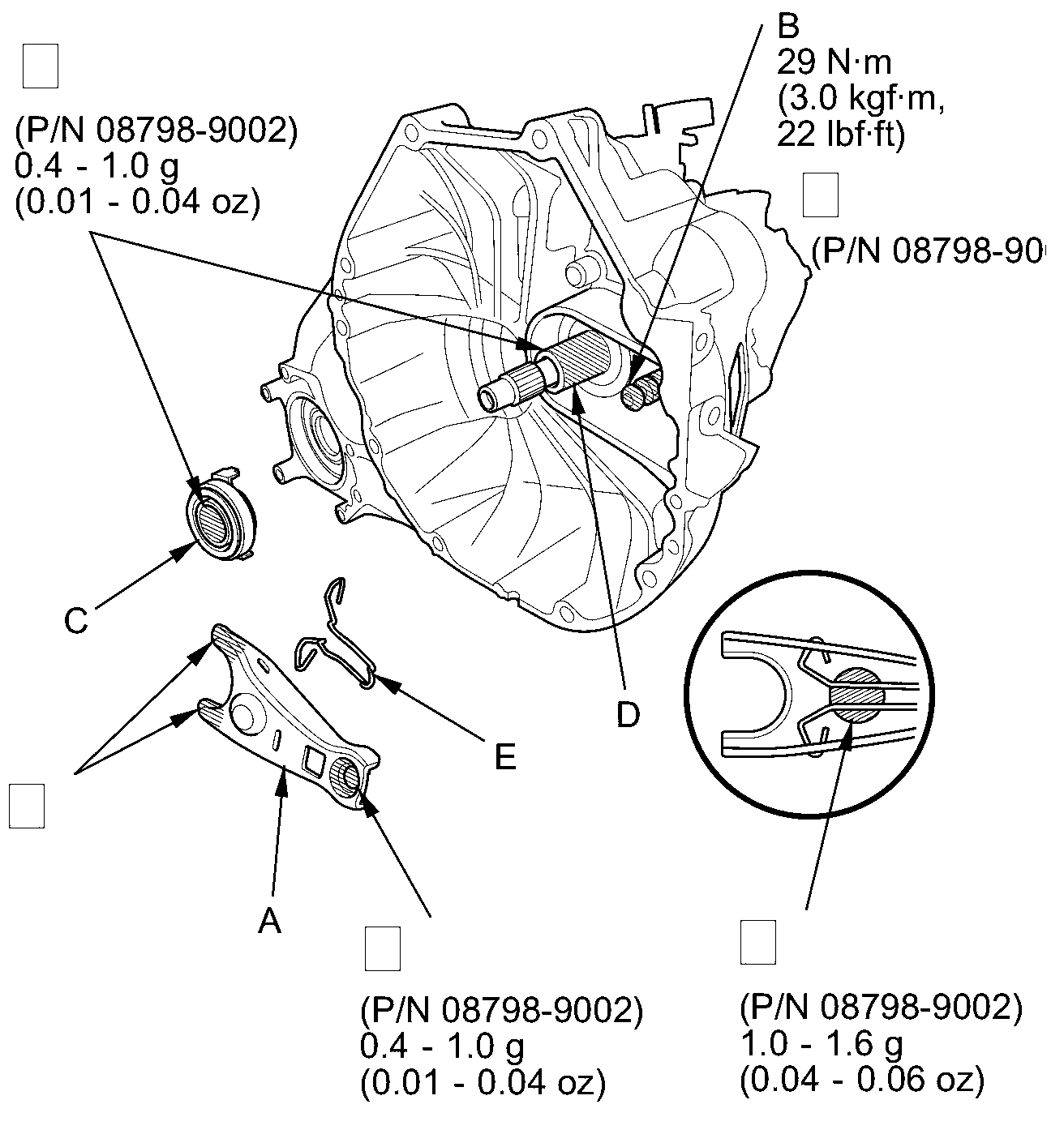

Release Bearing Installation
5. Apply super high temp urea grease (P/N 08798-9002) to the release fork (A), the release fork bolt (B), the release bearing (C), and the release bearing guide (D) in the shaded areas, then set the release fork set spring (E).
NOTE: Replace the release fork bolt if necessary.
pic 26
6. With the release fork (A) slide between the release bearing pawls (B), install the release bearing on the mainshaft while inserting the release fork through the hole (C) in the clutch housing.
pic 27
7. Align the detent (D) of the release fork with the release fork bolt (E), then press the detent of the release fork over the release fork bolt squarely.
8. Install the release fork boot (F). Make sure the boot seals around the release fork and the clutch housing.

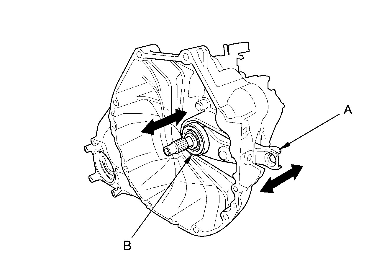

9. Move the release fork (A) right and left to make sure that it fits properly against the release bearing (B) and that the release bearing slides smoothly. Wipe off any excess grease.
pic 28

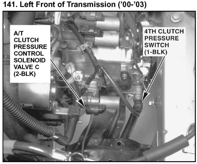

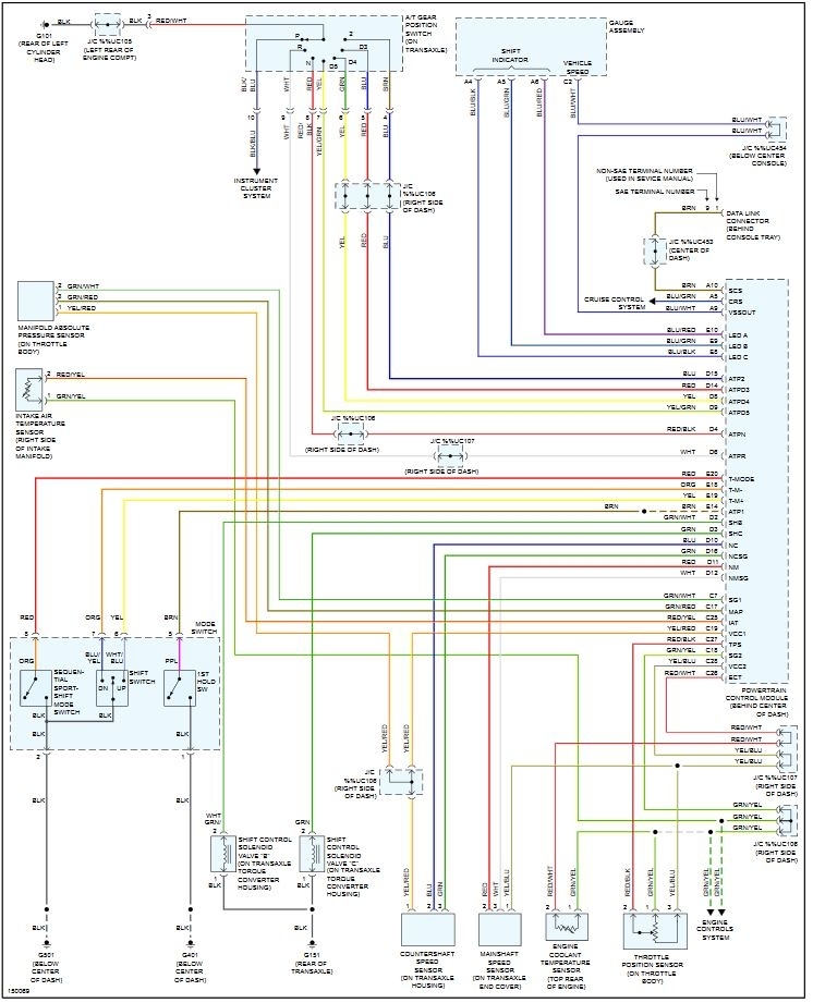

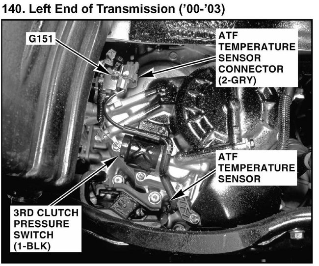

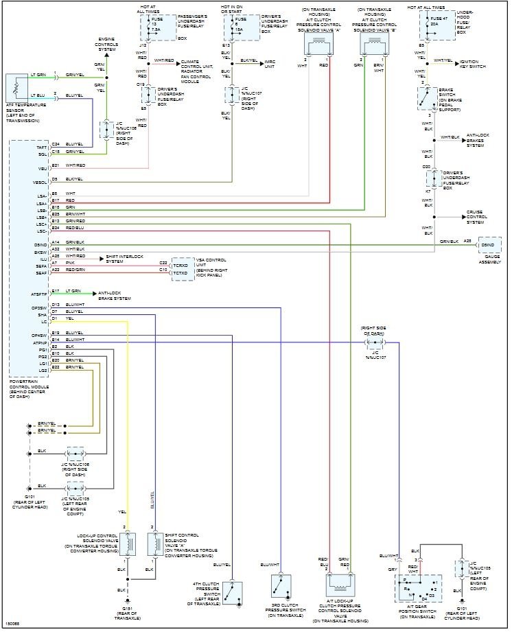

I have yet to find the second clutch pressure switch. Been looking for two weeks and still have not found any picture or diagram. Please show me a picture or diagram. Thank you
Mar 10, 2021 at 1:51 PM (Merged)
JONNYB1963
  • 263 POSTS
Thanks for stopping in. I have looked at several places and this is all that I found so far.

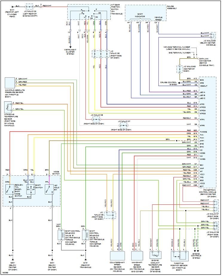

Please see the following diagrams.
Notice in the electrical wiring, there does not seem to be a mention of any sensor for second gear clutch pressure.
I have also included some pictures showing locations of the transmission sensor locations.
I hope that helps.
Jon

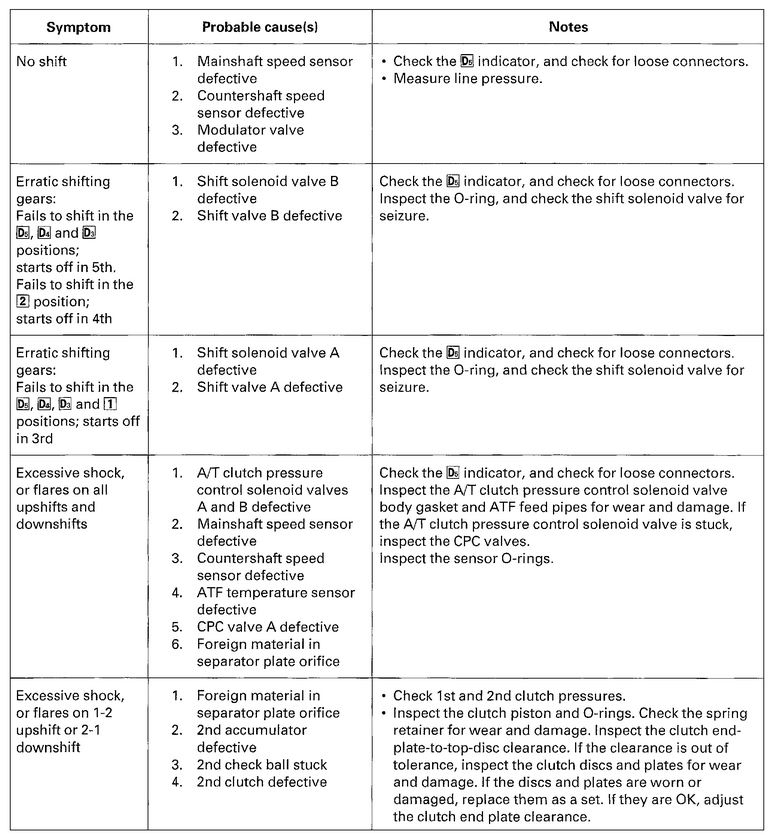

As far as I know, they are not adjustable. It is not like the old transmissions that had band adjustments. The TCU controls all of the servos activities.

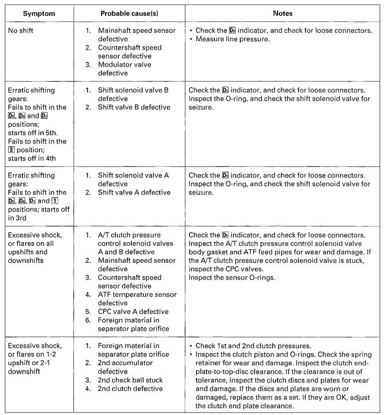

Here is something I found on the repair manual for your condition. (See picture attached)

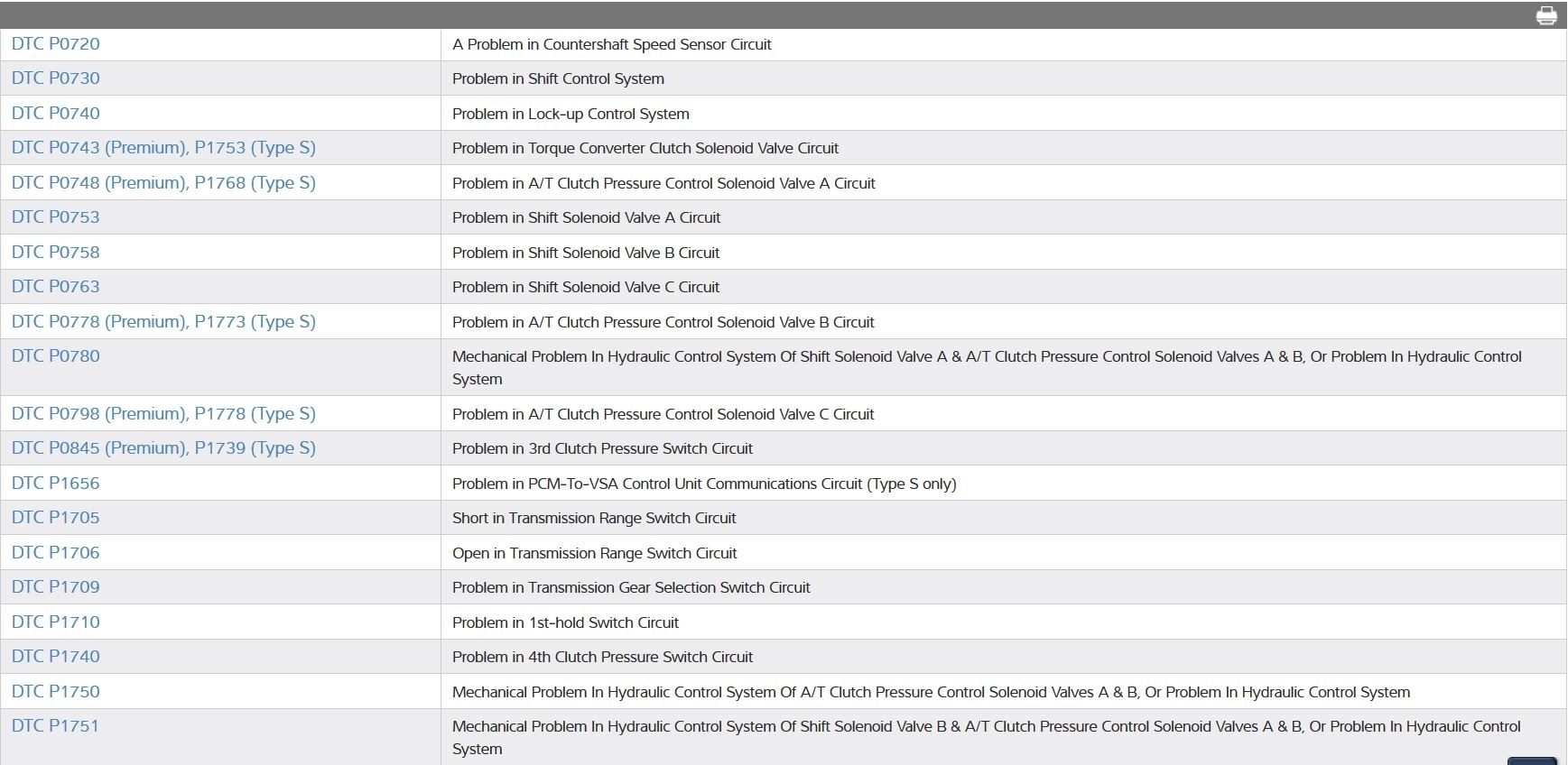

I have another question, in my repair manual I have all the obd2 codes. And some of those codes are specifically for the second clutch pressure switch. So I have to have one, ugh, this is driving me crazy.
Mar 10, 2021 at 1:52 PM (Merged)
JONNYB1963
  • 263 POSTS
That is strange, The DTC codes I see in the manual have nothing on second.
See picture attached:
