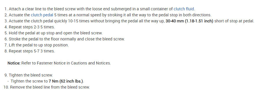

It sounds like either the clutch master cylinder or slave cylinder have failed. You can't shift with it running because the transmission is not disengaged from the engine.

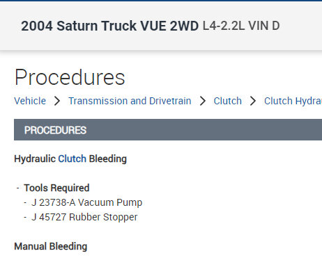

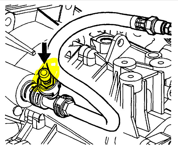

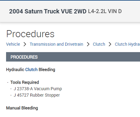

We need to check if the clutch master cylinder has failed. One thing you can do is try bleeding the system to see if the MC forces fluid properly. I attached the bleed directions below.
If it does, the slave is the other likely issue. On this vehicle, you will need to remove the transmission to access it.
Try this and let me know what you find.
