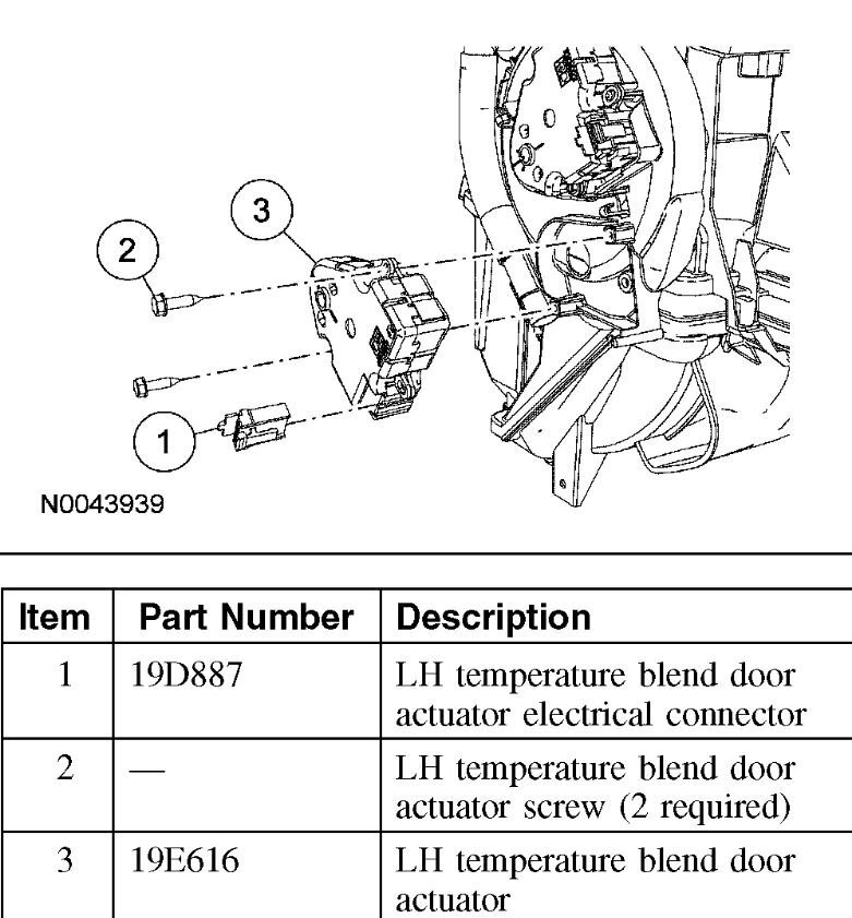

There should be two.
Left (Driver's Side) Actuator
Locate the left-side actuator on the HVAC case, accessible from the driver's footwell. It sits just above the accelerator pedal. Remove the screws holding the old actuator in place. Install the new actuator and tighten the screws.

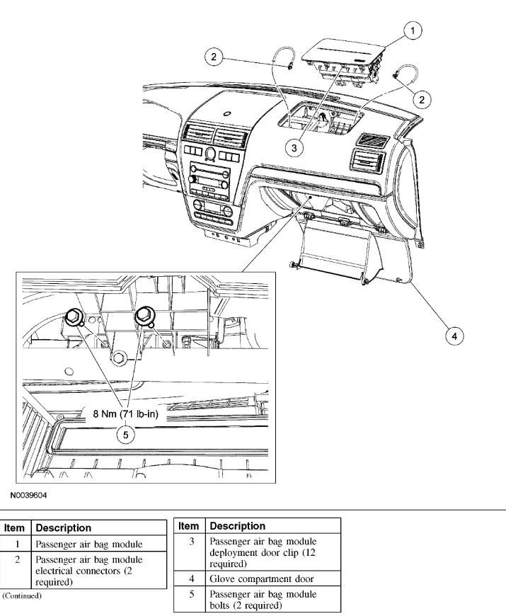

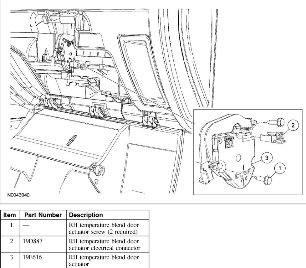

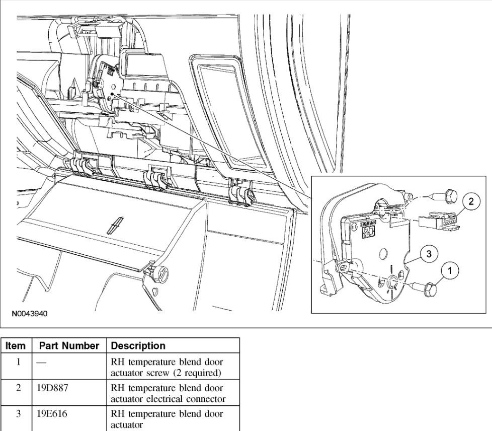

Right (Passenger's Side) Actuator
The right-side actuator is more challenging, as it's located behind the airbag module. Open the glove box for access. Remove the two bolts securing the airbag module to the dashboard. Carefully push up on the airbag module and hold it out of the way.
Remove the screws from the actuator. Install the new actuator and reverse the removal process to secure the airbag module and close the glove box.
