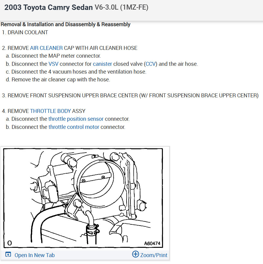

I'm just wondering if there is a special way of cleaning the TB? Does it have to be removed can I open the butterfly by hand? Does it require some type of relearn or calibration after cleaning? And say I didn't clean it the best would it cause the butterfly to stick? I have an unusually high RPM now only at a cold start and by that I mean no matter the temperature outside. So I'm thinking I didn't clean it good enough causing sticking or I screw up by cleaning it improperly. Please help and again only on cold start and no codes.

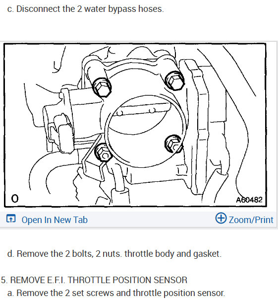

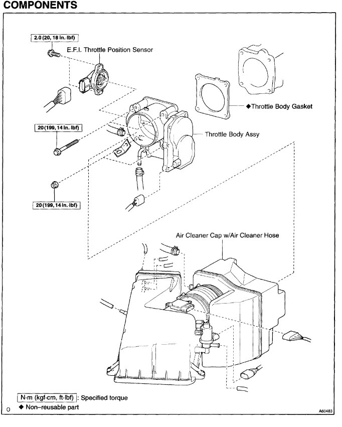

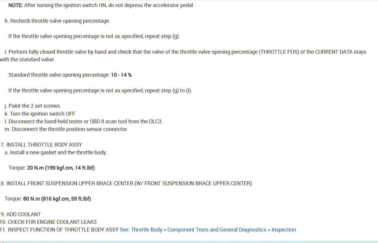

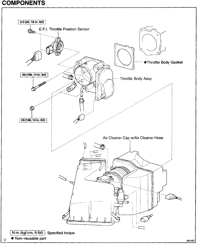

KEN L
  • MASTER CERTIFIED MECHANIC
  • 55,322 POSTS
Opps, you are correct, this car does not have an IAC. The best way to service the throttle body is to not move the butterfly, and leave the wires connected. Here is a guide that can help you with diagrams below to show you how on your car.
I don't think this throttle body needs a relearn, check the instructions below. Check out the images (below). Please let us know what happens.

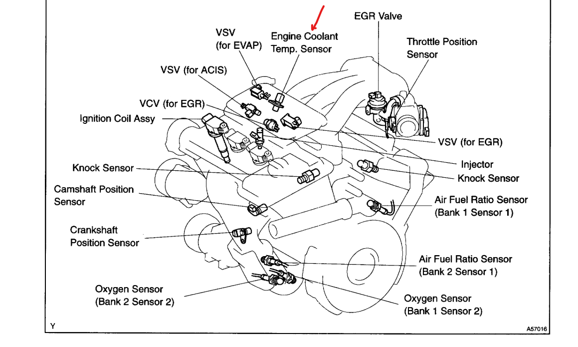

KEN L
  • 55,322 POSTS
Hmm, I have seen engine coolant sensors cause this issue, I would connect a scanner to see what the coolant sensor reading is to see if it is close to the outside temperature when the engine is cold. Here is the location of the sensor in case you need it. Check out the images (below). Please let us know what happens.
Sunday, November 24th, 2024 AT 11:11 AM
