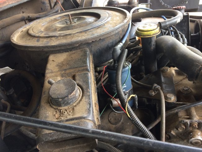

Other than the engine swap, what sorta engine/ electrical stuff ain't stock anymore?

I only have a test light at the moment but I will try to pick up a voltmeter tmrw. I did have a friend check it with a meter and I think it was 8 something which I think was in the correct range.
I have tried adding a little gas to the carb, and also made sure it was spraying gas when someone pumped the gas pedal.
As far a electrical changes I really do not know. I picked it up at a car sale years ago and never talked to the owner. I do know that the ignition control module that was on it cross referenced to the same as a 94 Cherokee.

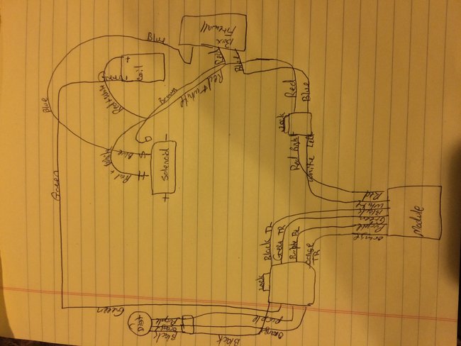

Your module should be exactly like this one, A Motorcraft or equivalently the same (this is a Motorcraft ignition system) I have no problem using a 'Clone' that looks the same
http://shop.advanceautoparts.com/p/bwd-ignition-control-module-cbe7p/5240484-P?searchTerm=ignition+module%2Fcontrol
4 wires into one connector
2 wires into the other
Where the wires exit the module, it should be BLUE PLASTIC (other colors are for other Ford applications)
Lemme know if this is what you have, lemme know if your wires go the same places as my previous diagram. It is a must! No cheating/ rigging something else. OOOPS! FORGOT THAT LATE ONE NIGHT! I'LL PUT IT BELOW! Disregard the 6 cylinder firewall part

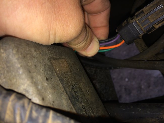

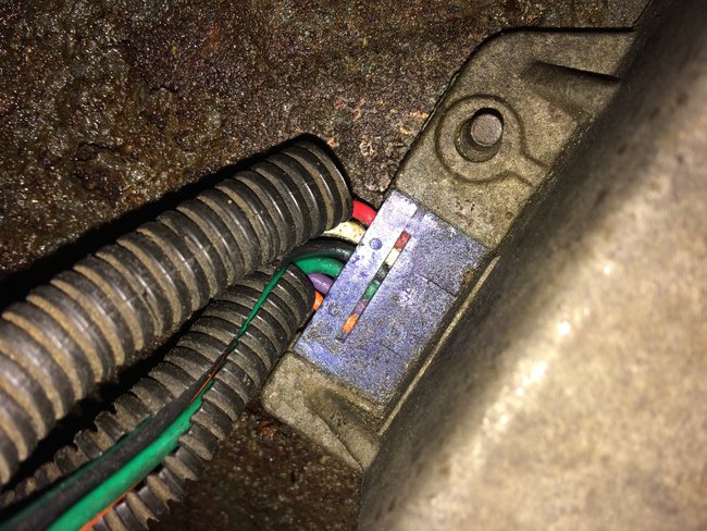

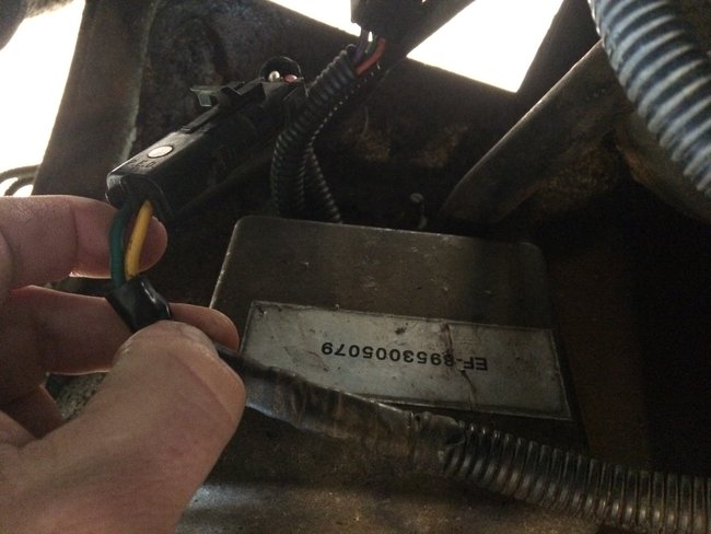

Yes sir the module looks similar other than the plugs. Here's a few pics.

Follow the wires
How 'bout your connector out of the module- Same number of wires as the module has?
Do they go to the EXACT same places as Mr. Diagram?
Gotta know- get your fingers dirty!

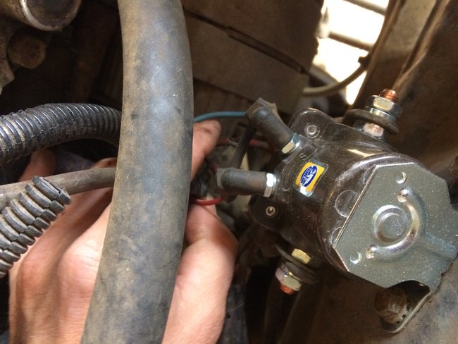

The wiring looks the same minus one extra brown wire added at the splice near the firewall. It runs to the solenoid and has a plug on it. It appears later someone spliced the red wire closer to the solenoid and no longer used the brown wire.

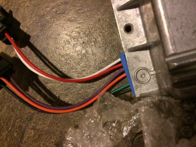

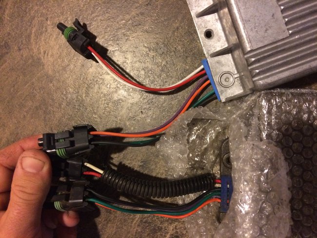

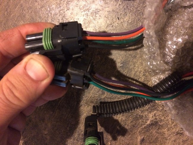

Also here are a few pics of the differences in the wire color positions on the module plug ins.

It ran with the old module.
As you demonstrated, with your pics, the wire colors are not going to the same positions on the connectors out of the module. (For instance, the black wire is a ground, at a different position, it is no longer a ground, it is now trying to be what the mate in the connector actually is. Does this make sense?)
I would look for a module just like the one you had originally, Brand may not matter, as long as the colors go to the same connector positions.
If it were doomsday, I might recommend cutting the wires and rearranging them (either at the module or at the mating connector, BUT IT'S NOT DOOMSDAY! This might make things more confusing in the future when another module is needed, or if you had to trace back in a future repair. NOT TO MENTION another poor soul at a shop trying to figger it all out! This would void returning the module to the parts store if you whacked up it's wires!
LET'S SEE IF YOU CAN FIND THE CORRECT MODULE!
Your drawing was nice, usually the other guy just tries to explain it, Having a diagram helps me the most, Thanks!

I just left napa and was told that I have the correct replacement module. He says that although the wire colors do not match at the plug that they would preform the correct function for the color wire on the jeep side of the plug. Dosent make sense to me but idk. Your thoughts?
Old motorcraft ef 8953005079
New napa tp28sb

Well after researching 87-93 jeep modules online, and a trip to advance auto I was not able to find another brand where the wire colors would not match up at the plug. I then went back to napa and asked again if he could confirm this was the correct wiring. This time he offered to check it with one he had on the shelf, which I had know idea he had in stock earlier. This one matched the the wiring of my original. I guess whoever wired the plug on the first one must have stayed out to late the night before.
Anyways I went home and plugged in the second module and we are back in business. It's a little frustrating that I spent unessary money and time all because of a faulty part but I'm glad she running again. It was also a lesson learned on my part that you can't always consider a new part good.
