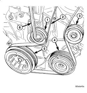

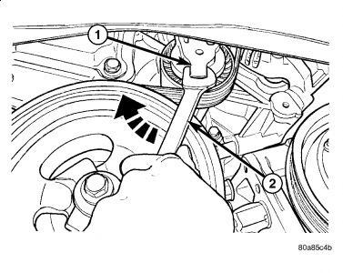

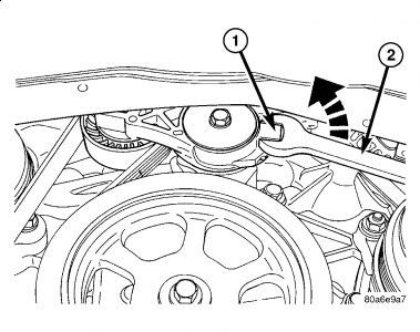

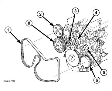

Replace serpentine belt?
2006 CHRYSLER TOWN AND COUNTRY
DDESERRE
i cant get the tensioner to loosen up how do i do that
Jan 30, 2010 at 3:12 PM
BMRFIXIT
  • 19,053 POSTS
https://images.2carpros.com/forum/automotive_pictures/99387_Graphic1_649.jpg
https://images.2carpros.com/forum/automotive_pictures/99387_Graphic2_306.jpg
Raise the vehicle on hoist remove tire and belt shield if still not able to get it to move tensioner is frozen and need to be replaced

The cost is usually around 60.00. You can get the belt yourself for around 15.00 and replace it. It isn't a big job. We have the belt routing diagrams if you get confused.

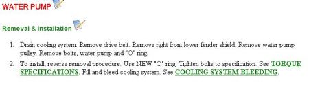

JOEL LEE
I need some direction on removing belt and water pump from my van.
Oct 18, 2020 at 5:14 AM (Merged)
ZACKMAN
  • 4,202 POSTS
It is very advisable that you invest $20 for a Chilton or Haynes manual for a complete instructions and photos. Our TSB is meant for technicians and only has the following plus torque spec.
