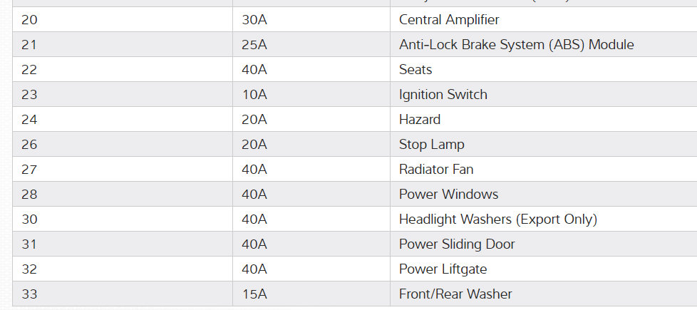

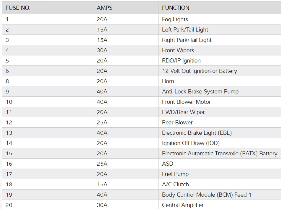

My radio stopped working out of the blue. The clock will stay on for a few seconds if I push the "time" button, but otherwise does not show. Also the cigarette lighter/charger outlet does not work.
Friday, September 12th, 2008 AT 12:45 PM
11 Replies
  • 110,194 POSTS
Hi.

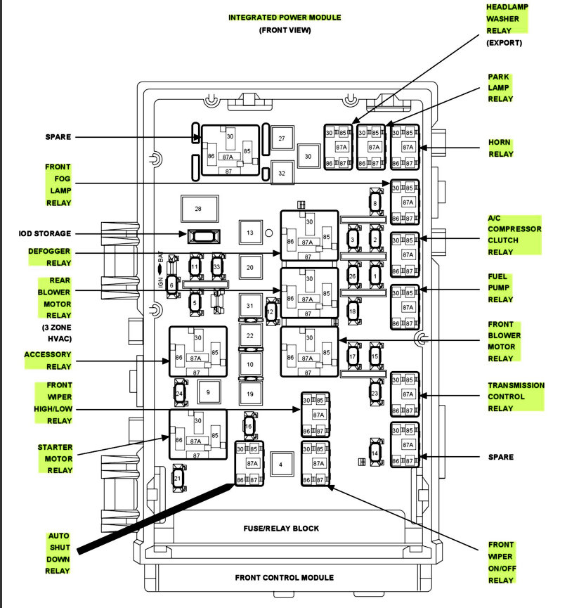

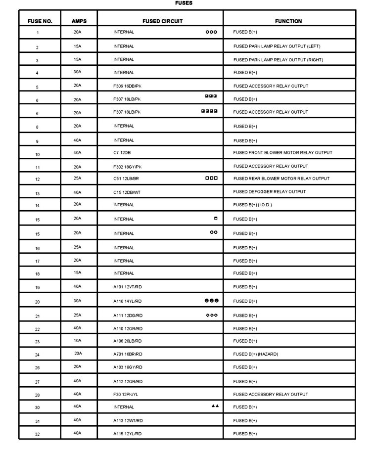

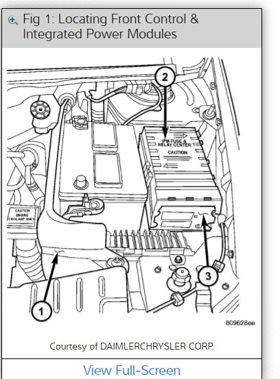

Here is a guide to help you check the fuses and the fuse locations for fuse # 14, 5 and 20 depending on which radio you have. Here are the radio wiring diagrams as well so you can see how the system works, below:
Cheers, Joe
+3
Monday, October 6th, 2008 AT 1:48 PM
ANNE FERNANDEZ
I have already looked at the owner's manual, but it does not say a thing about the fuses for the radio. It lists everything else in the car except the radio. We have looked under the hood and found the ones in the diagrams thanks! All fixed!

I was suffering the same problem. It is the fuse #20 :)
