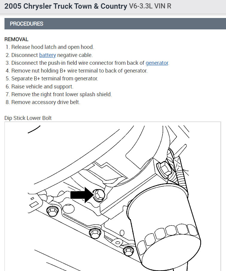

How to loosen the belt to change the alternator?

release belt tension by rotating the tensioner counterclockwise

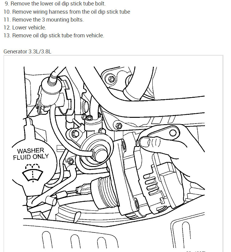

Here is how to change the alternator out in case you need it. Check out the images (below). Let us know if you need anything else.
