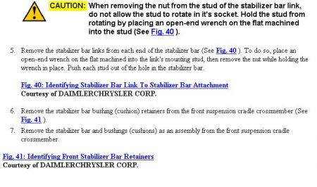

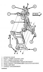

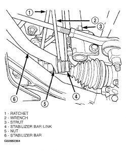

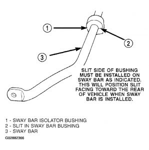

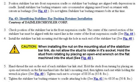

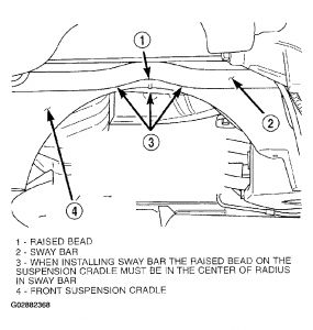

The right wheel is making some dull noise, especially on a rough patch of road. I want help on replacing the stabilizer bar

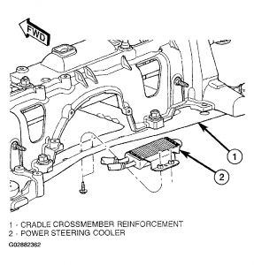

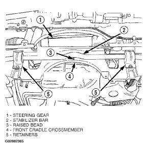

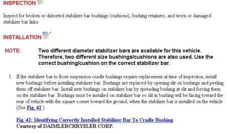

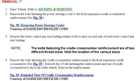

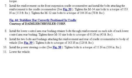

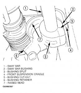

ZACKMAN
MECHANIC
4,202 POSTS
Thursday, January 29th, 2009 AT 9:37 PM
