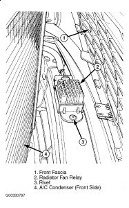

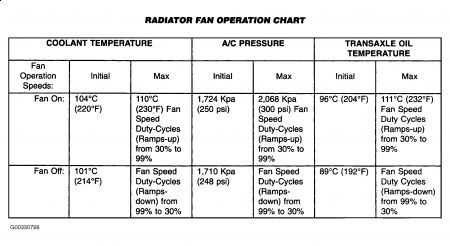

I noticed the radator fans were on while the vehicle was driving down the road. I was able to reset the computer and stop it by pulling off the negative battery cable. But the problem seems to have returned after a couple of weeks. The temperature gauge seems to be the same. What turns on the fans?

Three ways fan is turned on see chart

The relay maybe sticking closed see diagram
