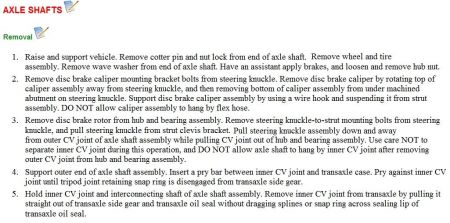

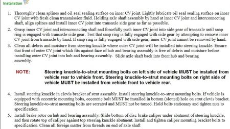

Please teach me how to replace the axel (driver side)
of my town and country
