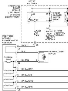

My blower motor recently started staying on full blast no matter what I do (even shut the power off on it) I've heard it's a resistor issue. Can you give me the part number and where it's located on the van?

Part # 4885583AC location in the HVAC beside blower motor

I've taken just about the whole right side of the under dash and can't find the resistor. What do you mean by "in the HVAC" and where exactly in the HVAC is the resistor?

did you find the Blower motor its right beside it
take the glove box
its behind it
maybe you should get the new one so you can see what does it look like
