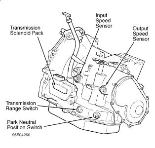

Hi. most likely your car needs new input and output sensors

Billy is correct most common is speed sensor best to find out is by getting the codes cycle key on off on off on read codes in odometer area (P0000,DONE) other possible is tranny solenoid pack good luck
