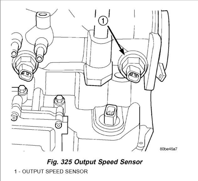

Odometer works but speed indicator does not. Have a replacement part for the output speed sensor. Where is it located?
Nov 14, 2009 at 9:24 AM
  • CAR REPAIR CONTRIBUTOR
  • 54,406 POSTS
There are two output speed sensors one is for the transmission and the other is for the computer. Here are both locations. (below)
https://images.2carpros.com/forum/automotive_pictures/188069_02tandcspeedsen_1.jpg
Larger images below Please use 2CarPros anytime, we are here to help. Please tell a friend. Cheers, Ken

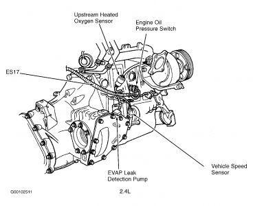

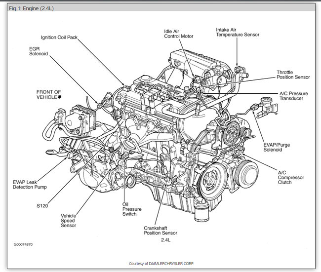

first do you kn ow what your looking for? have you went to a part store or looked online for a vss to see what to look for? second i will assume you have the LX model so this information will be for a lx, you can post back what you have so i can find a proper one but all three should be very similar. a 2.4l the sensor is located on the left rear of the engine. diagram below.
https://images.2carpros.com/forum/automotive_pictures/66751_Graphic1_1.jpg

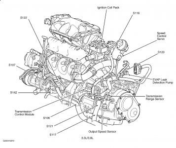

3.0l is on the left rear of the engine, see diagram bellow.
https://images.2carpros.com/forum/automotive_pictures/66751_Graphic2_1.jpg

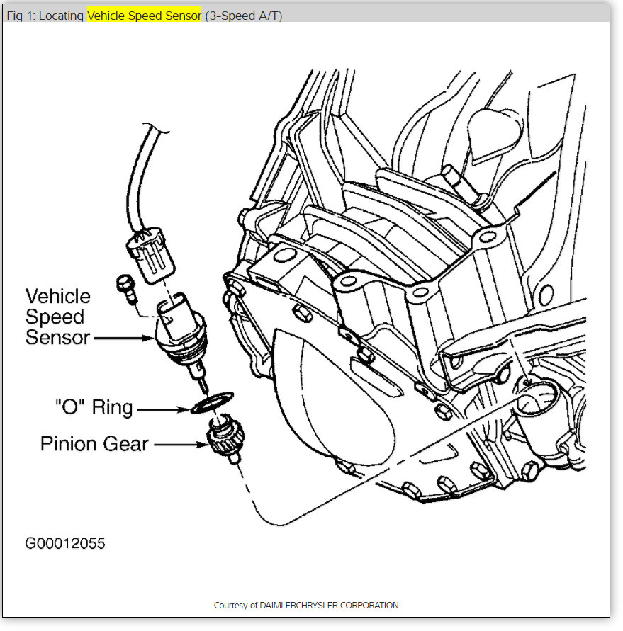

1997 Chrysler Town and Country 6 cyl Front Wheel Drive Automatic
im trying to locate the current vehicle speed sensor and transmission speed sensor. i have a 3 speed. i have a manual from autozone, but it only shows 4 speed
Oct 17, 2017 at 6:47 PM (Merged)
  • 110,193 POSTS
Hi:
If never heard of a three speed in a 1997. Is it possible someonw may have replaced the transmission with one from a different year?
