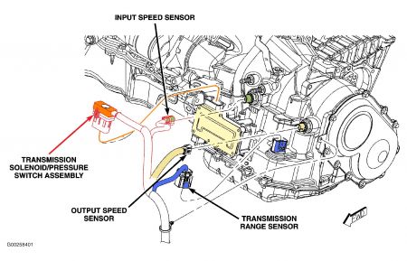

The needle is on the back side of the pin on the speedometer. It doesn't move at all. Does this sound like a speedometer cable needs replaced. Or is there a fuse (bad) or something that can affect the needle? Is this something that can be repaired easily without having to take it in to the shop?
Please advise...

do u have check engine light on ?
check for codes
very common speed sensors

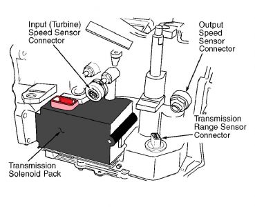

replace two speed sensors input and output
https://images.2carpros.com/forum/automotive_pictures/99387_caravan_tranny_05_5.jpg
https://images.2carpros.com/forum/automotive_pictures/99387_caravan_tranny_13.jpg
