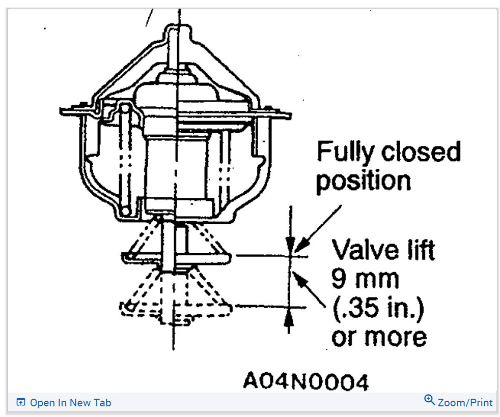

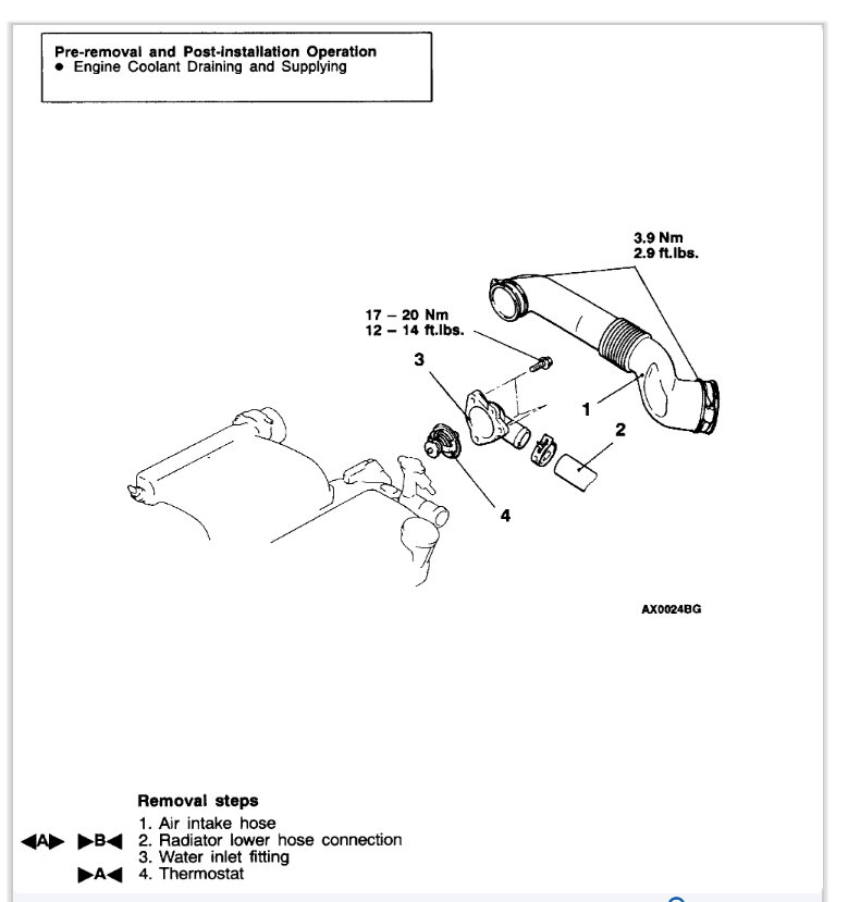

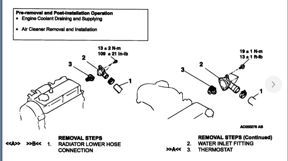

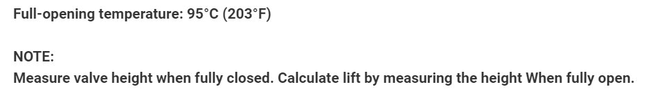

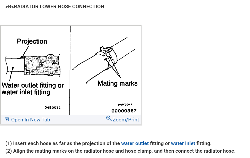

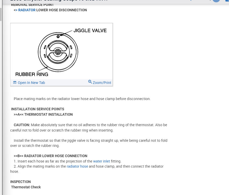

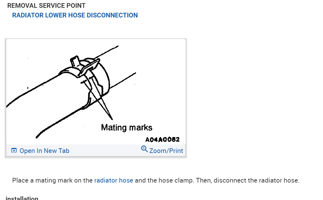

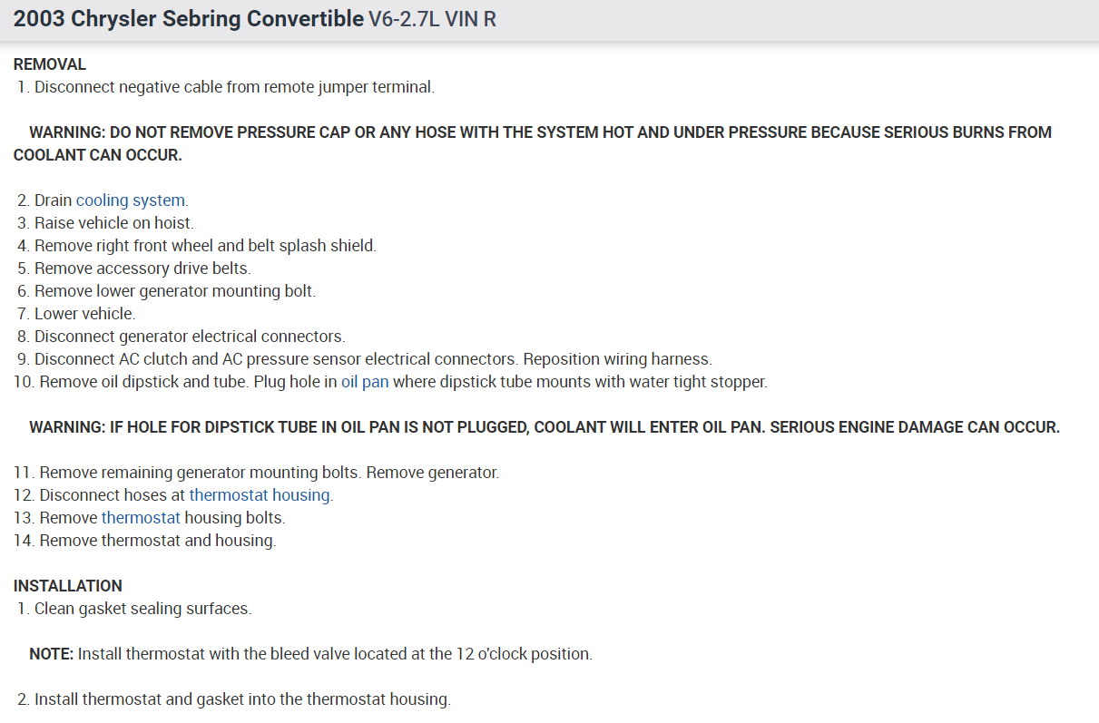

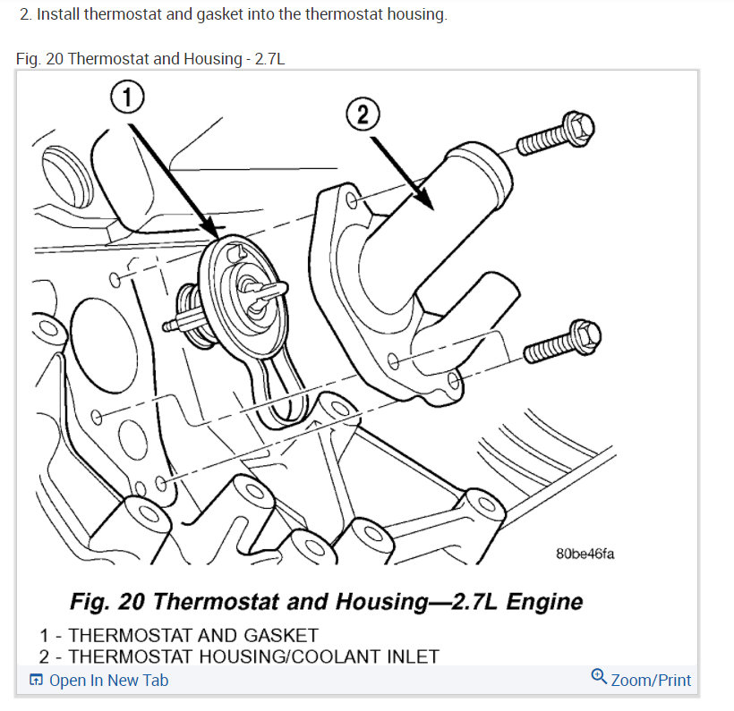

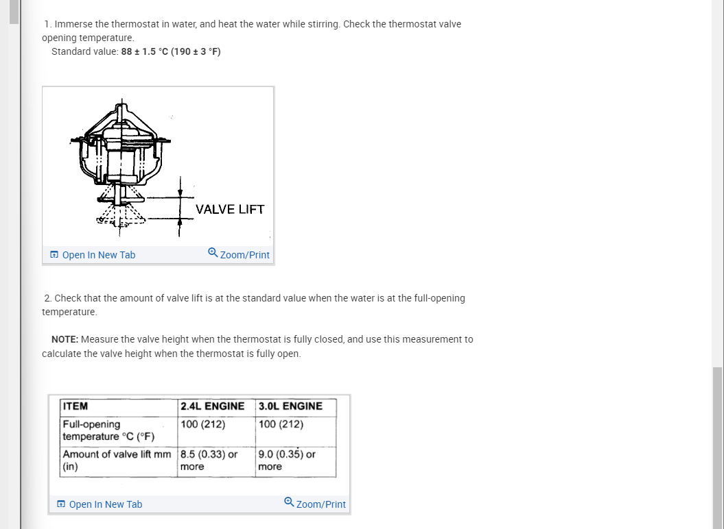

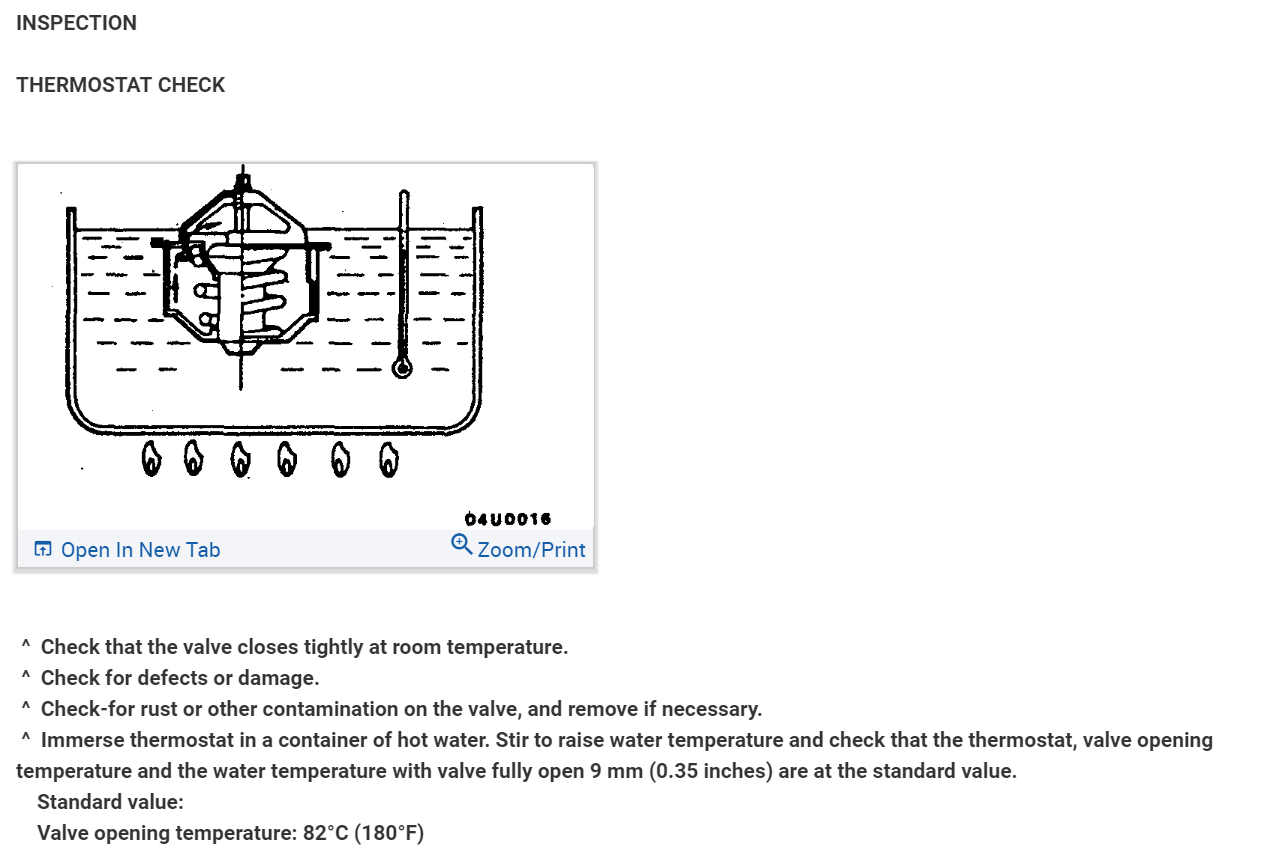

I will attached the info requested below but here is a guide that will help with useful info.
This guide is on a different vehicle but the process is the same. Clearly the location will be different on your vehicle.
Please run through this info below and let us know what other questions you have. I am attaching the info on the 2.7L and 3.0L depending on what engine you have.
Thanks

I have included step by step directions as well as diagrams for your vehicle in the diagrams below. I hope this helps you and let us know if there is anything we can do to help.

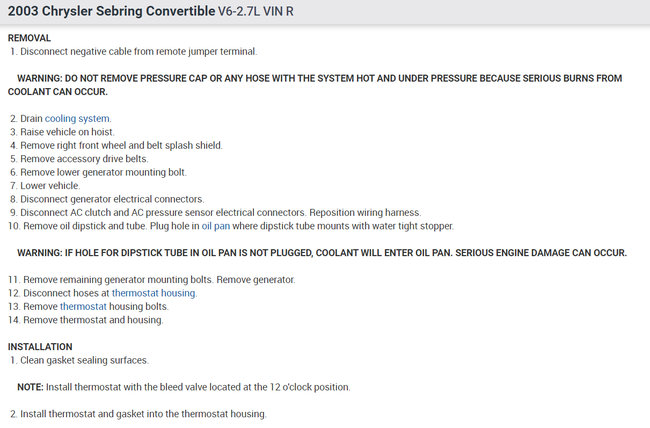

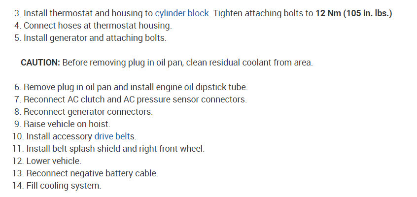

I have the 2.7 DOHC engine and have water bubbles coming out of the thermostat housing bolt. On this model do I have to pull the top plenum off the motor to get the thermostat out. One of the bolts is under the plenum. My Haynes manual says to pull the alternator out. It doesn't look like the picture they are showing. Thanks in advance.
Thursday, September 24th, 2020 AT 10:11 AM (Merged)
  • 75,992 POSTS

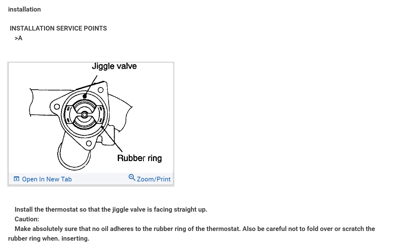

1. Raise the vehicle and place it securely on jackstands. Remove the right front wheel. Remove the accessory drivebelt splash shield.
2. Remove the accessory drivebelts.
3. Remove the lower alternator mounting bolt.
4. Lower the vehicle.
5. Disconnect the alternator electrical connectors.
6. Disconnect the electrical connectors from the air conditioning compressor.
7. Remove the oil dipstick and the dipstick tube. Plug the hole in the oil pan with a clean shop rag to prevent debris from entering the pan.
8. Remove the rest of the alternator mounting bolts and then remove the alternator.
9. Loosen the hose clamps and then disconnect the two hoses from the thermostat housing cover.
10. Remove the thermostat housing cover bolts and then remove the housing.
11. Note how the thermostat is installed, with the "jiggle valve" at the 12 o'clock position, and then remove the thermostat.
12. Remove all traces of sealant from the housing and coverr with a gasket scraper.
13. Install the thermostat housing cover and then tighten the bolts to the correct torque.
14. Reattach the hoses to the thermostat housing cover. Make sure that the hose clamps are still tight.
15. The remainder of the installation is the reverse of the removal.
16. When you're done, refill the cooling system.
17. Start the engine and allow it to reach normal operating temperature, then check for leaks and proper thermostat operation.

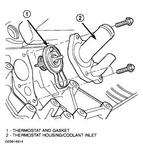

It is on the lower left side of the engine, near the front. It is in the inlet side of the water pump.
https://www.2carpros.com/forum/automotive_pictures/55316_27thermostat_1.jpg

The engine thermostat is located in the thermostat housing, located below the throttle body.
REMOVAL
Drain cooling system to the thermostat level or below.
Remove inlet hose and coolant elbow from thermostat housing.
Remove thermostat assembly, and clean sealing surfaces.
INSTALLATION
Install thermostat into the recess in the thermostat housing.
Install inlet elbow and tighten the bolts to 12 Nm (133 inch lbs ).
Fill cooling system.
