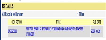

IMPALASS
  • 3,112 POSTS
Hey - one more thing. Also, it looks like you may have a recall on your vehicle. The dealer may fix this for free. Please contact the dealer service department, give them the VIN number of your car and have them check on this to see if it applies to you.
