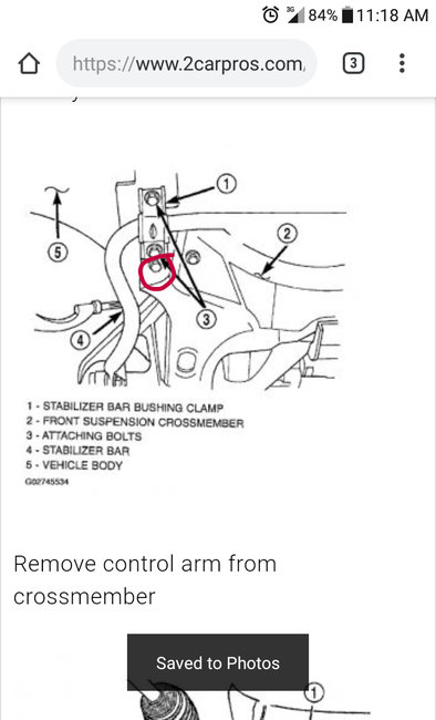

I am trying to remove the lower control arm (drivers) side and i am running into clearance problems with on one of the control bolts hitting the bottom end of the engine. I have pulled the front engine mount bolt and tried jacking the engine up but i am still need a 1/2 clearance to get the bolt out.
Suggestions ?

Have you removed stablizer
https://images.2carpros.com/forum/automotive_pictures/198357_Graphic_608.jpg
Remove control arm from crossmember
https://images.2carpros.com/forum/automotive_pictures/198357_Grafic_3_151.jpg
Then unbolt rear
https://images.2carpros.com/forum/automotive_pictures/198357_Grafic_4_36.jpg
is bolt 5 the one causing trouble? droping cross member will allow bolt to miss engine
Sep 8, 2010 at 10:32 AM
LRDAYE
Yes, bolt 5 is the problem...it is hitting the bottom of the transmission

Remove jack stand from crossmember remove bolt #2 in PIC 2 this will let crossmember to drop clearing trans.
Also may need to jack up trans use block of wood on jack saddle

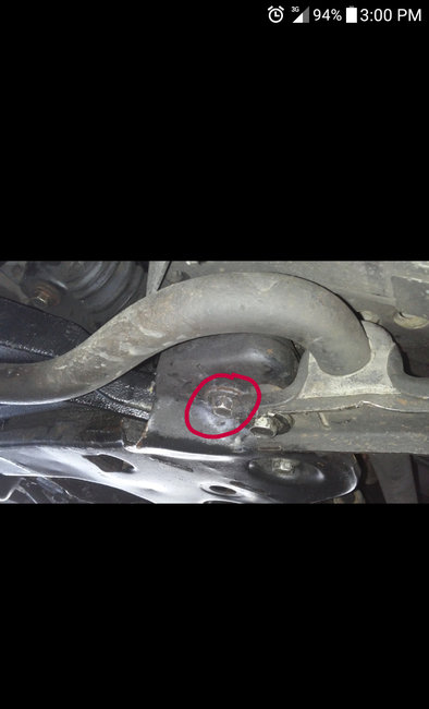

In the process of changing the driver's side lower control arm I ended up braking a bolt (to the body mount I think). I have looked everywhere and cannot find a way to the top of the bolt.

  • CAR REPAIR CONTRIBUTOR
Good morning.
Can you post a picture of the broken bolt so I can see what you see?
Are you sure it is not a cradle bolt?

I am at work right now, but I will send a picture in a couple hours. We broke the bolt loose but it just spins in the hole and when I try to tighten it down it tightens about half a turn and breaks loose again so I can only assume it is broken since I cannot see the top. Also, lately I have been hearing a small popping sound. Could just be a loose nut, but I do not think so

It sounds like the nut is spinning at the other end.
Yes, please send me a picture.

From what I have seen I am going to have to cut a hole in the floor board and possibly the sub-frame.
Aug 11, 2020 at 5:26 PM (Merged)
The nut is tac welded on top. The weld broke.
Yes, you need to open the floor to access the nut to remove the bolt. Make sure you cover the hole back up when you are done.
Also, replace the nut and bolt.

Is there a space in the subframe after I open the floor or do I need to cut a hole in the subframe too?
When you open the floor, the nut will be right there. No further cutting needed.
