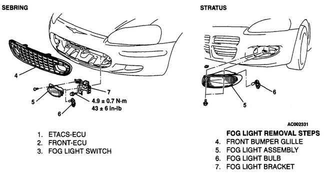

How to replace fog light bulb?

Lift and support vehicle to gain access to the underside of the front. Bulb should turn left to unlock, dont touch the new one with bare hands.

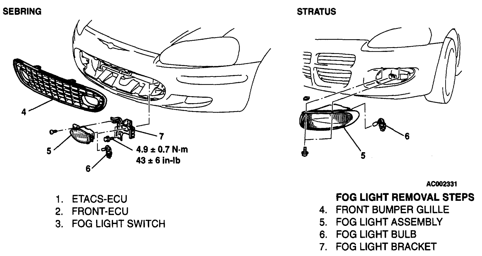

Here is how to replace the fog light for your 2001 CHRYSLER SEBRING. Check out the images (below). Let us know if you need anything else.
Image (Click to make bigger)
