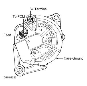

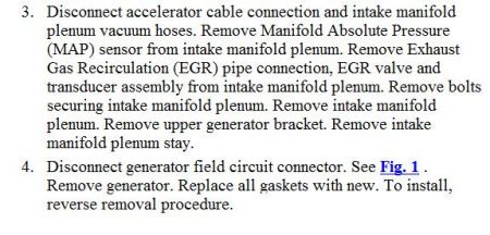

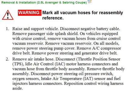

How do I change the alternator on 2.5 liter motor?
Does it come out the top or bottom?
Does the top trim cpwl need to come off?
Thanks
