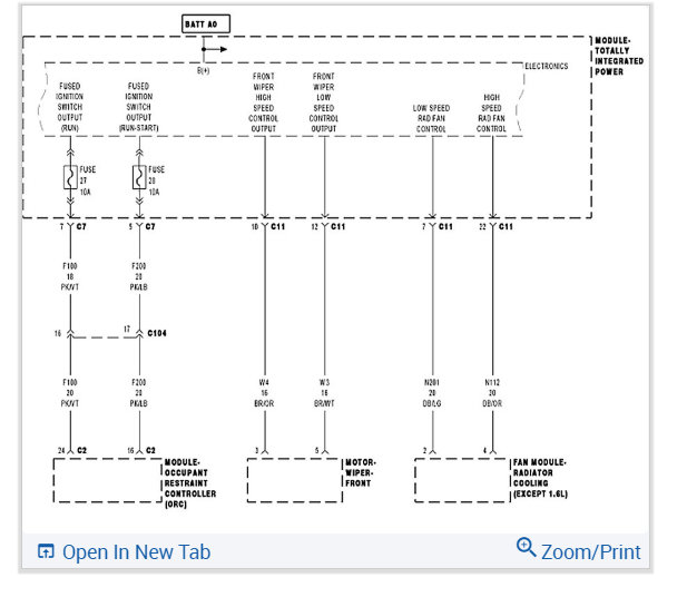

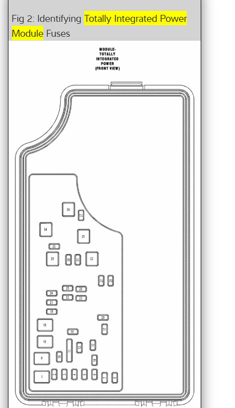

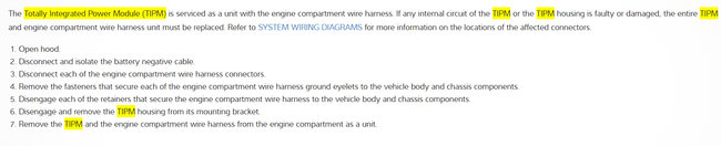

Can anybody tell me where I can locate the cooling fan relay since it is not located in the fuse box behind the battery?
Monday, June 22nd, 2009 AT 5:42 PM
17 Replies
KEN L
  • MASTER CERTIFIED MECHANIC
  • 55,488 POSTS

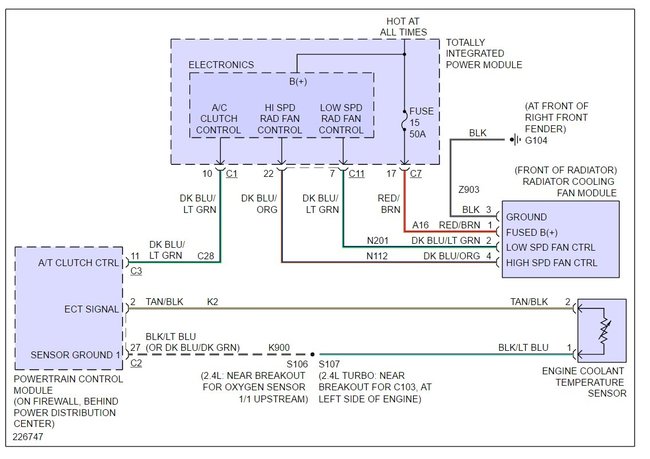

Editor's Note: This vehicle is not equipped with Cooling Fan Relays. The fan is controlled by the PCM via electronics integral to the Totally Integrated Power Module (TIPM).
The car does not have a cooling fan relay per say, it is a speed control module and TIPM located near the cooling fan down low. Here is a wiring diagram (below) along with a location diagram to help you change it, they had big problems with this part.
Here is a guide to help you do some testing:

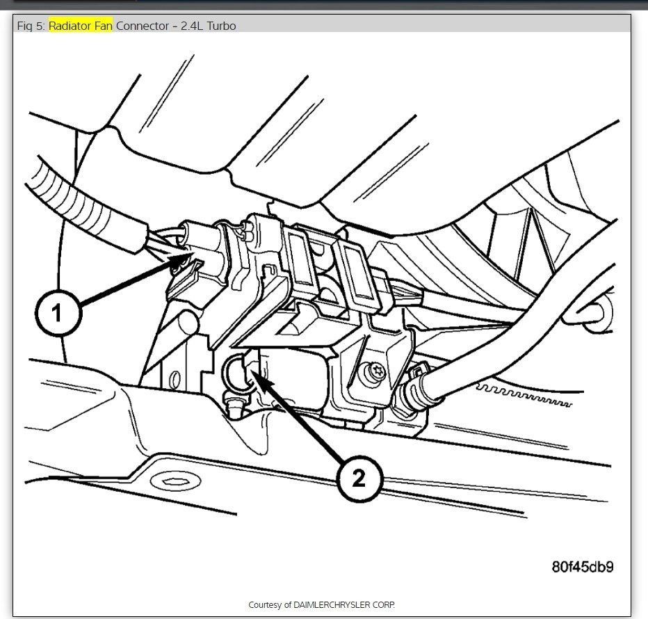

GUMSMACK
Sorry Ken, but your response is incorrect, I have an 2006 PT Cruiser and the relays are located on the fan housing itself, both the low and high speed relays are there and are the same identical part numbers. Hope this helps clear up any confusion. ;)

Hm, this is from AllData
Editor's Note: This vehicle is not equipped with Cooling Fan Relays. The fan is controlled by the PCM via electronics integral to the Totally Integrated Power Module (TIPM). For more information, please refer to:
See: Radiator Cooling Fan > Electrical
See: Power and Ground Distribution > Electrical > Integrated Power Module
Can you please shoot a quick video with your phone so we can see what's going on? That would be great. You can upload it here with your response.

These are not traditional relays in this video. These are solely for current switching. The control relay is in the TIPM.

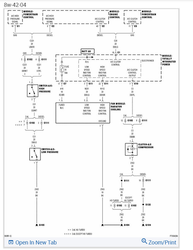

For what ever reason I cannot see to find where the issue is. I drove the car at high speeds and at low speeds, but the fuse did not blow. Is there a way I can get a copy of the wiring schematic for this car that deals with the fan and the relays as well as the ground schematic so I can check all the ground to ensure a ground is not coming loose.

The closest book I have is for an '01 Neon, and that shows just a basic, simple, reliable fan relay and motor with a 30 amp fuse. All that can be wrong there is a grounded wire or bad motor. My next suggestion is to click the link right below here for Mitchell Manuals. I have never been able to even get to he sign-in page without getting an error message so you might also go to:
http://randysrepairshop.net/index.html
then click on the AllData picture.
Either site will give you access to diagrams and repair procedures, but while you can own the manufacturers service manual forever, the online services also give you service bulletins, recall information, part numbers, and lots of other things like that. A five-year subscription for one car model costs about half of the Chrysler service manual and gives you much more information.

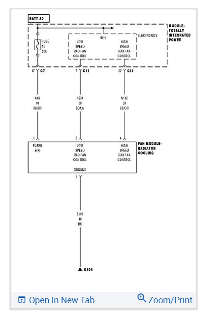

Yes, your vehicle do have a dual speed motor.
The common fault with Chrysler vehicles are faulty fan motors.
High and low speed are controlled by the PCM via a high and low speed relay.
To test the fan motor high speed circuit, apply battery voltage to the yellow wire anf if the fan does not work, it is faulty.

Sorry for not making myself clear.
You can jump without disconnecting the terminals. However shoudl you wish to disconnect the connector, then you would have to provide a ground for the Black wire.
Applying battery voltage to the Green wire would start the low speed operations and with battery voltage to both terminals would have the fan at high speed.
