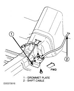

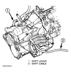

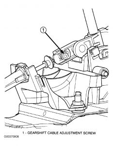

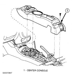

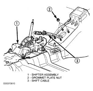

The shifter on the cruiser has been sticking badly (hard to shift between gears, feels gummy for lack of a better term). I drove it to work this morning and when I put it in park I heard a snapping noise and the car slipped out of gear. The engine will not turn over and when I try to shift between gears, the shifter moves without seeming to catch on anything. Transmission fluid levels are good, oil was changed 3000 miles ago.
What do I need to do?
Thursday, October 7th, 2010 AT 10:48 AM
BMRFIXIT
  • 19,053 POSTS

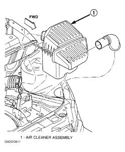

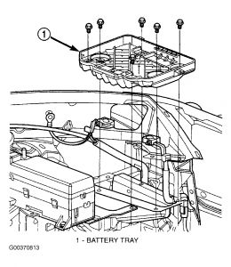

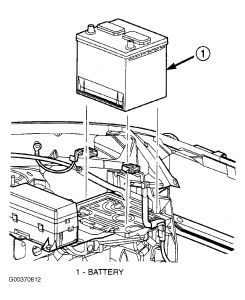

Need a new shifter cable which just pops on the shifter levers.
