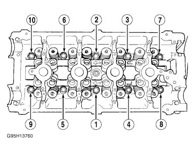

I am just wondering ho many pounds of pressure do I have to put on the cylindar head with the torque?

Cylinder head bolts torque in 4 steps.
step 1 : 25 Ft. Lbs.
step 2 : 50 Ft. Lbs.
step 3 : 50 Ft. Lbs. again
step 4 : tighten additional 1/4 turn with regular ratchet
Make sure to follow sequence below when tightening
