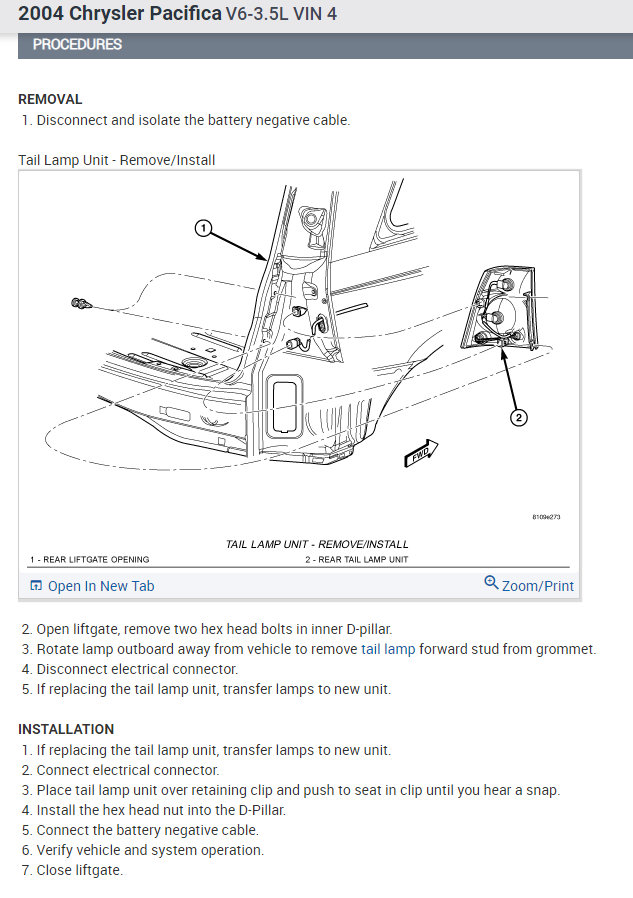

How do I access the rear light assembly to replace a brake light bulb? I removed the two bolts inside the rear hatch but it seems to still not want to come out?
Mike
Feb 1, 2009 at 12:02 PM
SQM
  • CAR REPAIR CONTRIBUTOR
  • 6,383 POSTS
To remove the taillamp assembly follow this procedure:
Open liftgate, remove two hex head bolts in inner D-pillar.
Rotate the lamp assembly away from the vehicle.
This will release the stud that goes into a grommet on the front side of the lamp.
Some times you will have to use good bit of force to get that stud out of the grommet.
