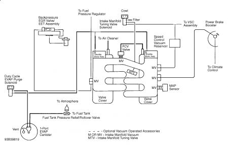

Sometimes in the morning when first starting the car we get a gas smell from the air and heating ducts and last for about 10 to 15 minutes then the smell goes away for the rest of the day. I have had it looked at several times and nothing can be found. It will happen for a few days then might not happen for a week or so.

Hi
Does smell come about after a fill up?

It does not matter if the tank is full or not.

Is car garaged? if yes is gas stored for lawn mower? see diagram find EVAP Canister does it have gas odor?

I park in the garage. There are no cans of gas around. The EVAP Canister has no gas in it.

Next time it happens open hood look at all injectors for fuel. Don't know what is happening

I cleaned the engine compartment. The next day I started it and got the smell. I checked all injecters and looked for any leaks. Nothing that I can see.

Is it possible the smell is antifreeze? Or raw gas? Or exhaust?

It smells like gas fumes. It's not coolant or exhaust and it comes out the air conditioning ducts.
