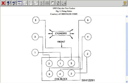

Firing order is 123456, but which is #1 cyclinder?
Saturday, December 29th, 2007 AT 1:27 PM
MECHANIC
75,992 POSTS
See below
