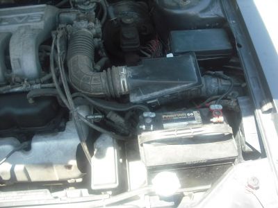

https://www.2carpros.com/forum/automotive_pictures/551300_Chrysler_engine_picture_3p3_1.jpg
the trans sleeps here.

I only use the DRB3 because it does everything possible on Chrysler products and with a plug-in card, it does emissions-related stuff on all brands of cars after 1996. There are a lot of good aftermarket scanners that I'm not real familiar with, but they are always playing catchup. Most will read codes now but they might not be able to do actuator tests.
The transmissions have been getting better over the years so now the two speed sensors are responsible for a bigger percentage of problems.

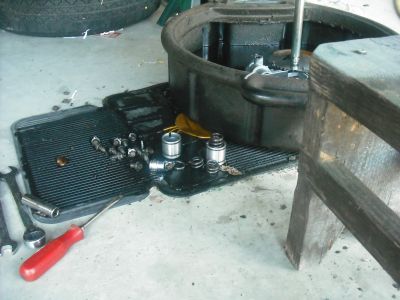

I got around to take off the transmission pan and remove the valve body and found out that one of the accumulator springs was broken in three!
Would that make the transmission go into first and right away drop into neutral (with lever still in drive)?
the shift kit I found out includes these parts found Shift Kits - by TransGo No YoYo T92165 at northern auto parts.com ( I also noticed they have raised their price according to other posts )
*Also made a great find on the internet the disassembly manual of 4shared.com (search for a604) Helped out a ton!
https://www.2carpros.com/forum/automotive_pictures/551300_Accumulator_Spring_in_pieces_1.jpg
