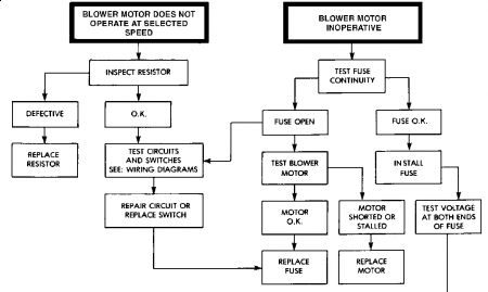

Ac went out. Local repair shop had me replace my blower motor, resistor, fuses and switch; and after all that -still NO AC. They said they dont know what else it could be and sent me on my way. Now im back to square one roasting to death in my car. Pleeeease help. What else is left for me to replace/check? I turn the AC switch on and theres no sound except for the defrost button -when pushed, makes a sound like air pressure being released, or gas escaping. Don't know what could be wrong and would appreciate any advice in helping me to diagnose the problem.

Is the problem the blower motor not working? If the switch hasnt been checked do that,here's the flowchart.
https://www.2carpros.com/forum/automotive_pictures/62217_leba_2.jpg
https://www.2carpros.com/forum/automotive_pictures/62217_lebb_2.jpg
