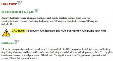

I need help to find out where the fuel pump is and is it easy to remove if i dont know how to do it. I need to put in a new on ei just bought

fuel pump is located inside of fuel tank. you should have an access panel in the trunk, underneath the liner. remove the panel and disconnect wiring and fuel hoses. remove the hose from rollover valve. loosen fuel pump band clamp and remove pump.

I was told it was right buy the tire just take the tire off and it right there buy fuel tank

which model of Le Baron is your vehicle.?

But i believe its a lx. i no its a 3.0 v6
