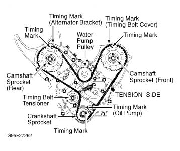

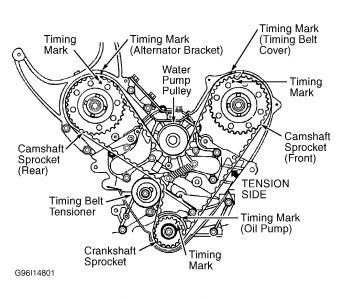

im trying to figure out what the timing is for my car

This is the timing marks u need for or when replacing the timing belt
good luck
