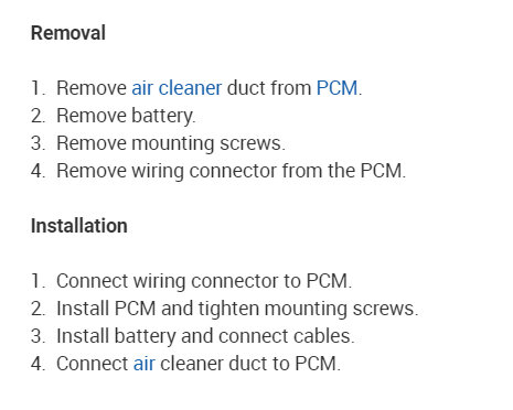

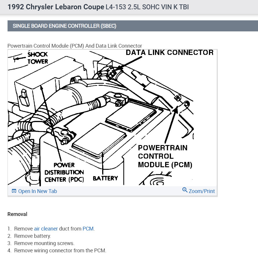

  • CAR REPAIR CONTRIBUTOR
  • 54,328 POSTS
I believe the PCM replacement fixed it, which was a big problem with this car, you can get a rebuilt unit by searching Google or Ebay. Here is the location in the images below.
