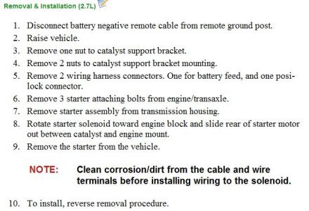

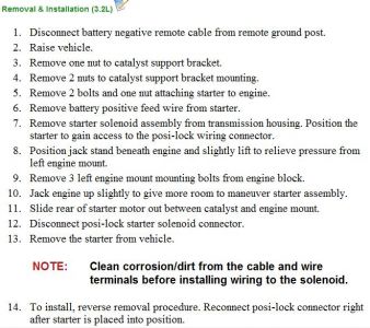

I got the starter loose, but can't get the starter out of the engine cavity. Do I need to loosen the engine mounts and jack the engine up to get it out. Please help!

https://www.2carpros.com/forum/automotive_pictures/55316_98concordestarter27_1.jpg
https://www.2carpros.com/forum/automotive_pictures/55316_98concordestarter32_1.jpg
