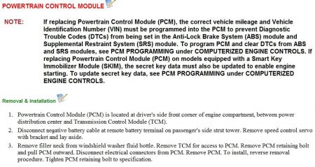

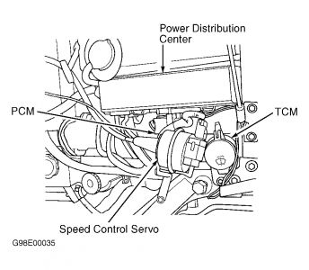

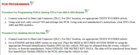

Computer problem
1998 Chrysler Concorde 6 cyl Automatic
Does anyone know where I can get the instructions on removing and replacing the PCM on my 1998 Chrysler Concorde?
Tuesday, September 28th, 2010 AT 11:30 AM
BLUELIGHTNIN6
MECHANIC
16,542 POSTS
Tuesday, September 28th, 2010 AT 2:47 PM
